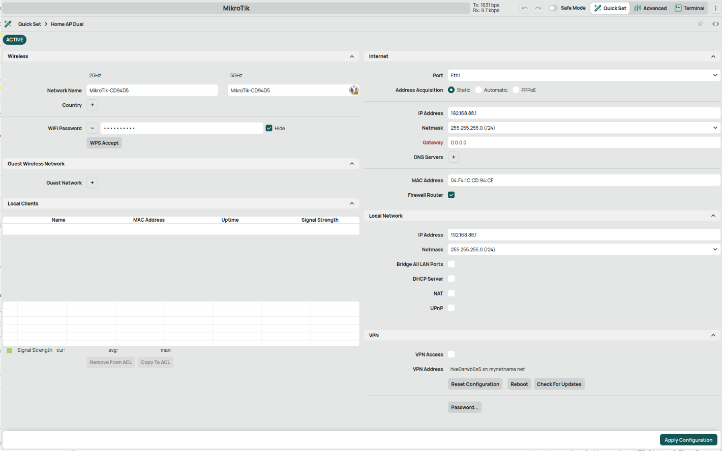

HomeAP
This is the mode you should use if you would like to quickly configure a home access point.
Wireless
Set up your wireless network in this section:
  • Network Name: How will your smartphone see your network? Set any name you like here. In HomeAP dual, you can set the 2GHz (legacy) and 5GHz (modern) networks to the same, or different names (see FAQ). Use any name you like, in any format.
  • Frequency: Normally you can leave "Auto", in this way, the router will scan the environment, and select the least occupied frequency channel (it will do this once). Use a custom selection if you need to experiment.
  • Band: Normally leave this to defaults (2GHz b/g/n and 5GHz A/N/AC).
  • Use Access List (ACL): Enable this if you would like to restrict who can connect to your AP, based on the user's MAC (hardware) address. To use this option, first you need to allow these clients to connect, and then use the button below "Copy to ACL". This will copy the selected client to the access list. After you have built an Access list (ACL), you can enable this option to forbid anyone else to attempt connections to your device. Normally you can leave this alone, as the Wireless password already provides the needed restrictions.
  • WiFi Password: The most important option here. Sets a secure password that also encrypts your wireless communications, which will be needed to connect to the wireless network.
  • WPS accept: Use this button to grant access to a specific device that supports the WPS connection mode. Useful for printers and other peripherals where typing a password is difficult. First start WPS mode in your client device, then click the WPS button once here to allow said device. The button works for a few seconds and operates on a per-client basis.
  • Guest network: Useful for house guests who don't need to know your main WiFi password. Set a separate password for them in this option. Important! Guest users will not be able to access other devices in your LAN and other guest devices. This mode enables Bridge filters to prevent this.
  • Wireless clients: This table shows the currently connected client devices (their MAC address, if they are in your Access List, their last used IP address, how long they are connected, their signal level in dBm and in a bar graph).
Internet
  • Port: Select which port is connected to the ISP (internet) modem. Usually Eth1.
  • Address Acquisition: Select how the ISP is giving you the IP address. Ask your service provider about this and the other options (IP address, Netmask, Gateway).
  • MAC address: Normally should not be changed, unless your ISP has locked you to a specific MAC address, and you have changed the router to a new one.
  • Firewall router: This enables a secure firewall for your router and your network. Always make sure this box is selected, so that no access is possible to your devices from the internet port.
  • MAC server / MAC Winbox: Allows connection with the Winbox utility from the LAN port side in MAC address mode. Useful for debugging and recovery, when IP mode is not available. Advanced use only.
  • Discovery: Allows the device to be identified by model name from other RouterOS devices.
Local Network
  • IP address: Mostly can stay at the default 192.168.88.1 unless your router is behind another router. To avoid an IP conflict, change to 192.168.89.1 or similar.
  • Netmask: In most situations you can leave 255.255.255.0.
  • Bridge all LAN ports: Allows your devices to communicate with each other, even if, say, your TV is connected via Ethernet LAN cable, but your PC is connected via WiFi.
  • DHCP server: Normally, you would want automatic IP address configuration in your home network, so leave the DHCP settings ON and on their defaults.
  • NAT: Turn this off ONLY if your ISP has provided a public IP address for both the router and the local network. If not, leave NAT on.
  • UPnP: This option enables automatic port forwarding ("opening ports to the local network" as some call it) for supported programs and devices, like your NAS disks and peer-to-peer utilities. Use with care, as this option can sometimes expose internal devices to the internet without your knowledge. Enable only if specifically needed.
VPN
If you want to access your local network (and your router) from the internet, use a secure VPN tunnel. This option gives you a domain name to connect to, and enables PPTP and L2TP/IPsec (the second one is recommended). The username is 'vpn' and you can specify your own password. All you need to do is enable it here, and then provide the address, username and password on your laptop or phone, and when connected to the VPN, you will have a securely encrypted connection to your home network. It is also useful when travelling - you will be able to browse the internet through a secure line, as if connecting from your home. This also helps to avoid geographical restrictions that are set up in some countries.

QuickSet interface:
Screenshot from 2026-04-28 11-14-11.png)
