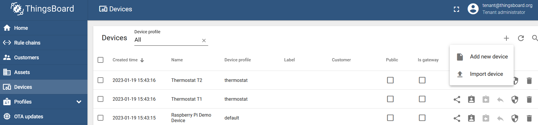

Create a new device by clicking on the add button "+" and "Add new device":

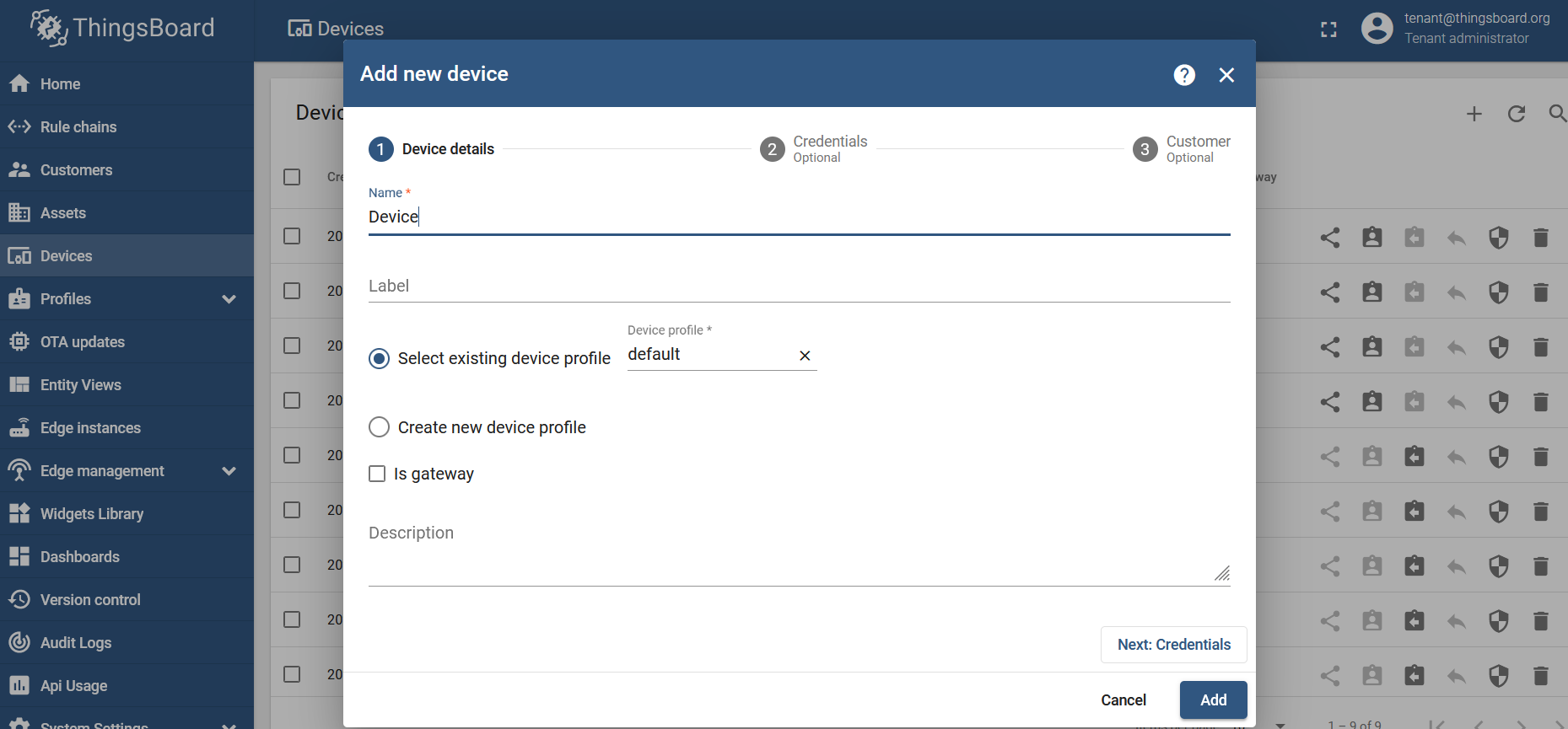

Enter the name of the device and click on "Add":

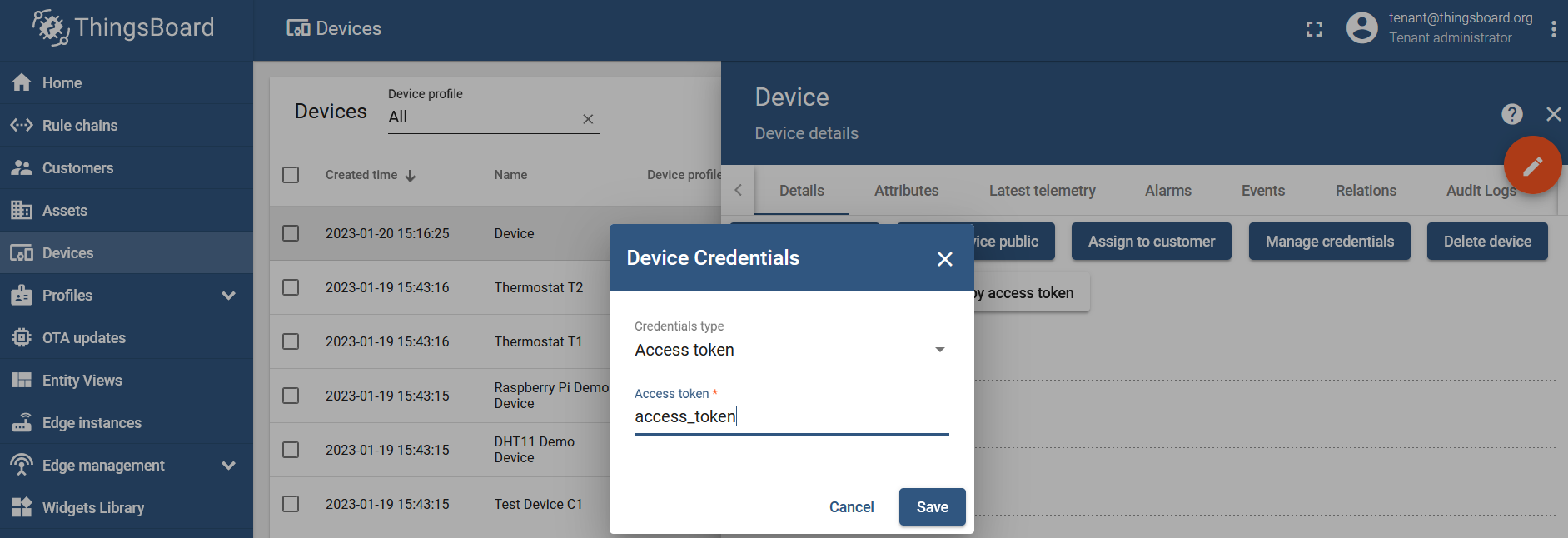

Access token scenario
You can change the token by clicking on the created device and entering the "Manage Credentials" settings (in the "Details" section):
This token will be used as a "username" for the MQTT publisher (in RouterOS settings).
You can find more information by following the link.

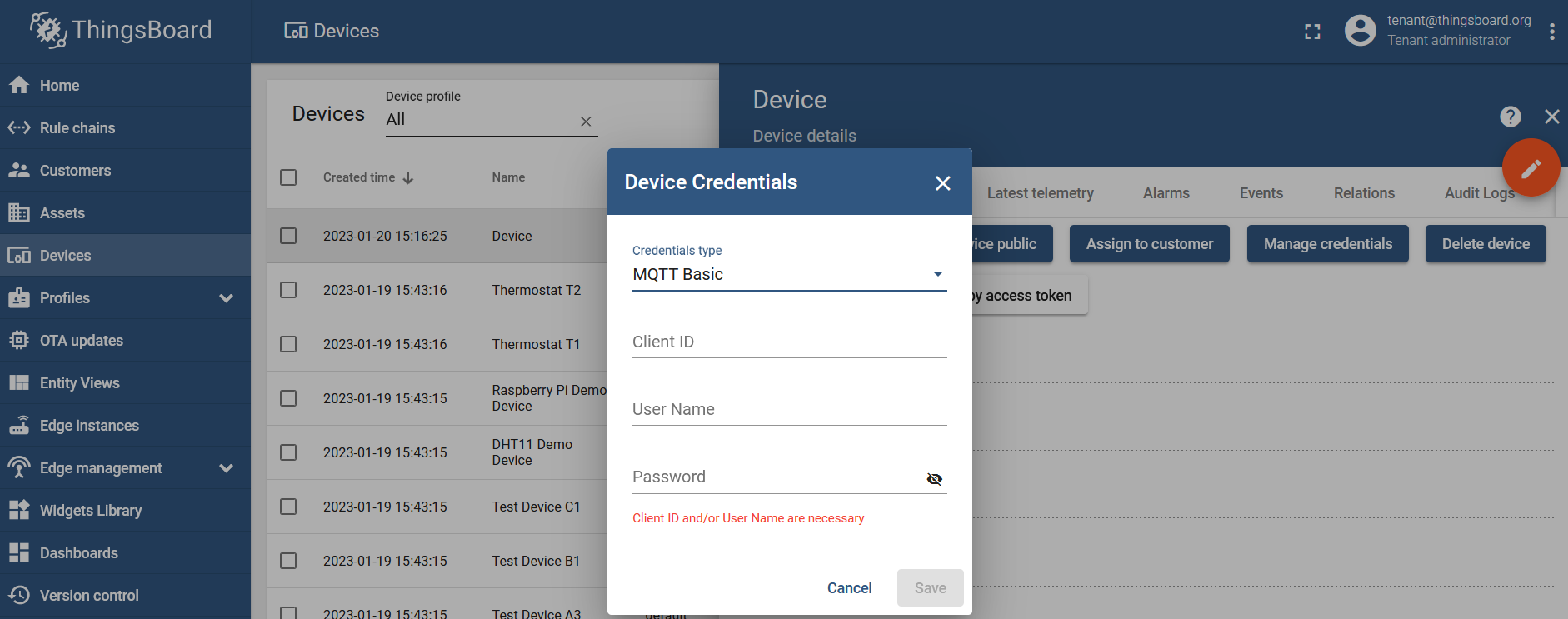

MQTT Basic scenario
You can change the credentials type in the "Device Credentials" section for the specific device:
MQTT Basic scenario allows you to specify the Client ID, Username, and Password for the MQTT authentication.

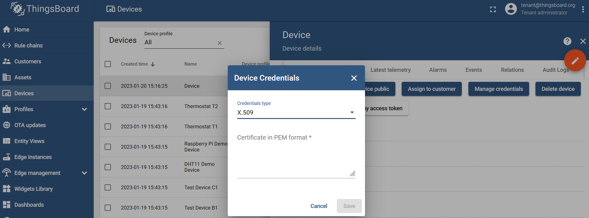

X.509 scenario uses a client certificate for authentication.
Once the certificate is generated (for example, using OpenSSL), copy the RSA public key into the field and click on the "Save" button.

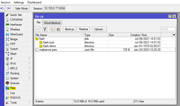

Drag and drop the server certificate that was installed into ThingsBoard, into the router's "File List" menu:
Import server certificate:

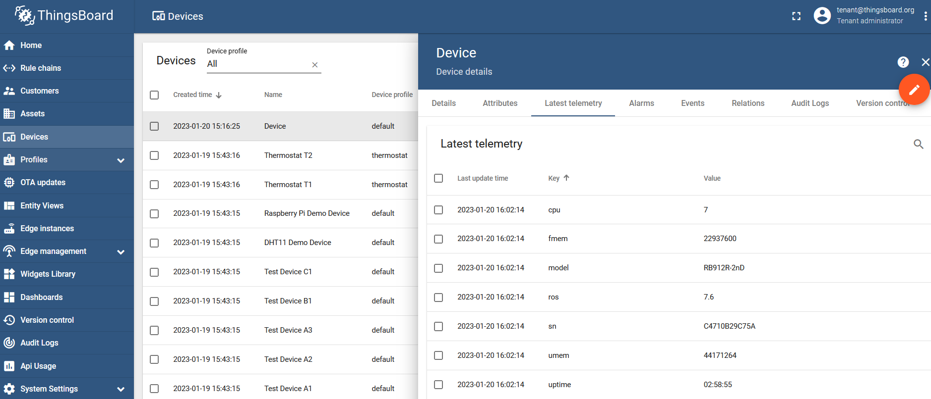

Verification
You can check the received/published data for the device under the "Latest telemetry" section:
