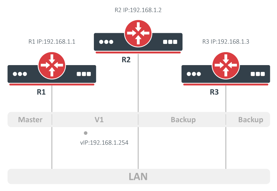

Virtual Router (VR)
A Virtual Router (VR) consists of one Owner router and one or more backup routers belonging to the same network.
VR includes:
  • VRID is configured on each VRRP router.
  • The same virtual IP is configured on each router.
  • Owner and Backup are configured on each router. On a given VR there can be only one Owner.

A master router in a VR operates as the physical gateway for the network for which it is configured. The selection of the Master is controlled by priority value. The Master state describes the behavior of the Master router. In the example network, R1 is the Master router. When R1 is no longer available R2 becomes master.
Backup
VR must contain at least one Backup router. A backup router must be configured with the same virtual IP as the Master for that VR. The default priority for Backup routers is 100. When the current master router is no longer available, a backup router with the highest priority will become a current master. Every time a router with higher priority becomes available it is switched to master. Sometimes this behavior is not necessary. To override it preemption mode should be disabled.
Virtual Address
The Virtual IP associated with VR must be identical and set on all VR nodes. All virtual and real addresses should be from the same network.
