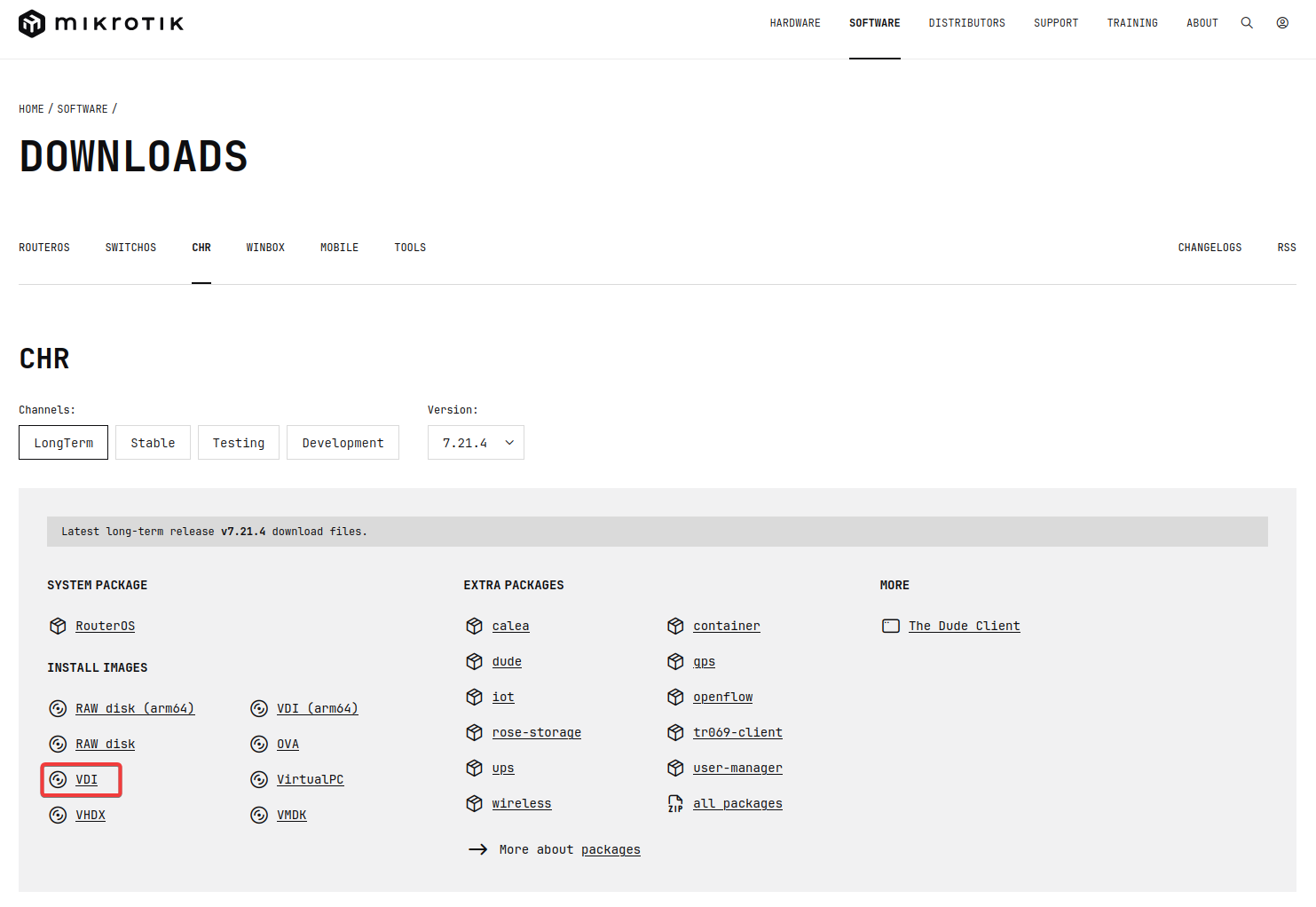

  2. Download CHR disk image
    Download and extract the latest Long-Term, Stable, or Testing version of the Cloud Hosted Router (CHR) VDI image from the MikroTik download page.

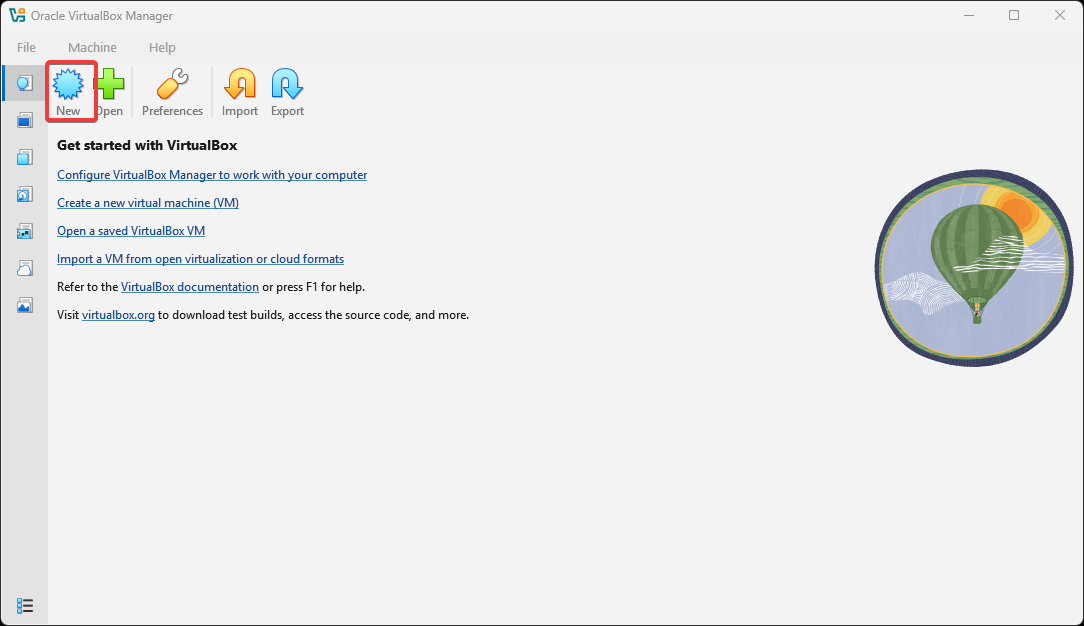

Step 1: Create a New Virtual Machine
  • Launch VirtualBox.
  • Click New to create a new virtual machine.

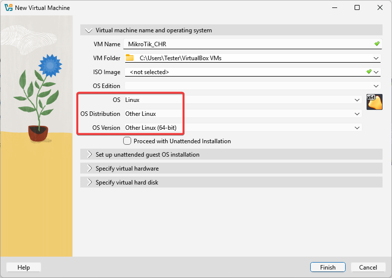

Name and Operating System
  • Name: Enter a VM name (e.g., MikroTik_CHR)
  • Type: Linux
  • Version: Other Linux (64-bit)

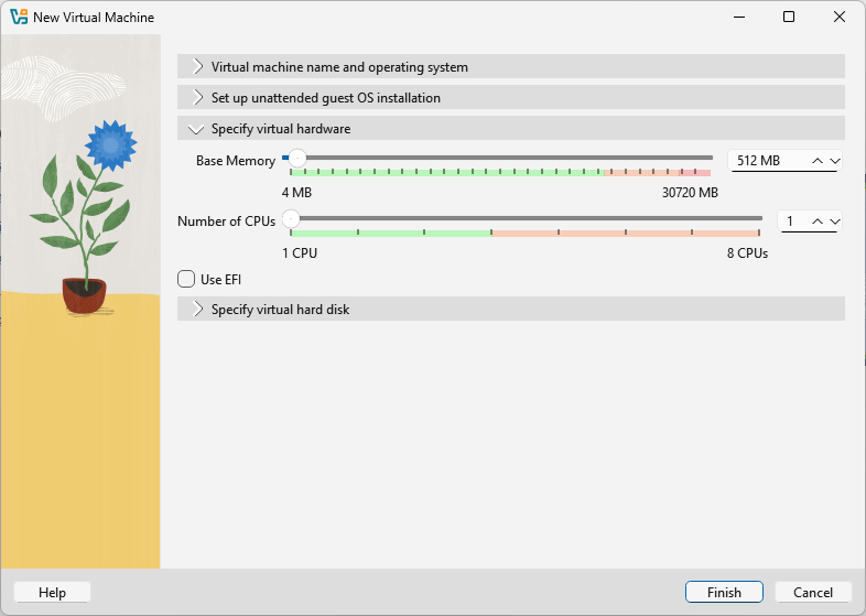

Step 2: Configure Memory Size
  • Allocate at least 256 MB RAM (RouterOS 7.15.1+ recommendation)
  • Assign the desired number of CPUs

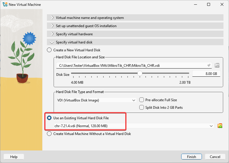

Step 3: Add a Virtual Hard Disk
  • Select Use an Existing Virtual Hard Disk File
  • Choose the downloaded .vdi image
Click Finish to create the VM.

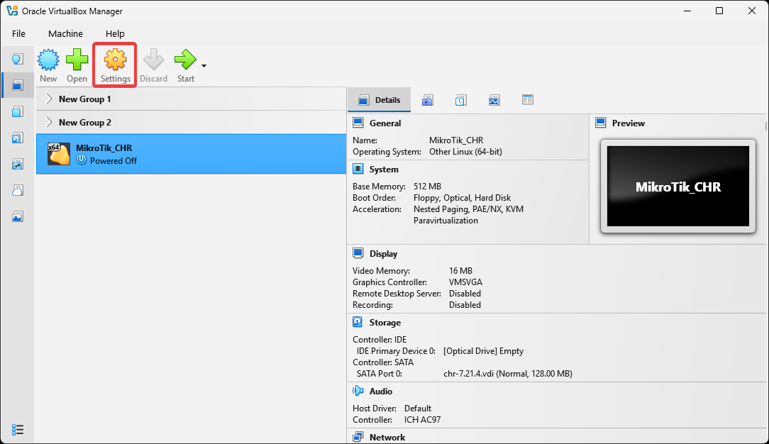

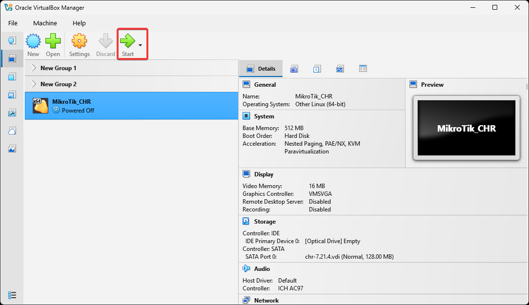

Step 4: Configure Virtual Machine Settings
Select the VM → click Settings

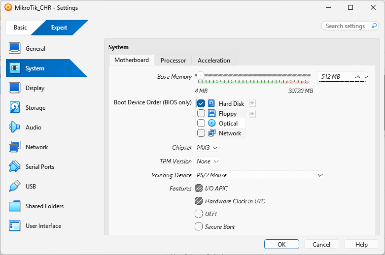

System
  • Disable Floppy and Optical from boot order
Processor
  • Set the desired number of CPUs

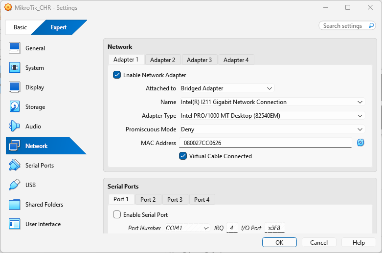

Network
  • Adapter 1:
    • Enable network adapter
    • Attach to Bridged Adapter or NAT (depending on your setup)

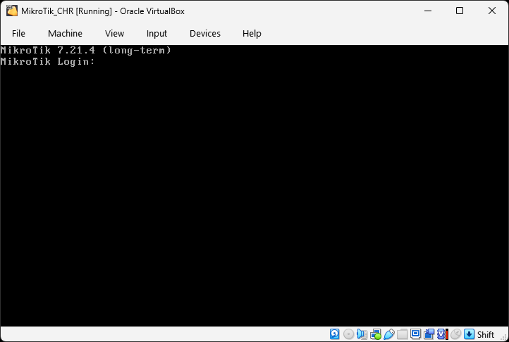

Step 5: Start the Virtual Machine
  • Click Start to boot the VM
  • Login credentials:
    • Username: admin
    • Password: (empty, set immediately after first login)

Supported Network and Disk Interfaces
Network Adapters
  • E1000
  • RTL8139
Disk Controllers
  • IDE
Warning: Avoid using the E1000 network adapter unless no better synthetic or paravirtualized option is available. Paravirtualized adapters generally provide better performance on supported hypervisors.
