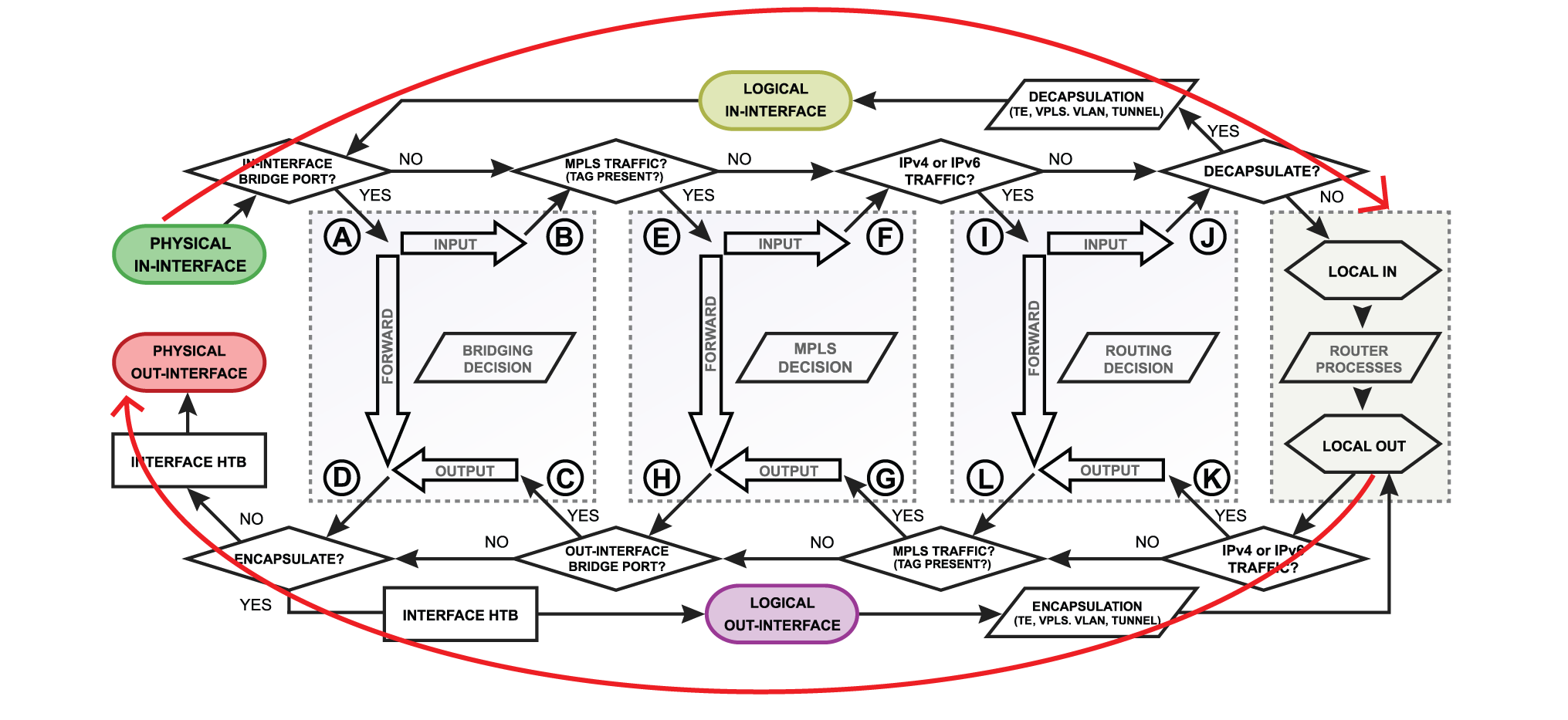

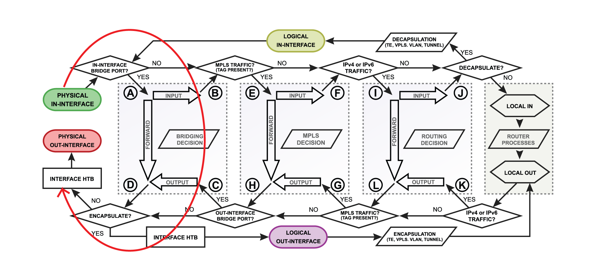

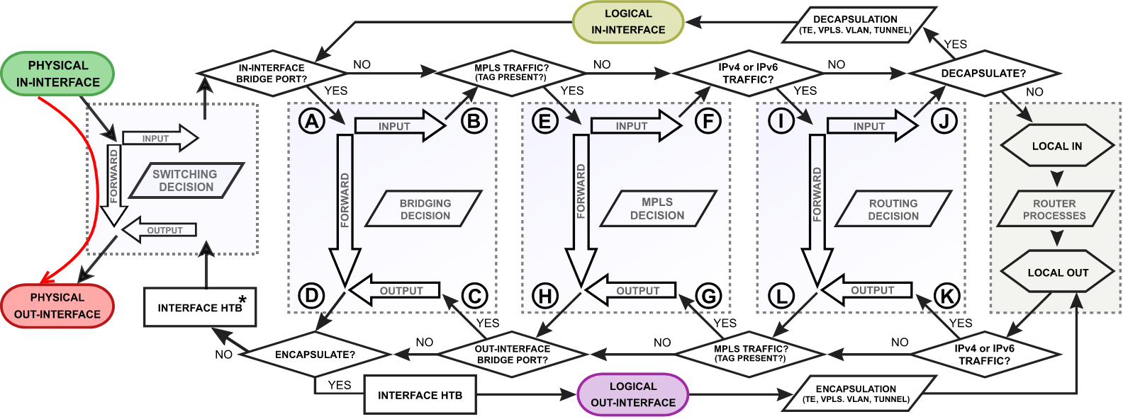

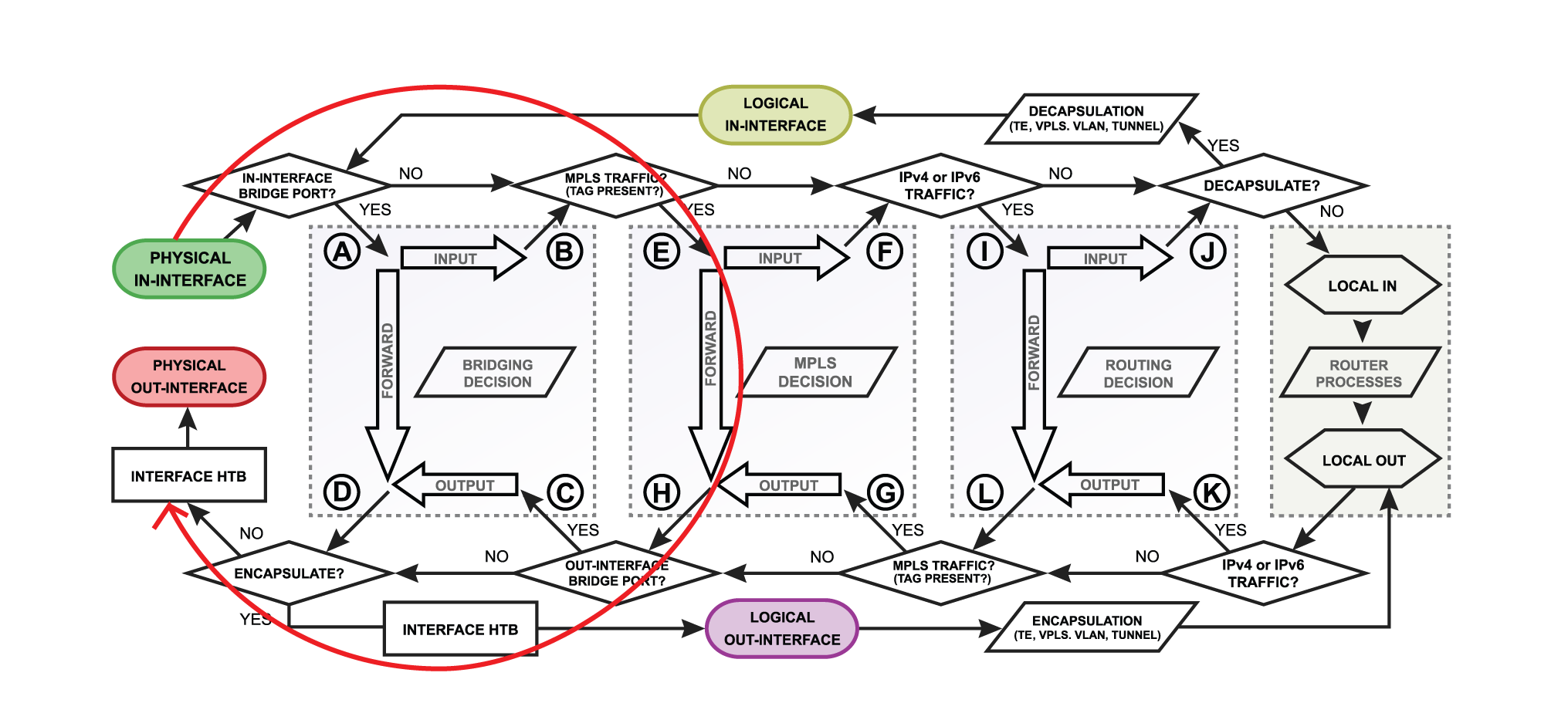

Overall Packetflow Diagram
Let's look at the overall diagram. It looks complicated at first, but after we go through the diagram with examples it will become much clearer.

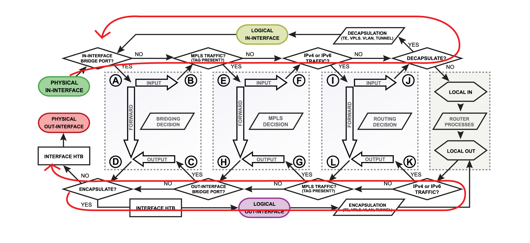

There are 4 boxes in the center of the diagram: Bridging, Routing, MPLS decisions, and local router processes. So for example, if the packet needs to be routed through the router, a packet will flow as illustrated in the image below. Without looking deeper into each facility, the packet enters the in-interface, the router determines that it is IP traffic and needs to be routed, the packet goes through all routing processes and exits the out-interface.
Let's take a look at another example that will illustrate what happens if the packet's destination is a router. For example, the in-interface receives an ICMP (ping) packet, its destination is the router itself, so the packet will go for local-in processing. After the packet is processed, an ICMP (ping) reply is generated inside the router (local-out processing) and will be sent out over the out-interface.
A simple explanation of each box before we go further with examples:
- Physical in-interface - the starting point of the packet received by the router.
- Logical in-interface - the starting point of the decapsulated packet (from tunnels, IPsec, etc).
- Local in - the last point of a packet destined to the router itself.
- Interface HTB (Hierarchical Token Bucket) - interface queue.
- Physical out-interface - the last point of the packet before it is actually sent out.
- Logical out-interface - the last point of the packet before encapsulation (to tunnels, IPsec, etc).
- Local out - the starting point of a packet generated by the router.

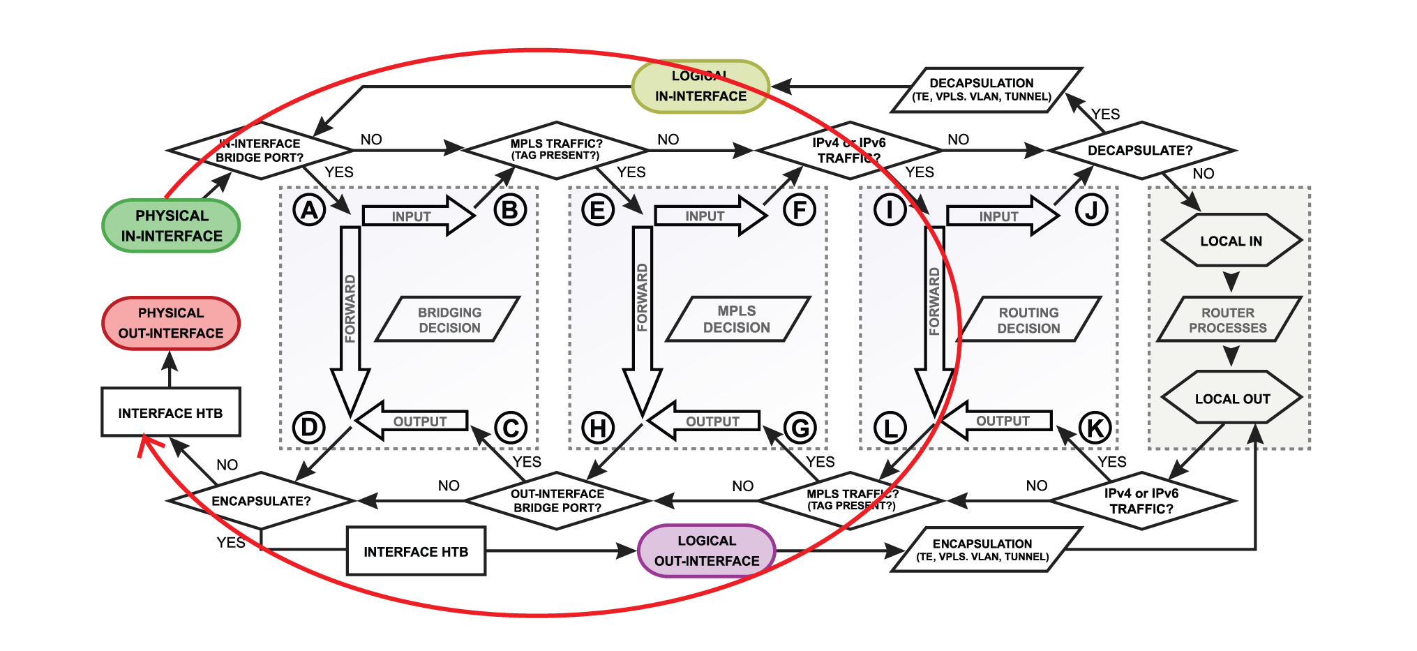

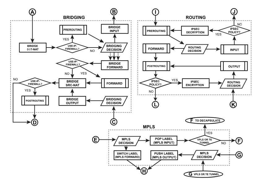

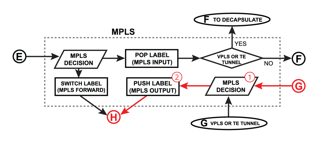

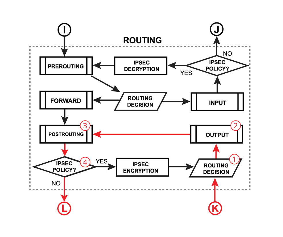

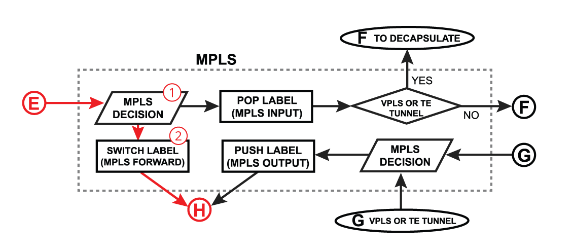

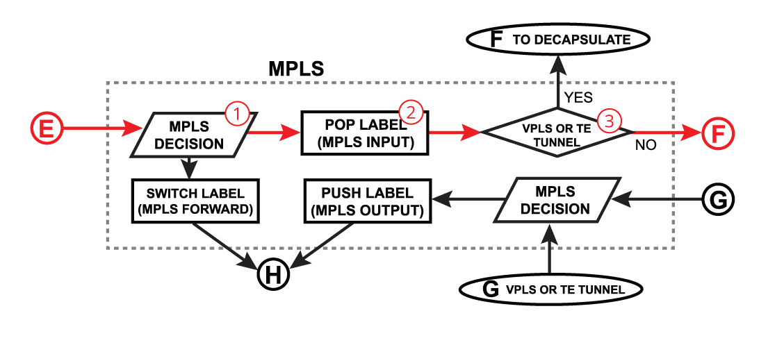

Now it is time to take a deeper look at what is happening inside bridging, MPLS, and routing flows.
- Routing decision - goes through routes in the routing table to find a match for the destination IP address of the packet. When a match is found - the packet will be processed further, in case of no match - the packet will be discarded.
- MPLS decision - what to do with the packet based on MPLS forwarding tables.
- Bridging decision - bridge goes through the MAC address table to find a match for the destination MAC address of the packet. When a match is found - the packet will be processed further, in case of no match - multiple copies of the packet will be created and packets will be flooded (sent out via all bridge ports). A single packet copy will also reach a bridge input chain as the bridge interface itself is one of the many destinations. When using
vlan-filtering=yes, packets that are not allowed due to the/interface/bridge/vlantable will be dropped at this stage. - use-ip-firewall - whether a 'use-ip-firewall' option is enabled in bridge settings.
- ipsec-policy - whether a packet matches any of the configured IPsec policies.

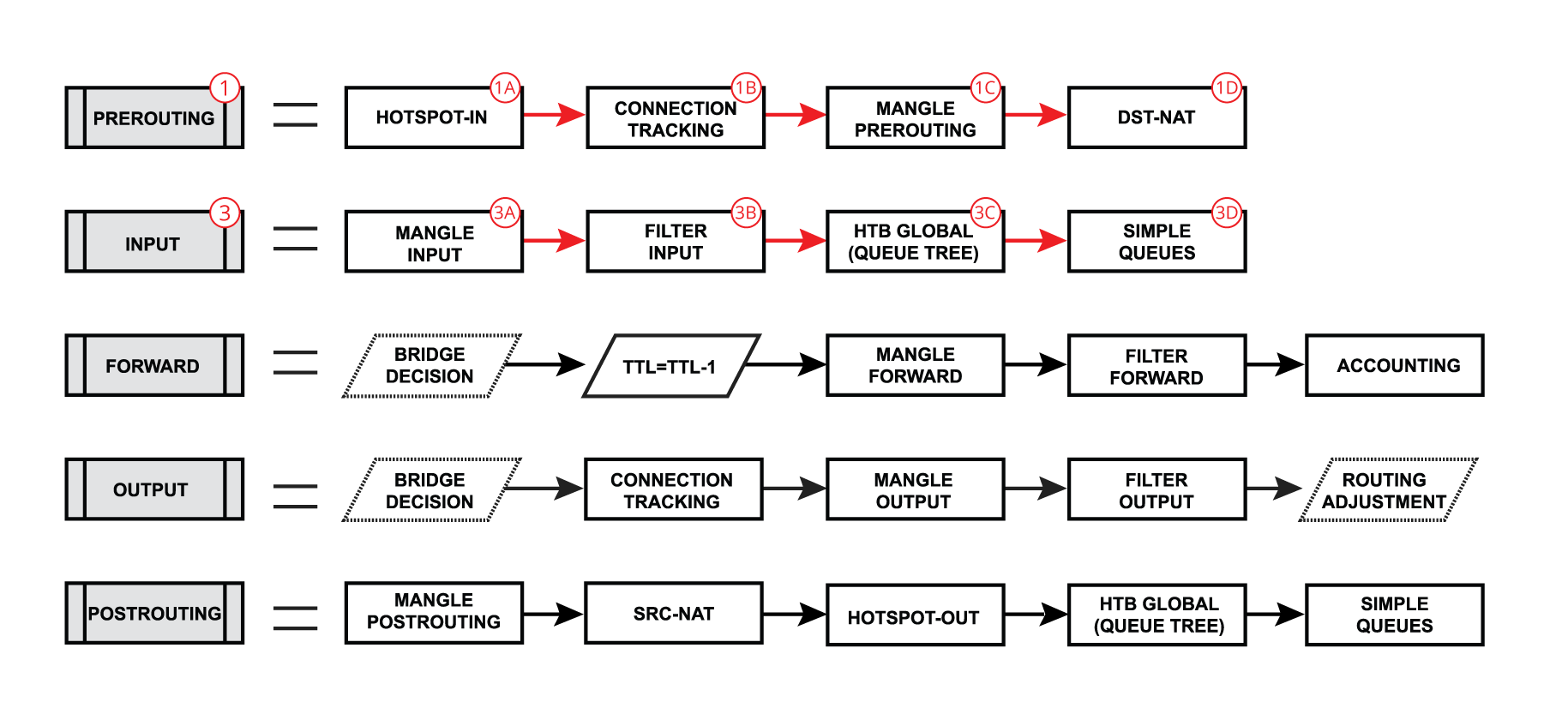

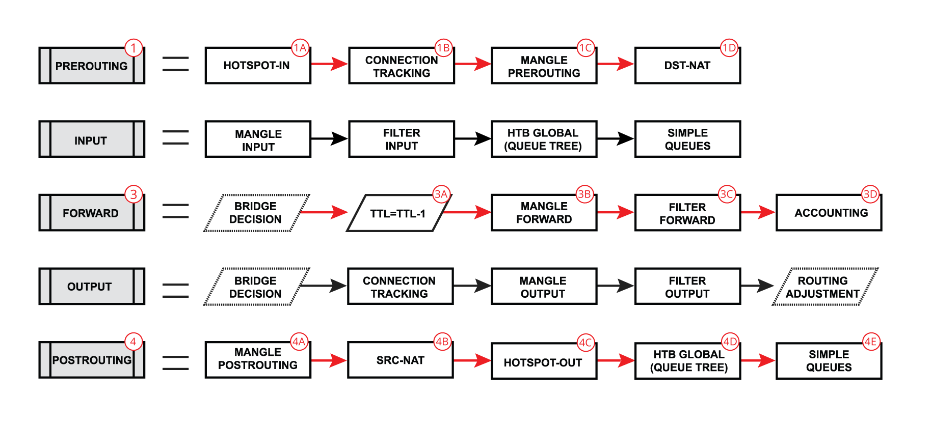

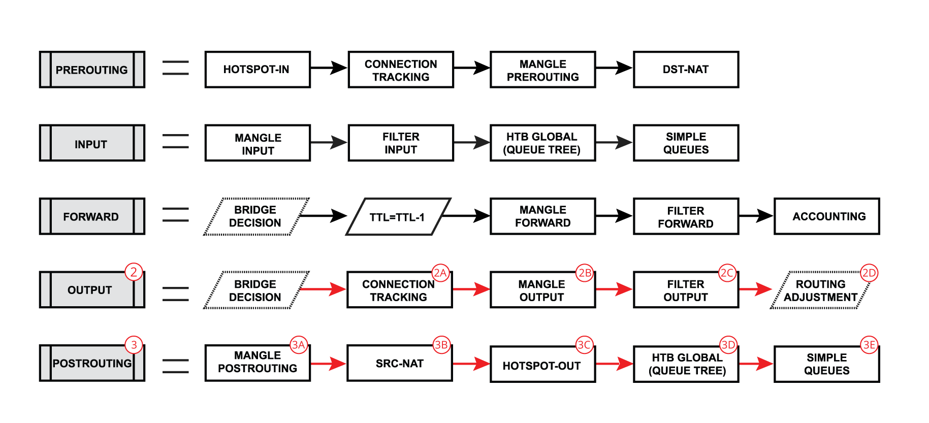

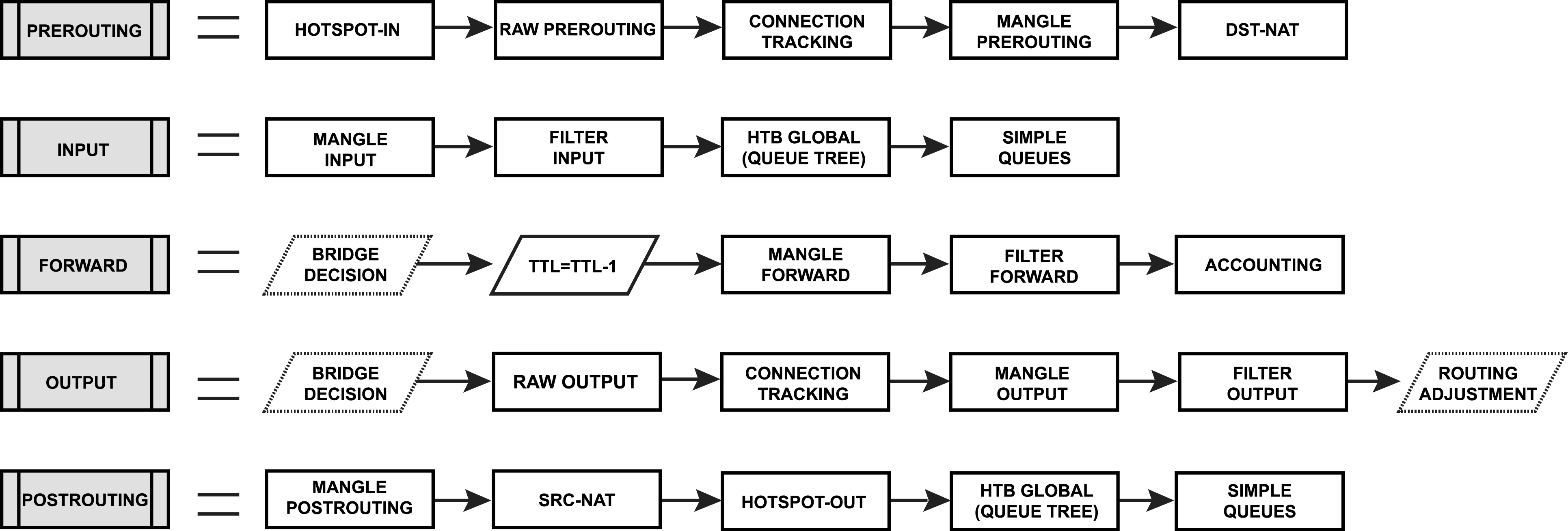

Chains
RouterOS consists of a few default chains. These chains allow you to filter packets at various points:
- The PREROUTING chain: Rules in this chain apply to packets as they just arrive on the network interface. This chain is present in the nat, mangle and raw tables.
- The INPUT chain: Rules in this chain apply to packets just before they’re given to a local process. This chain is present in the mangle and filter tables.
- The OUTPUT chain: The rules here apply to packets just after they’ve been produced by a process. This chain is present in the raw, mangle, nat, and filter tables.
- The FORWARD chain: The rules here apply to any packets that are routed through the current host. This chain is only present in the mangle and filter tables.
- The POSTROUTING chain: The rules in this chain apply to packets as they just leave the network interface. This chain is present in the nat and mangle tables.

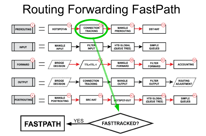

Each of the prerouting, input, forward, output, and postrouting blocks contains even more facilities, which are illustrated in the third part of the packet flow diagram:
- Hotspot-in - Allows to capture traffic that otherwise would be discarded by connection tracking - this way our Hotspot feature is able to provide connectivity even if network settings are an incomplete mess.
- RAW Prerouting - RAW table prerouting chain.
- Connection tracking - Packet is processed by connection tracking.
- Mangle Prerouting - Mangle prerouting chain.
- Mangle Input - Mangle input chain.
- Filter Input - Firewall filter input chain.
- HTB Global - Queue tree.
- Simple Queues - Is a feature that can be used to limit traffic for a particular target.
- TTL - Indicates an exact place where the Time To Live (TTL) of the routed packet is reduced by 1. If TTL becomes 0, a packet will be discarded.
- Mangle Forward - Mangle forward chain.
- Filter Forward - Filter forward chain.
- Accounting - Authentication, Authorization, and Accounting feature processing.
- RAW Output - RAW table output chain.
- Mangle Output - Mangle output chain.
- Filter Output - Firewall filter output chain.
- Routing Adjustment - This is a workaround that allows to set up policy routing in mangle chain output (routing-mark).
- Mangle Postrouting - Mangle postrouting chain.
- Src Nat - Network Address Translation srcnat chain.
- Dst Nat - Network Address Translation dstnat chain.
- Hotspot-out - Undoes all that was done by hotspot-in for the packets that are going back to the client.

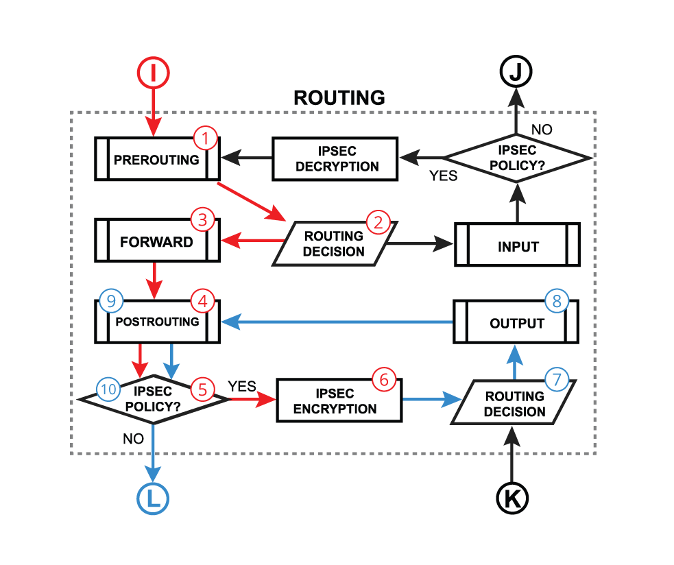

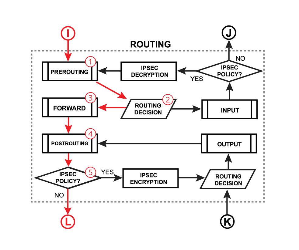

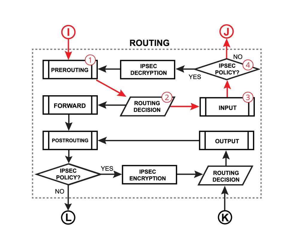

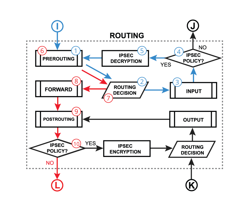

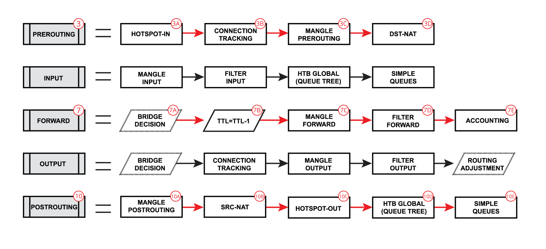

Flow of Routed Packet
Forward
Now, let's take our first example where the packet gets routed over the router and look deeper through what facilities the packet goes through:
We already learned that a packet goes into the in-interface, the router determines that it is an IP packet and needs to be routed, and here starts the complicated process:
- The packet enters prerouting processing:
- Check if there is a hotspot and modify the packet for hotspot use.
- Process packet through RAW prerouting chain.
- Send the packet through connection tracking.
- Process packet through Mangle prerouting chain.
- Process packet through NAT's dst-nat chain.
- Run packet through the routing table to make a routing decision.
- The packet enters the forward process:
- Check TTL value.
- Process packet through Mangle forward chain.
- Process packet through the Filter forward chain.
- Send the packet to accounting processes.
- A packet enters the postrouting process:
- Process packet through Mangle postrouting chain.
- Process packet through NAT's src-nat chain.
- If there is a hotspot undo any modifications made in hotspot-in.
- Process packet through queue tree (HTB Global).
- Process packet through simple queues.
- Check if there is IPsec and then process through IPsec policies.
Input
We already learned that the packet goes into the in-interface, the router determines that it is an IP packet and needs to be routed, and here starts the complicated process:
- A very similar process happens when a packet's destination is a router (routing input): Packet enters prerouting processing:
- Send a packet through connection tracking.
- Run packet through routing table to make a routing decision.
- A Packet enters the input process:
- Process packet through Mangle input chain.
- Process packet through Filter input chain.
- Check if there is IPsec and then process it through IPsec policies.
Output
Or when a packet is originated from the router (routing output):
- The packet is originated from the router itself.
- The packet goes through the routing table to make a routing decision.
- A packet enters the output process.
- Process the packet through the Bridge decision.
- Process the packet through the Mangle output chain.
- Process the packet through the Filter output chain.
- Send the packet to routing adjustment (policy routing).
- The packet enters postrouting process.
- Process the packet through Mangle postrouting chain.
- Process the packet through NAT's src-nat chain.
- If there is a hotspot, undo any modifications made in hotspot-in.
- Process the packet through queue tree (HTB Global).
- Process the packet through simple queues.

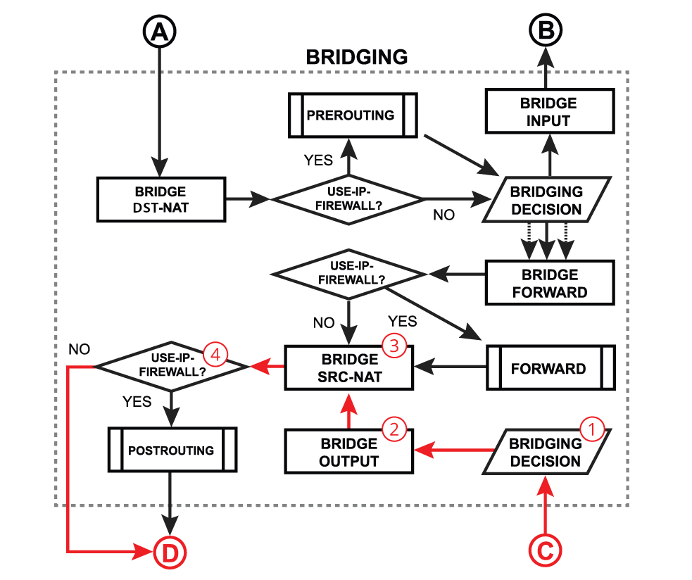

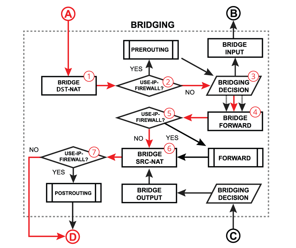

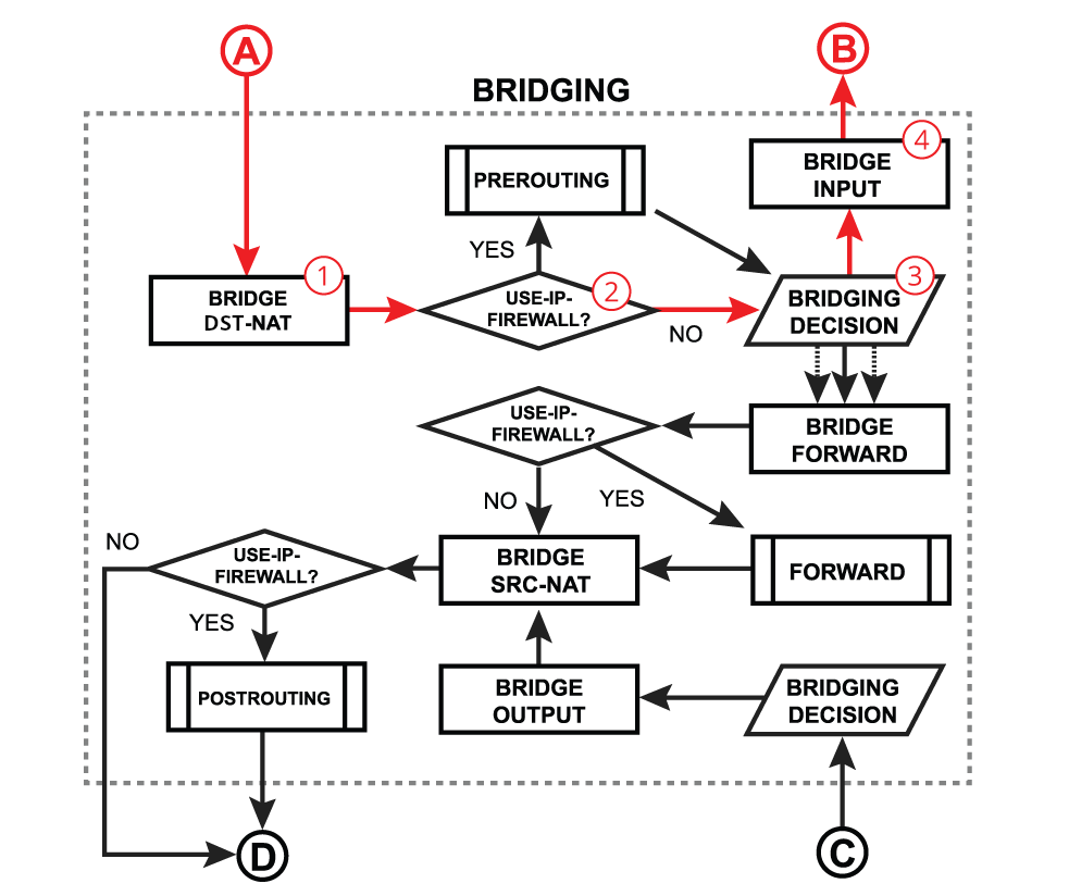

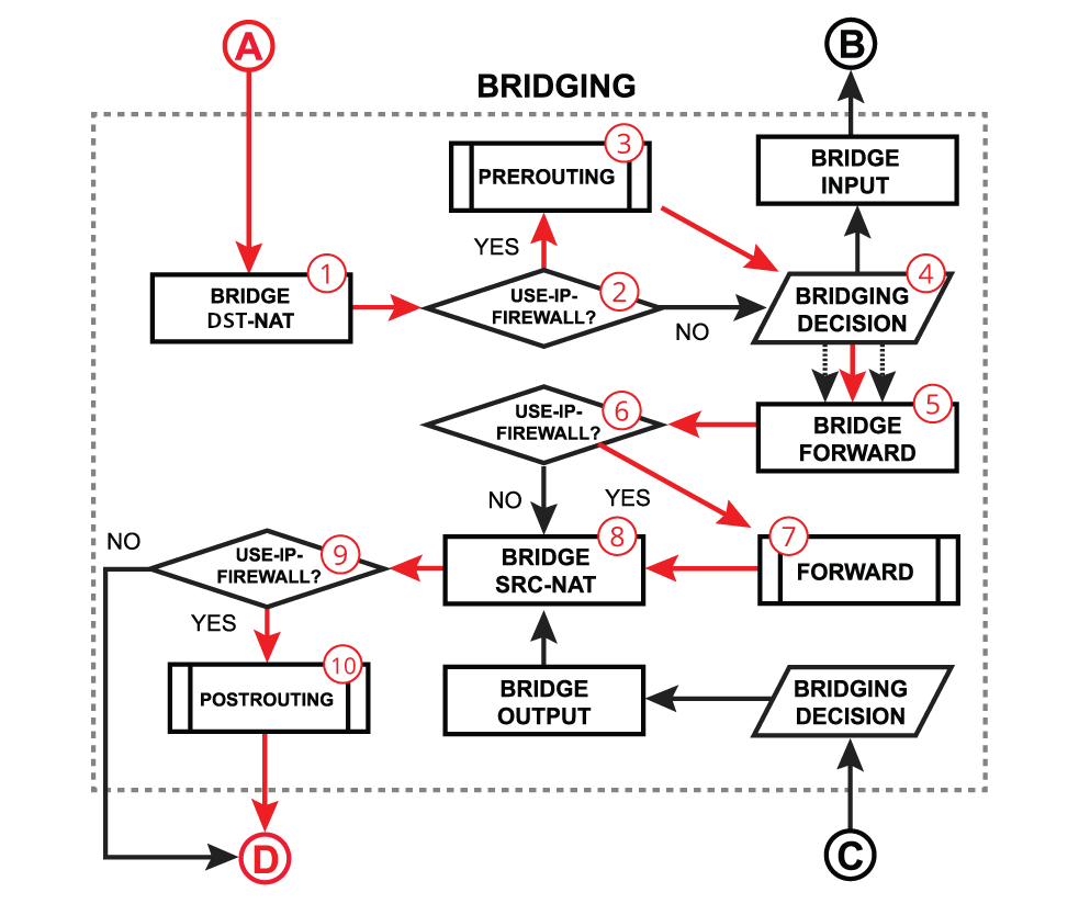

Flow of Bridged Packet
Below is discussed a general bridging process in RouterOS. Most of the packets will always follow the same processing path, but in certain configurations (e.g. with enabled VLAN filtering, horizon, STP, DHCP, or IGMP snooping) some packets can be treated differently. Please visit the bridging manual for more specific information.
Bridge Forward
Bridge forward is a process that takes place when a packet is forwarded from one bridge port to another, essentially connecting multiple devices on the same network. After receiving a packet on the in-interface, the device determines that the in-interface is a bridge port, so the packet gets passed through the bridging process:
- A packet goes through the bridge NAT dst-nat chain, where MAC destination and priority can be changed, apart from that, a packet can be simply accepted, dropped, or marked.
- Checks whether the use-ip-firewall option is enabled in the bridge settings.
- Runs the packet through the bridge host table to make a forwarding decision. A packet that ends up being flooded (e.g. broadcast, multicast, unknown unicast traffic), gets multiplied per bridge port and then processed further in the bridge forward chain. When using
vlan-filtering=yes, packets that are not allowed due to the/interface/bridge/vlantable will be dropped at this stage. - A packet goes through the bridge filter forward chain, where priority can be changed or the packet can be simply accepted, dropped, or marked.
- A packet goes through the bridge NAT src-nat chain, where MAC source and priority can be changed, apart from that, a packet can be simply accepted, dropped, or marked.
For RouterOS v6:
When bridge vlan-filtering is enabled, received untagged packets might get encapsulated into the VLAN header before the "DST-NAT" block, which means these packets can be filtered using the mac-protocol=vlan and vlan-encap settings. Encapsulation can happen if the outgoing interface has frame-types set to admit-all or admit-only-untagged-and-priority-tagged.
Tagged packets might get decapsulated on the "BRIDGING DECISION" block, which means these packets will no longer match the mac-protocol=vlan and vlan-encap settings. Decapsulation can happen if the packet's VLAN ID matches the outgoing port's untagged VLAN membership.
For RouterOS v7 and newer:
When bridge vlan-filtering is enabled, received untagged packets might get encapsulated into the VLAN header on the "BRIDGING-DECISION" block, which means these packets can be filtered using the mac-protocol=vlan and vlan-encap settings. Encapsulation can happen if the outgoing interface has frame-types set to admit-all or admit-only-untagged-and-priority-tagged.
Bridge Input
Bridge input is a process that takes place when a packet is destined for the bridge interface. Most commonly this happens when you need to reach some services that are running on the bridge interface (e.g. a DHCP server) or you need to route traffic to other networks. The very first steps are similar to the bridge forward process - after receiving a packet on the in-interface, the device determines that the in-interface is a bridge port, so it gets passed through the bridging process:
- Run packet through the bridge host table to make a forwarding decision. A packet where the destination MAC address matches the bridge MAC address will be passed to the bridge input chain. A packet that ends up being flooded (e.g. broadcast, multicast, unknown unicast traffic) also reaches the bridge input chain as the bridge interface itself is one of the many destinations.
- A packet goes through the bridge filter input chain, where priority can be changed or the packet can be simply accepted, dropped, or marked.
Bridge Output
Bridge output is a process that takes place when a packet should exit the device through one or multiple bridge ports. Most commonly this happens when a bridge interface itself tries to reach a device connected to a certain bridge port (e.g. when a DHCP server running on a bridge interface is responding to a DHCP client). After a packet is processed by other higher-level RouterOS processes and the device finally determines that the output interface is a bridge, the packet gets passed through the bridging process:
- Run the packet through the bridge host table to make a forwarding decision. A packet that ends up being flooded (e.g. broadcast, multicast, unknown unicast traffic) gets multiplied per bridge port and then processed further in the bridge output chain.
- A packet goes through the bridge filter output chain, where priority can be changed or the packet can be simply accepted, dropped, or marked.
Forward With Firewall Enabled
In certain network configurations, you might need to enable additional processing on routing chains for bridged traffic, for example, to use simple queues or an IP firewall. This can be done when the use-ip-firewall is enabled under the bridge settings. Note that additional processing will consume more CPU resources to handle these packets. All the steps were already discussed in previous points; below is a recap:
- A packet goes through the bridge NAT dst-nat chain.
- With the use-ip-firewall option enabled, the packet will be further processed in the prerouting chain.
- A packet enters prerouting processing.
- A packet goes through the bridge filter forward chain.
- With the use-ip-firewall option enabled, the packet will be further processed in the routing forward chain.
- A packet enters routing forward processing.
- A packet goes through the bridge NAT src-nat chain.
- With the use-ip-firewall option enabled, the packet will be further processed in the postrouting chain.
- A packet enters postrouting processing.

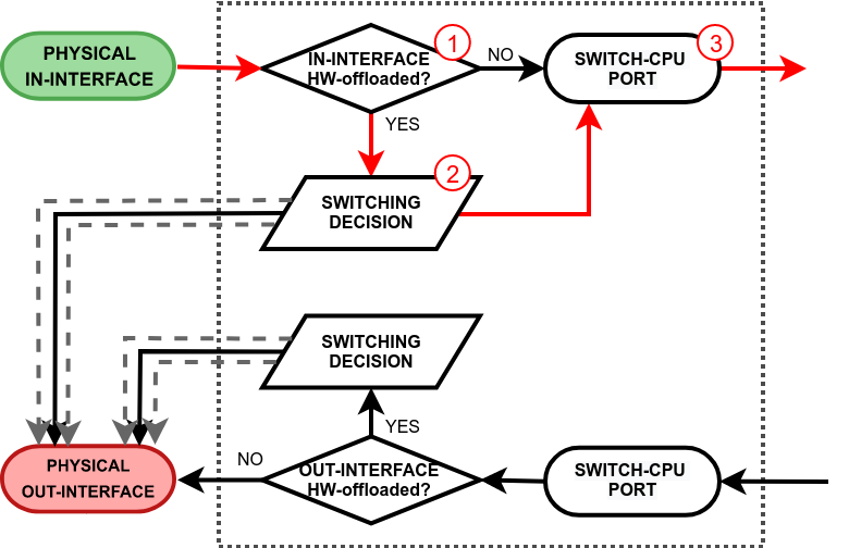

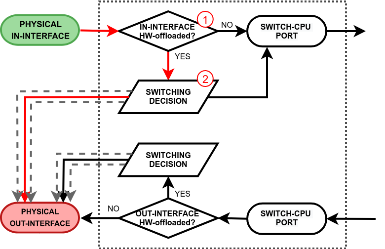

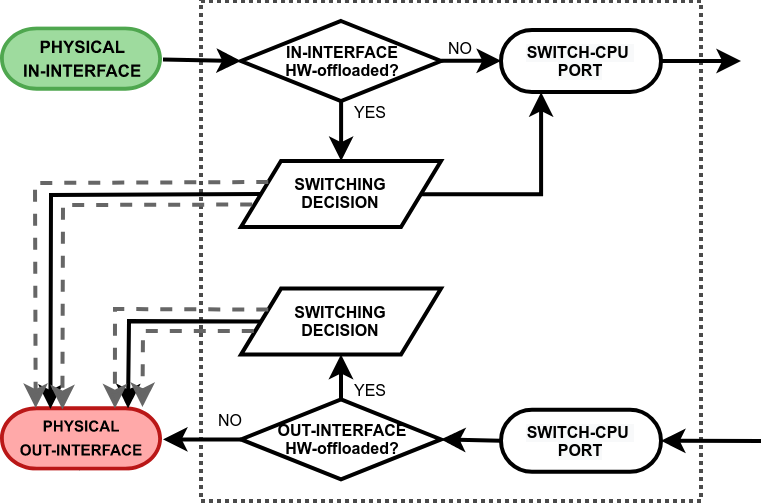

Flow of Hardware Offloaded Packet
On the previous topic, we solely discussed software bridging that requires the main CPU processing to forward packets through the correct bridge port. Most of the MikroTik devices are equipped with dedicated switching hardware, the so-called switch chip or switch ASIC. This allows us to offload some of the bridging functions, like packet forwarding between bridge ports or packet filtering, to this specialized hardware chip without consuming any CPU resources. In RouterOS, we have named this function Bridge Hardware (HW) Offloading. Different MikroTik devices might have different switch chips and each chip has a different set of features available, so make sure to visit this article to get more details - Bridge Hardware Offloading.
Interface HTB will not work correctly when the out-interface is hardware offloaded and the bridge Fast Path is not active.
- Switching decision - widely depends on the switch model. This block controls all the switching-related tasks, like host learning, packet forwarding, filtering, VLAN tagging/untagging, etc. Certain switch configurations can alter the packet flow.
- switch-cpu port - a special purpose switch port for communication between the main CPU and other switch ports. Note that the switch-cpu port does not show up anywhere on RouterOS except for the switch menu. None of the software-related configurations (e.g. interface-list) can be applied to this port. Packets that reach the CPU are automatically associated with the physical in-interface.
The hardware offloading, however, does not restrict a device to only hardware limited features; rather, it is possible to take advantage of the hardware and software processing at the same time. This does require a profound understanding of how packets travel through the switch chip and when exactly they are passed to the main CPU.
Switch features found in the /interface/ethernet/switch menu and its sub-menus, like ACL rules, mirroring, ingress/egress rate limiters, QoS, and L3HW (except inter-VLAN routing) may not rely on bridge hardware offloading. Therefore, they can potentially be applied to interfaces not configured within a hardware-offloaded bridge.
Switch Forward
We will further discuss a packet flow when bridge hardware offloading is enabled and a packet is forwarded between two switched ports on a single switch chip. This is the most common and also the simplest example:
- The switch checks whether the in-interface is a hardware offloaded interface.
- The switch runs a packet through the switch host table to make a forwarding decision. If the switch finds a match for the destination MAC address, the packet is sent out through the physical interface. A packet that ends up being flooded (e.g. broadcast, multicast, unknown unicast traffic) gets multiplied and sent out to every hardware offloaded switch port.

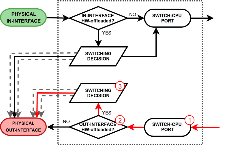

Switch to CPU Input
This process takes place when a packet is received on a physical interface and it is destined for the switch-cpu port for further software processing. There are two paths to the switch-cpu. One is where hardware offloading and switching are not even used (e.g. a standalone interface for routing or a bridged interface but with deliberately disabled HW offloading), so the packet is simply passed further for software processing. Another path is taken when hardware offloading is active on the in-interface. This will cause the packet to pass through the switching decision and there are various reasons why the switch might forward the packet to the switch-cpu port:
- A packet's destination MAC address matches a local MAC address, e.g. when a packet is destined to a local bridge interface.
- A packet might get flooded to all switch ports including the switch-cpu port, e.g. when broadcast, multicast, or unknown unicast traffic is received.
- A switch might have learned that some hosts can only be reached through the CPU (switch-cpu port learning is discussed in the next section), e.g. when a bridge contains HW and non-HW offloaded interfaces, such as wireless, EoIP, and even Ethernet interfaces.
- A packet is intentionally copied to the switch-cpu, e.g. for a packet inspection.
- A packet is triggered by the switch configuration and should be processed in software, e.g. DHCP or IGMP snooping.
See the packet walkthrough when an in-interface is hardware offloaded:
- Runs a packet through the switch host table to make a forwarding decision. In case any of the above-mentioned points are true, the packet gets forwarded to the switch-cpu port.
- The packet exits through the switch-cpu port and it will be further processed by the RouterOS packet flow.
Any received packet that was flooded by the switch chip will not get flooded again by the software bridge to the same HW offloaded switch group. This prevents the formation of duplicate packets.
CPU Output to Switch
This process takes place when a packet exits the RouterOS software processing and is received on the switch-cpu port. Again, there are two paths the packet can take. One path is where hardware offloading and switching are not even used (e.g. a standalone interface for routing or a bridged interface but with deliberately disabled HW offloading), so the packet is simply sent out through the physical out-interface. Another path is taken when hardware offloading is active on the out-interface. This will cause the packet to pass through the switching decision. Just like any other switch port, the switch will learn the source MAC addresses from packets that are received on the switch-cpu port. This does come in handy when a bridge contains HW and non-HW offloaded interfaces, so the switch can learn which frames should be forwarded to the CPU. See the packet walkthrough when an out-interface is hardware offloaded:
- A packet that exits the RouterOS software processing is received on the switch-cpu port.
- The switch checks whether the out-interface is a hardware offloaded interface.
A software bridge that sends a flooded packet through HW offloaded interfaces will only send a single packet copy per HW offloaded switch group rather than per HW offloaded interface. The actual flooding will be done by the switch chip; this prevents the formation of duplicate packets.
Flow of MPLS Packet
Pop Label
Switch Label
Push Label
MPLS IP VPN
In VPNv4 setups a packet arriving at the PE router that needs to be forwarded to the CE router is not a typical "forward".
If incoming label and destination are bound to the VRF Then after MPLS label is popped and:
- The Destination address is local to the router, then the packet is moved to LOCAL_IN.
- The Destination address is in the CE network, then the packet is moved to LOCAL_OUT.
Forwarded packets from MPLS cloud to the CE network will not show up in forward.

Logical Interfaces
So far we have looked at examples when in or out interfaces are actual physical interfaces (Ethernet, wireless), but how will packets flow if the router receives tunnel encapsulated packets?
Let's assume that there is an IPIP packet coming into the router. Since it is a regular IPv4 packet it will be processed through all routing-related facilities ( until "J" in the diagram). Then the router will look if the packet needs to be decapsulated. In this case, it is an IPIP packet so "yes" send the packet to decapsulation. After that the packet will go another loop through all the facilities but this time as a decapsulated IPv4 packet.
It is very important because the packet actually travels through the firewall twice, so if there is a strict firewall, then there should be "accept" rules for IPIP encapsulated packets as well as decapsulated IP packets.
Packet encapsulation and decapsulation using a bridge with enabled vlan-filtering do not relate to logical interfaces. See more details in the bridging section.
IPSec Policies
Let's take a look at another tunnel type - IPSec. This type of VPN does not have logical interfaces but is processed in a similar manner.
Instead of logical interfaces, packets are processed through IPSec policies. After routing decision (2) and input firewall processing (3), the router tries to match the source and destination to the IPsec policy. When policy matches the packet, it is sent to decryption (5). After the decryption, the packet enters PREROUTING processing again (6) and starts another processing loop, but now with the decapsulated packet.
The same process applies to encapsulation but in reverse order. The first IP packet gets processed through facilities, then matched against IPsec policies (5), encapsulated (6), and then sent to processing on the second loop (7-10).

A Bridge handler is used if the following conditions are met:
- There are no bridge Calea, filter, NAT rules.
- use-ip-firewall is disabled.
- No mesh, MetaRouter interface configuration.
- sniffer, torch, and traffic generator are not running.
- bridge vlan-filtering is disabled (condition is removed since RouterOS version 7.2).
- bridge dhcp-snooping is disabled.
FastPath on the vlan-filtering bridge does NOT support priority-tagged packets (packets with VLAN header but VLAN ID = 0). Those packets are redirected via a slow path.

FastTrack
Fasttrack can be decoded as Fast Path + Connection Tracking. It allows marking connections as "fast-tracked", marking packets that belong to a fast-tracked connection will be sent the fast-path way. The connection table entry for such a connection now will have a fast-tracked flag.
FastTrack packets bypass firewall, connection tracking, simple queues, queue tree with parent=global, ip traffic-flow, IP accounting, IPSec, hotspot universal client, VRF assignment, so it is up to the administrator to make sure FastTrack does not interfere with other configuration!
To mark a connection as fast-tracked, a new action was implemented "fasttrack-connection" for firewall filter and mangle. Currently, only TCP and UDP connections can be fast-tracked and to maintain connection tracking entries, some random packets will still be sent to a slow path. This must be taken into consideration when designing firewalls with "fasttrack" enabled.
The FastTrack handler also supports source and destination NAT, so special exceptions for NATed connections are not required.
Traffic that belongs to a fast-tracked connection travels in FastPath, which means that it will not be visible by other router L3 facilities (firewall, queues, IPsec, IP accounting, VRF assignment, etc). Fasttrack lookups route before routing marks have been set, so it works only with the main routing table.

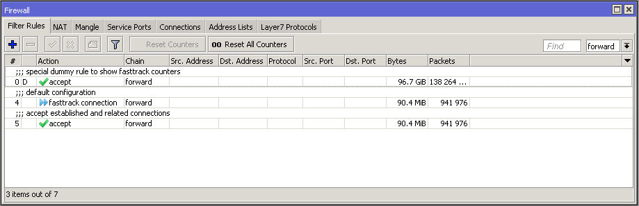

Notice that the first rule marks established/related connections as fast-tracked, the second rule is still required to accept packets belonging to those connections. The reason for this is that, as was mentioned earlier, some random packets from fast-tracked connections are still sent through the slow pathway and only UDP and TCP are fast-tracked, but we still want to accept packets for other protocols.

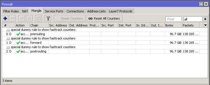

After adding the "FastTrack" rule, a special dummy rule appeared at the top of the list. This is not an actual rule, it is for visual information showing that some of the traffic is traveling FastPath and will not reach other firewall rules.
FastTrack can process packets only in the main routing table so it is the system administrator's duty to not FastTrack connections that are going through a non-main routing table (thus connections that are processed with mangle action=mark-routing rules). Otherwise packets might be misrouted through the main routing table.
These rules appear as soon as there is at least one fast-tracked connection tracking entry and will disappear after the last fast-tracked connection times out in the connection table.
The connection is FastTracked until a connection is closed, timed out or the router is rebooted.
