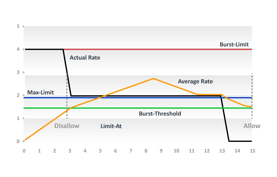

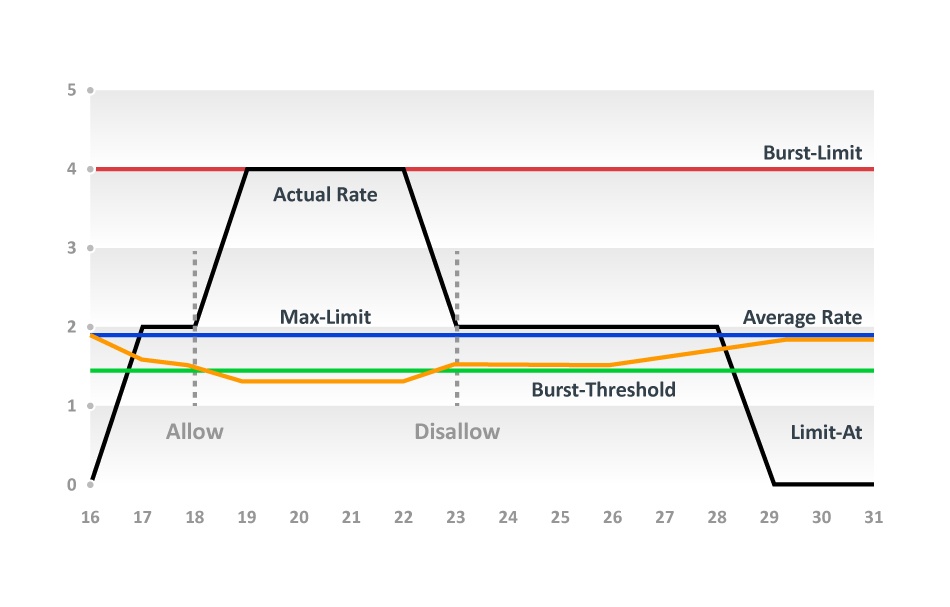

Example
Values: limit-at=1M , max-limit=2M , burst-threshold=1500k , burst-limit=4M
The client will try to download two 4MB (32Mb) blocks of data, the first download will start at zero seconds, and the second download will start at the 17th second. Traffic was unused at the last minute.
Burst-time=16s
As we can see as soon as the client requested bandwidth it was able to get 4Mbps burst for 6 seconds. This is the longest possible burst with given values (longest-burst-time = burst-threshold * burst-time / burst-limit). As soon as the burst runs out, the rest of the data will be downloaded with 2Mbps. This way, a block of data was downloaded in 9 seconds - without burst, it would take 16 seconds. Burst has 7 seconds to recharge before the next download will start.
Note that burst is still disallowed when the download started and it kicks in only afterward - in the middle of a download. So with this example, we proved that a burst may happen in the middle of a download. The burst was ~4 seconds long and the second block was downloaded 4 seconds faster than without burst.
The average rate is calculated every 1/16 of burst time so in this case 1s.
| Time | average-rate | burst | actual-rate |
| 0 | (0+0+0+0+0+0+0+0+0+0+0+0+0+0+0+0)/16=0Kbps | average-rate < burst-threshold → Burst is allowed | 4Mbps |
| 1 | (0+0+0+0+0+0+0+0+0+0+0+0+0+0+0+4)/16=250Kbps | average-rate < burst-threshold → Burst is allowed | 4Mbps |
| 2 | (0+0+0+0+0+0+0+0+0+0+0+0+0+0+4+4)/16=500Kbps | average-rate < burst-threshold → Burst is allowed | 4Mbps |
| 3 | (0+0+0+0+0+0+0+0+0+0+0+0+0+4+4+4)/16=750Kbps | average-rate < burst-threshold → Burst is allowed | 4Mbps |
| 4 | (0+0+0+0+0+0+0+0+0+0+0+0+4+4+4+4)/16=1000Kbps | average-rate < burst-threshold → Burst is allowed | 4Mbps |
| 5 | (0+0+0+0+0+0+0+0+0+0+0+4+4+4+4+4)/16=1250Kbps | average-rate < burst-threshold → Burst is allowed | 4Mbps |
| 6 | (0+0+0+0+0+0+0+0+0+0+4+4+4+4+4+4)/16=1500Kbps | average-rate = burst-threshold → Burst is not allowed | 2Mbps |
| 7 | (0+0+0+0+0+0+0+0+0+4+4+4+4+4+4+2)/16=1625Kbps | average-rate > burst-threshold → Burst is not allowed | 2Mbps |
| 8 | (0+0+0+0+0+0+0+0+4+4+4+4+4+4+2+2)/16=1750Kbps | average-rate > burst-threshold → Burst is not allowed | 2Mbps |
| 9 | (0+0+0+0+0+0+0+4+4+4+4+4+4+2+2+2)/16=1875Kbps | average-rate > burst-threshold → Burst is not allowed | 2Mbps |
| 10 | (0+0+0+0+0+0+4+4+4+4+4+4+2+2+2+2)/16=2Mbps | average-rate > burst-threshold → Burst is not allowed | 0Mbps |
| 11 | (0+0+0+0+0+4+4+4+4+4+4+2+2+2+2+0)/16=2Mbps | average-rate > burst-threshold → Burst is not allowed | 0Mbps |
| 12 | (0+0+0+0+4+4+4+4+4+4+2+2+2+2+0+0)/16=2Mbps | average-rate > burst-threshold → Burst is not allowed | 0Mbps |
| 13 | (0+0+0+4+4+4+4+4+4+2+2+2+2+0+0+0)/16=2Mbps | average-rate > burst-threshold → Burst is not allowed | 0Mbps |
| 14 | (0+0+4+4+4+4+4+4+2+2+2+2+0+0+0+0)/16=2Mbps | average-rate > burst-threshold → Burst is not allowed | 0Mbps |
| 15 | (0+4+4+4+4+4+4+2+2+2+2+0+0+0+0+0)/16=2Mbps | average-rate > burst-threshold → Burst is not allowed | 0Mbps |
| 16 | (4+4+4+4+4+4+2+2+2+2+0+0+0+0+0+0)/16=2Mbps | average-rate > burst-threshold → Burst is not allowed | 0Mbps |
| 17 | (4+4+4+4+4+2+2+2+2+0+0+0+0+0+0+0)/16=1750Kbps | average-rate > burst-threshold → Burst is not allowed | 2Mbps |
| 18 | (4+4+4+4+2+2+2+2+0+0+0+0+0+0+0+2)/16=1500Kbps | average-rate = burst-threshold → Burst is not allowed | 2Mbps |
| 19 | (4+4+4+2+2+2+2+0+0+0+0+0+0+0+2+2)/16=1375Kbps | average-rate < burst-threshold → Burst is allowed | 4Mbps |
| 20 | (4+4+2+2+2+2+0+0+0+0+0+0+0+2+2+4)/16=1375Kbps | average-rate < burst-threshold → Burst is allowed | 4Mbps |
| 21 | (4+2+2+2+2+0+0+0+0+0+0+0+2+2+4+4)/16=1375Kbps | average-rate < burst-threshold → Burst is allowed | 4Mbps |
| 22 | (2+2+2+2+0+0+0+0+0+0+0+2+2+4+4+4)/16=1375Kbps | average-rate < burst-threshold → Burst is allowed | 4Mbps |
| 23 | (2+2+2+0+0+0+0+0+0+0+2+2+4+4+4+4)/16=1500Kbps | average-rate = burst-threshold → Burst is not allowed | 2Mbps |
| 24 | (2+2+0+0+0+0+0+0+0+2+2+4+4+4+4+2)/16=1500Kbps | average-rate = burst-threshold → Burst is not allowed | 2Mbps |
| 25 | (2+0+0+0+0+0+0+0+2+2+4+4+4+4+2+2)/16=1500Kbps | average-rate = burst-threshold → Burst is not allowed | 2Mbps |
| 26 | (0+0+0+0+0+0+0+2+2+4+4+4+4+2+2+2)/16=1500Kbps | average-rate = burst-threshold → Burst is not allowed | 2Mbps |
| 27 | (0+0+0+0+0+0+2+2+4+4+4+4+2+2+2+2)/16=1625Kbps | average-rate > burst-threshold → Burst is not allowed | 2Mbps |
| 28 | (0+0+0+0+0+2+2+4+4+4+4+2+2+2+2+2)/16=1750Kbps | average-rate > burst-threshold → Burst is not allowed | 2Mbps |
| 29 | (0+0+0+0+2+2+4+4+4+4+2+2+2+2+2+2)/16=1875Kbps | average-rate > burst-threshold → Burst is not allowed | 0Mbps |
| 30 | (0+0+0+2+2+4+4+4+4+2+2+2+2+2+2+0)/16=1875Kbps | average-rate > burst-threshold → Burst is not allowed | 0Mbps |
| 31 | (0+0+2+2+4+4+4+4+2+2+2+2+2+2+0+0)/16=1875Kbps | average-rate > burst-threshold → Burst is not allowed | 0Mbps |

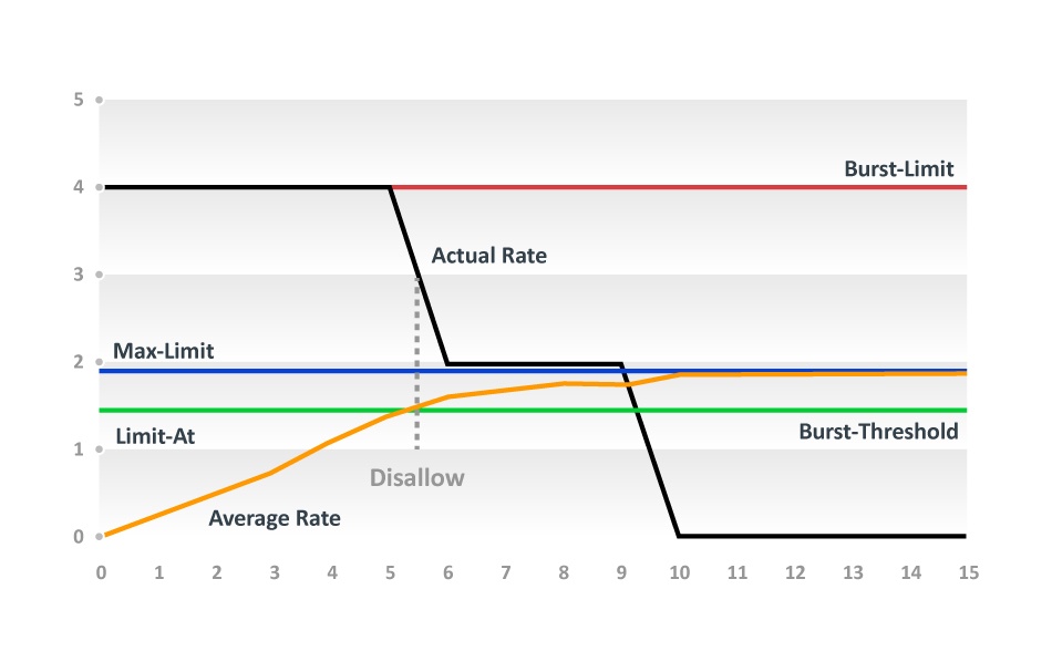

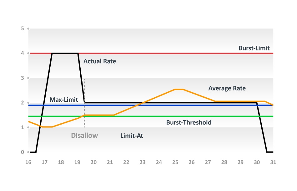

Burst-time=8s
If we decrease burst-time to 8 seconds - we are able to see that in this case, bursts are only at the beginning of downloads. The average rate is calculated every 1/16th of burst time, so in this case every 0.5 seconds.
| 0 | (0+0+0+0+0+0+0+0+0+0+0+0+0+0+0+0)/8=0Kbps | average-rate < burst-threshold → Burst is allowed | 4Mbps (2Mb per 0.5s) |
| 0.5 | (0+0+0+0+0+0+0+0+0+0+0+0+0+0+0+2)/8=250Kbps | average-rate < burst-threshold → Burst is allowed | 4Mbps (2Mb per 0.5s) |
| 1 | (0+0+0+0+0+0+0+0+0+0+0+0+0+0+2+2)/8=500Kbps | average-rate < burst-threshold → Burst is allowed | 4Mbps (2Mb per 0.5s) |
| 1.5 | (0+0+0+0+0+0+0+0+0+0+0+0+0+2+2+2)/8=750Kbps | average-rate < burst-threshold → Burst is allowed | 4Mbps (2Mb per 0.5s) |
| 2 | (0+0+0+0+0+0+0+0+0+0+0+0+2+2+2+2)/8=1000Kbps | average-rate < burst-threshold → Burst is allowed | 4Mbps (2Mb per 0.5s) |
| 2.5 | (0+0+0+0+0+0+0+0+0+0+0+2+2+2+2+2)/8=1250Kbps | average-rate < burst-threshold → Burst is allowed | 4Mbps (2Mb per 0.5s) |
| 3 | (0+0+0+0+0+0+0+0+0+0+2+2+2+2+2+2)/8=1500Kbps | average-rate = burst-threshold → Burst is not allowed | 2Mbps (1Mb per 0.5s) |
| 3.5 | (0+0+0+0+0+0+0+0+0+2+2+2+2+2+2+1)/8=1625Kbps | average-rate > burst-threshold → Burst is not allowed | 2Mbps (1Mb per 0.5s) |
| 4 | (0+0+0+0+0+0+0+0+2+2+2+2+2+2+1+1)/8=1750Kbps | average-rate > burst-threshold → Burst is not allowed | 2Mbps (1Mb per 0.5s) |
| 4.5 | (0+0+0+0+0+0+0+2+2+2+2+2+2+1+1+1)/8=1875Kbps | average-rate > burst-threshold → Burst is not allowed | 2Mbps (1Mb per 0.5s) |
| 5 | (0+0+0+0+0+0+2+2+2+2+2+2+1+1+1+1)/8=2000Kbps | average-rate > burst-threshold → Burst is not allowed | 2Mbps (1Mb per 0.5s) |
| 5.5 | (0+0+0+0+0+2+2+2+2+2+2+1+1+1+1+1)/8=2125Kbps | average-rate > burst-threshold → Burst is not allowed | 2Mbps (1Mb per 0.5s) |
| 6 | (0+0+0+0+2+2+2+2+2+2+1+1+1+1+1+1)/8=2250Kbps | average-rate > burst-threshold → Burst is not allowed | 2Mbps (1Mb per 0.5s) |
| 6.5 | (0+0+0+2+2+2+2+2+2+1+1+1+1+1+1+1)/8=2375Kbps | average-rate > burst-threshold → Burst is not allowed | 2Mbps (1Mb per 0.5s) |
| 7 | (0+0+2+2+2+2+2+2+1+1+1+1+1+1+1+1)/8=2500Kbps | average-rate > burst-threshold → Burst is not allowed | 2Mbps (1Mb per 0.5s) |
| 7.5 | (0+2+2+2+2+2+2+1+1+1+1+1+1+1+1+1)/8=2625Kbps | average-rate > burst-threshold → Burst is not allowed | 2Mbps (1Mb per 0.5s) |
| 8 | (2+2+2+2+2+2+1+1+1+1+1+1+1+1+1+1)/8=2750Kbps | average-rate > burst-threshold → Burst is not allowed | 2Mbps (1Mb per 0.5s) |
| 8.5 | (2+2+2+2+2+1+1+1+1+1+1+1+1+1+1+1)/8=2625Kbps | average-rate > burst-threshold → Burst is not allowed | 2Mbps (1Mb per 0.5s) |
| 9 | (2+2+2+2+1+1+1+1+1+1+1+1+1+1+1+1)/8=2500Kbps | average-rate > burst-threshold → Burst is not allowed | 2Mbps (1Mb per 0.5s) |
| 9.5 | (2+2+2+1+1+1+1+1+1+1+1+1+1+1+1+1)/8=2375Kbps | average-rate > burst-threshold → Burst is not allowed | 2Mbps (1Mb per 0.5s) |
| 10 | (2+2+1+1+1+1+1+1+1+1+1+1+1+1+1+1)/8=2250Kbps | average-rate > burst-threshold → Burst is not allowed | 2Mbps (1Mb per 0.5s) |
| 10.5 | (2+1+1+1+1+1+1+1+1+1+1+1+1+1+1+1)/8=2125Kbps | average-rate > burst-threshold → Burst is not allowed | 2Mbps (1Mb per 0,5sek) |
| 11 | (1+1+1+1+1+1+1+1+1+1+1+1+1+1+1+1)/8=2000Kbps | average-rate > burst-threshold → Burst is not allowed | 2Mbps (1Mb per 0,5sek) |
| 11.5 | (1+1+1+1+1+1+1+1+1+1+1+1+1+1+1+1)/8=2000Kbps | average-rate > burst-threshold → Burst is not allowed | 2Mbps (1Mb per 0,5sek) |
| 12 | (1+1+1+1+1+1+1+1+1+1+1+1+1+1+1+1)/8=2000Kbps | average-rate > burst-threshold → Burst is not allowed | 2Mbps (1Mb per 0,5sek) |
| 12.5 | (1+1+1+1+1+1+1+1+1+1+1+1+1+1+1+1)/8=2000Kbps | average-rate > burst-threshold → Burst is not allowed | 2Mbps (1Mb per 0,5sek) |
| 13 | (1+1+1+1+1+1+1+1+1+1+1+1+1+1+1+1)/8=2000Kbps | average-rate > burst-threshold → Burst is not allowed | 0Mbps (0Mb per 0.5s) |
| 13.5 | (1+1+1+1+1+1+1+1+1+1+1+1+1+1+1+0)/8=1875Kbps | average-rate > burst-threshold → Burst is not allowed | 0Mbps (0Mb per 0.5s) |
| 14 | (1+1+1+1+1+1+1+1+1+1+1+1+1+1+0+0)/8=1750Kbps | average-rate > burst-threshold → Burst is not allowed | 0Mbps (0Mb per 0,5sek) |
| 14.5 | (1+1+1+1+1+1+1+1+1+1+1+1+1+0+0+0)/8=1625Kbps | average-rate > burst-threshold → Burst is not allowed | 0Mbps (0Mb per 0,5sek) |
| 15 | (1+1+1+1+1+1+1+1+1+1+1+1+0+0+0+0)/8=1500Kbps | average-rate > burst-threshold → Burst is not allowed | 0Mbps (0Mb per 0,5sek) |
| 15.5 | (1+1+1+1+1+1+1+1+1+1+1+0+0+0+0+0)/8=1375Kbps | average-rate < burst-threshold → Burst is allowed | 0Mbps (0Mb per 0,5sek) |
| 16 | (1+1+1+1+1+1+1+1+1+1+0+0+0+0+0+0)/8=1250Kbps | average-rate < burst-threshold → Burst is allowed | 0Mbps (0Mb per 0,5sek) |
| 16.5 | (1+1+1+1+1+1+1+1+1+0+0+0+0+0+0+0)/8=1125Kbps | average-rate < burst-threshold → Burst is allowed | 0Mbps (0Mb per 0,5sek) |
| 17 | (1+1+1+1+1+1+1+1+0+0+0+0+0+0+0+0)/8=1000Kbps | average-rate < burst-threshold → Burst is allowed | 2Mbps (1Mb per 0.5s) |
| 17.5 | (1+1+1+1+1+1+1+0+0+0+0+0+0+0+0+1)/8=1000Kbps | average-rate < burst-threshold → Burst is allowed | 4Mbps (2Mb per 0.5s) |
| 18 | (1+1+1+1+1+1+0+0+0+0+0+0+0+0+1+2)/8=1125Kbps | average-rate < burst-threshold → Burst is allowed | 4Mbps (2Mb per 0.5s) |
| 18.5 | (1+1+1+1+1+0+0+0+0+0+0+0+0+1+2+2)/8=1250Kbps | average-rate < burst-threshold → Burst is allowed | 4Mbps (2Mb per 0,5sek) |
| 19 | (1+1+1+1+0+0+0+0+0+0+0+0+1+2+2+2)/8=1375Kbps | average-rate < burst-threshold → Burst is allowed | 4Mbps (2Mb per 0,5sek) |
| 19.5 | (1+1+1+0+0+0+0+0+0+0+0+1+2+2+2+2)/8=1500Kbps | average-rate = burst-threshold → Burst is not allowed | 2Mbps (1Mb per 0,5sek) |
| 20 | (1+1+0+0+0+0+0+0+0+0+1+2+2+2+2+1)/8=1500Kbps | average-rate = burst-threshold → Burst is not allowed | 2Mbps (1Mb per 0,5sek) |
| 20.5 | (1+0+0+0+0+0+0+0+0+1+2+2+2+2+1+1)/8=1500Kbps | average-rate = burst-threshold → Burst is not allowed | 2Mbps (1Mb per 0,5sek) |
| 21 | (0+0+0+0+0+0+0+0+1+2+2+2+2+1+1+1)/8=1500Kbps | average-rate = burst-threshold → Burst is not allowed | 2Mbps (1Mb per 0,5sek) |
| 21.5 | (0+0+0+0+0+0+0+1+2+2+2+2+1+1+1+1)/8=1625Kbps | average-rate > burst-threshold → Burst is not allowed | 2Mbps (1Mb per 0,5sek) |
| 22 | (0+0+0+0+0+0+1+2+2+2+2+1+1+1+1+1)/8=1750Kbps | average-rate > burst-threshold → Burst is not allowed | 2Mbps (1Mb per 0,5sek) |
| 22.5 | (0+0+0+0+0+1+2+2+2+2+1+1+1+1+1+1)/8=1875Kbps | average-rate > burst-threshold → Burst is not allowed | 2Mbps (1Mb per 0,5sek) |
| 23 | (0+0+0+0+1+2+2+2+2+1+1+1+1+1+1+1)/8=2000Kbps | average-rate > burst-threshold → Burst is not allowed | 2Mbps (1Mb per 0,5sek) |
| 23.5 | (0+0+0+1+2+2+2+2+1+1+1+1+1+1+1+1)/8=2125Kbps | average-rate > burst-threshold → Burst is not allowed | 2Mbps (1Mb per 0,5sek) |
| 24 | (0+0+1+2+2+2+2+1+1+1+1+1+1+1+1+1)/8=2250Kbps | average-rate > burst-threshold → Burst is not allowed | 2Mbps (1Mb per 0,5sek) |
| 24.5 | (0+1+2+2+2+2+1+1+1+1+1+1+1+1+1+1)/8=2375Kbps | average-rate > burst-threshold → Burst is not allowed | 2Mbps (1Mb per 0,5sek) |
| 25 | (1+2+2+2+2+1+1+1+1+1+1+1+1+1+1+1)/8=2500Kbps | average-rate > burst-threshold → Burst is not allowed | 2Mbps (1Mb per 0,5sek) |
| 25.5 | (2+2+2+2+1+1+1+1+1+1+1+1+1+1+1+1)/8=2500Kbps | average-rate > burst-threshold → Burst is not allowed | 2Mbps (1Mb per 0,5sek) |
| 26 | (2+2+2+1+1+1+1+1+1+1+1+1+1+1+1+1)/8=2375Kbps | average-rate > burst-threshold → Burst is not allowed | 2Mbps (1Mb per 0,5sek) |
| 26.5 | (2+2+1+1+1+1+1+1+1+1+1+1+1+1+1+1)/8=2250Kbps | average-rate > burst-threshold → Burst is not allowed | 2Mbps (1Mb per 0,5sek) |
| 27 | (2+1+1+1+1+1+1+1+1+1+1+1+1+1+1+1)/8=2125Kbps | average-rate > burst-threshold → Burst is not allowed | 2Mbps (1Mb per 0,5sek) |
| 27.5 | (1+1+1+1+1+1+1+1+1+1+1+1+1+1+1+1)/8=2000Kbps | average-rate > burst-threshold → Burst is not allowed | 2Mbps (1Mb per 0,5sek) |
| 28 | (1+1+1+1+1+1+1+1+1+1+1+1+1+1+1+1)/8=2000Kbps | average-rate > burst-threshold → Burst is not allowed | 2Mbps (1Mb per 0,5sek) |
| 28.5 | (1+1+1+1+1+1+1+1+1+1+1+1+1+1+1+1)/8=2000Kbps | average-rate > burst-threshold → Burst is not allowed | 2Mbps (1Mb per 0,5sek) |
| 29 | (1+1+1+1+1+1+1+1+1+1+1+1+1+1+1+1)/8=2000Kbps | average-rate > burst-threshold → Burst is not allowed | 2Mbps (1Mb per 0,5sek) |
| 29.5 | (1+1+1+1+1+1+1+1+1+1+1+1+1+1+1+1)/8=2000Kbps | average-rate > burst-threshold → Burst is not allowed | 2Mbps (1Mb per 0,5sek) |
| 30 | (1+1+1+1+1+1+1+1+1+1+1+1+1+1+1+1)/8=2000Kbps | average-rate > burst-threshold → Burst is not allowed | 2Mbps (1Mb per 0,5sek) |
| 30.5 | (1+1+1+1+1+1+1+1+1+1+1+1+1+1+1+1)/8=2000Kbps | average-rate > burst-threshold → Burst is not allowed | 0Mbps (0Mb per 0,5sek) |
| 31 | (1+1+1+1+1+1+1+1+1+1+1+1+1+1+1+0)/8=1875Kbps | average-rate > burst-threshold → Burst is not allowed | 0Mbps (0Mb per 0,5sek) |
