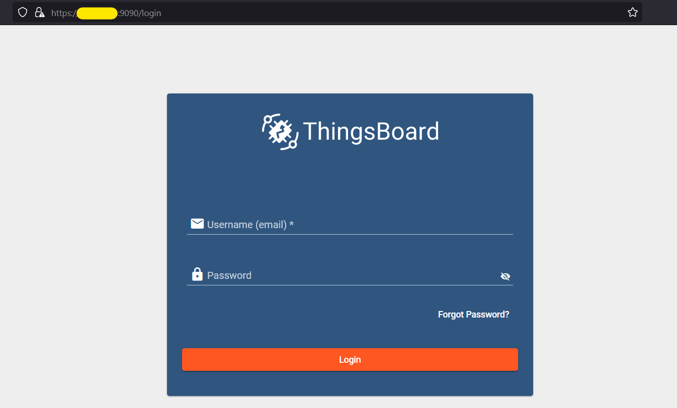

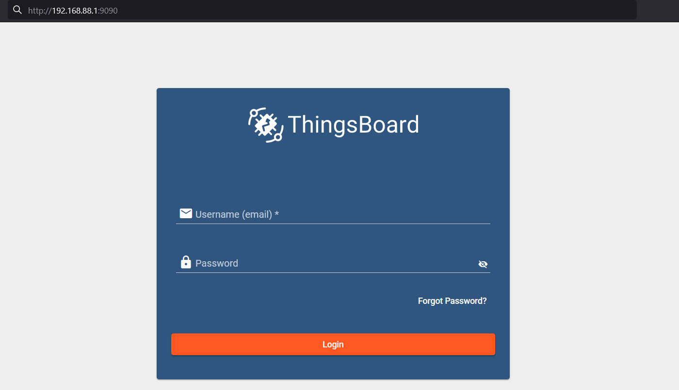

After the container is started and installed, access it using any browser, by going to → https://192.168.88.1:9090 (where the IP address is the address used in the DNAT rule):
By default, credentials are (Username/Password):
The login prompt should confirm that the server is running.

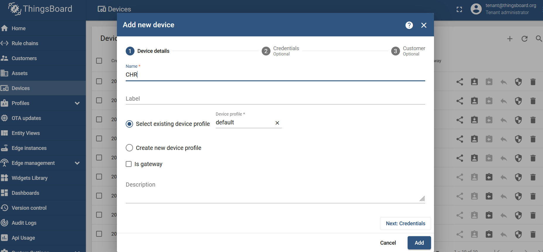

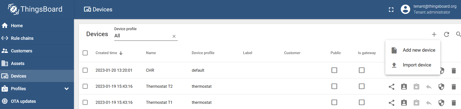

Log in with the tenant and create a new device. Go to the "Devices" menu, click on the "+" (Add Device) button and choose the "Add new device" option:
Name it, however you like, and click on "Add":

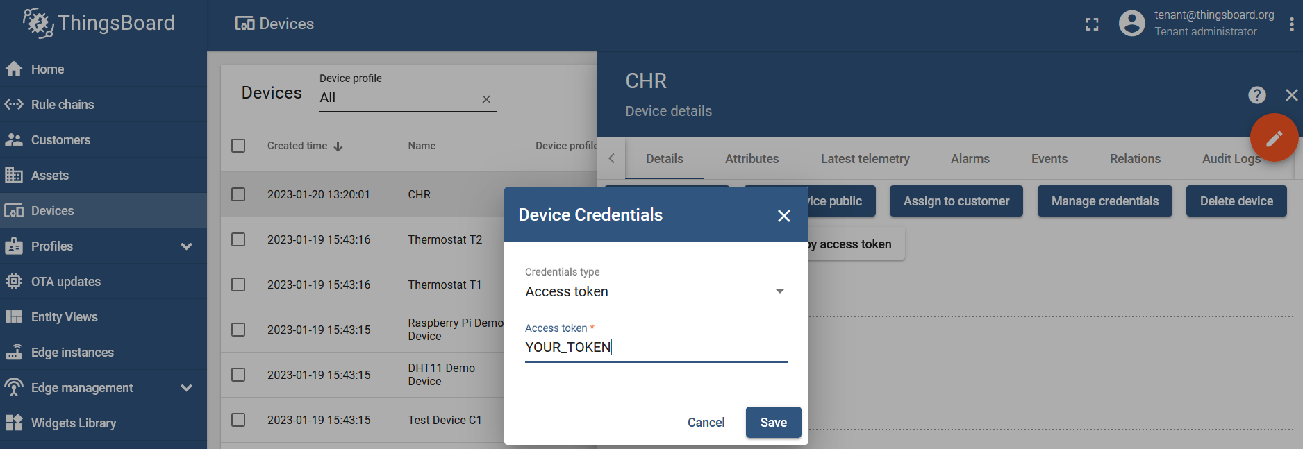

Check your device access token by clicking on the device you've just created and selecting the "Manage credentials" setting (copy the access token generated or type in your own → "YOUR_TOKEN"):
After these steps, go to the RouterOS settings (back to CHR settings) and create a new MQTT broker (make sure that you have the IoT package installed because otherwise, you will not have this menu):

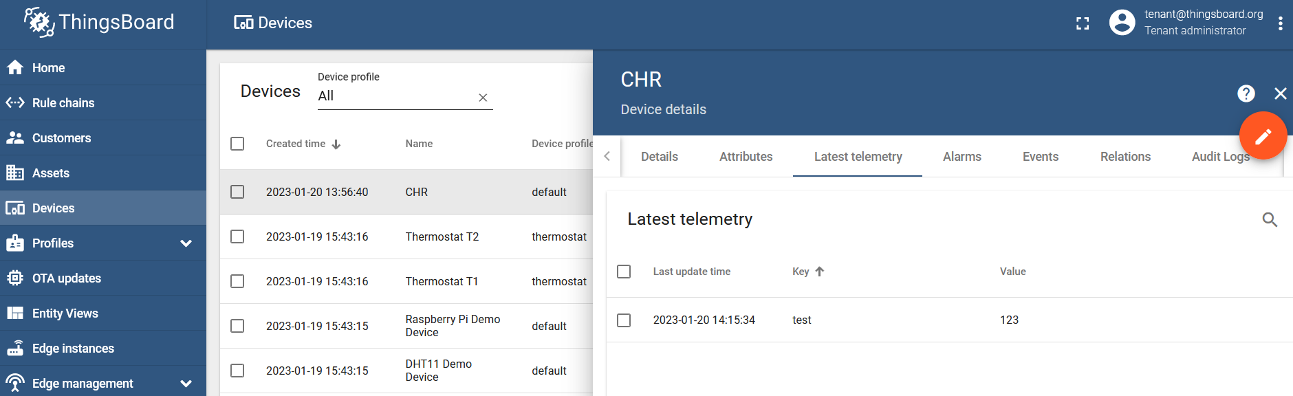

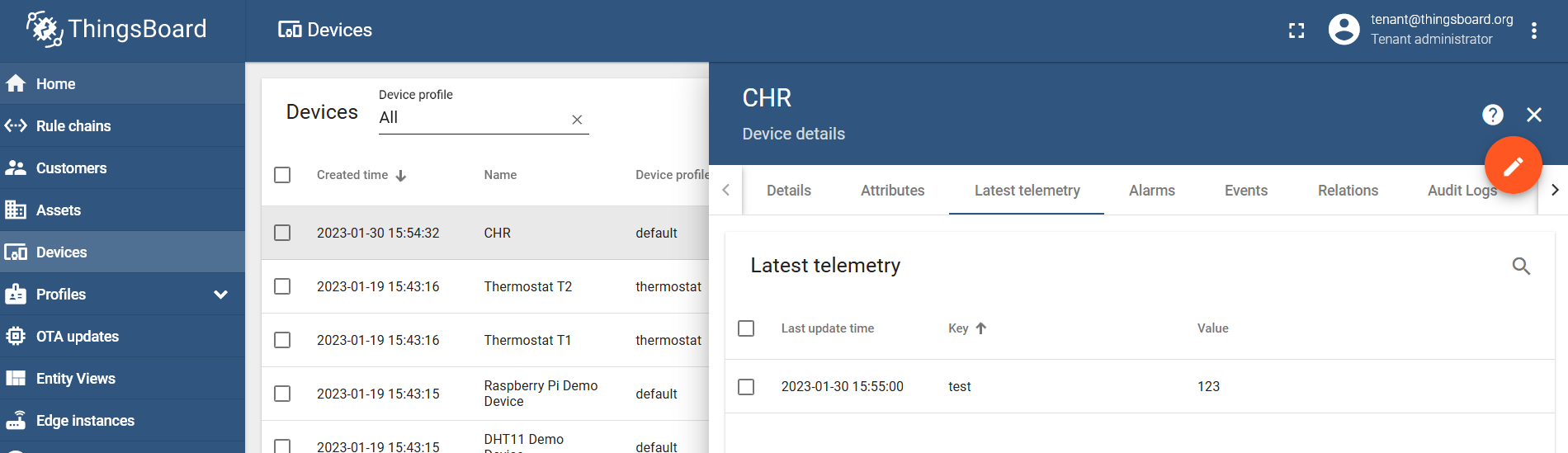

Publish a static test MQTT message in the JSON format:
/iot/mqtt/publish broker="tb" topic="v1/devices/me/telemetry" message="{\"test\":\"123\"}"
Confirm that the message was posted:

Confirm HTTPS access
Now, you should be able to access https://your_IP:9090 (where the IP address is the address used in the DNAT rule):
info
Since we are using a self-signed certificate that was not issued by a trusted authority, an error indicating that the connection is not secure might appear but you can view the certificate through the browser (confirm it is the one), accept the risk, and continue.

Add MQTT broker:
/iot/mqtt/brokers/add name=tbssl address=172.18.0.2 port=8883 username=YOUR_TOKEN ssl=yes
/iot/mqtt/publish broker="tbssl" topic="v1/devices/me/telemetry" message="{\"test\":\"123\"}"
Confirm that it was received by the MQTT broker:

Add MQTT broker, where the address is the IP address dst-address that is used in the TCP 8883 port-forwarding rule on the ThingsBoard-container router:
/iot/mqtt/brokers/add name=tbssl address=192.168.88.1 port=8883 username=YOUR_TOKEN ssl=yes
And confirm that the broker received it → under the "Latest Telemetry" section on ThingsBoard.
