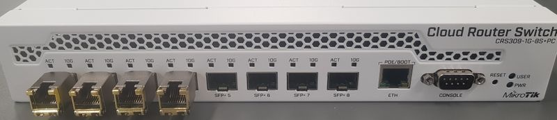

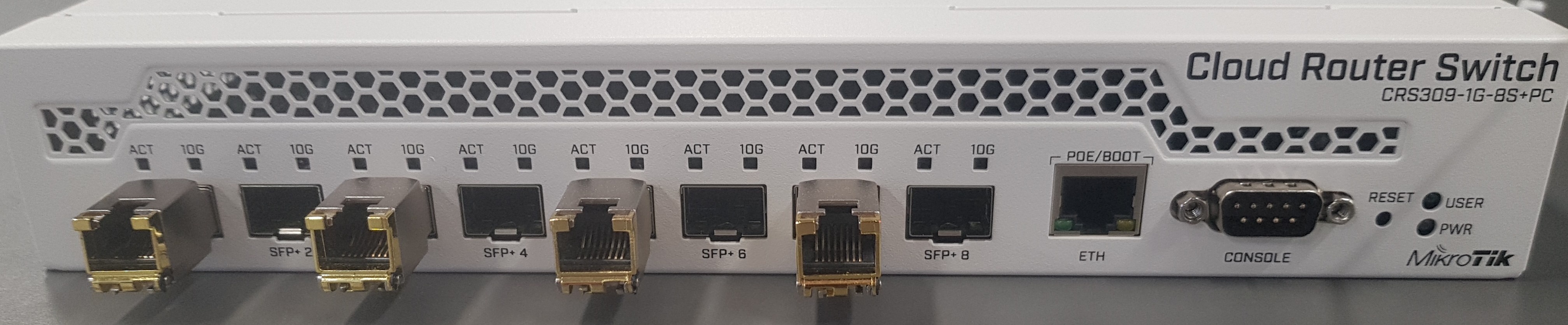

As mentioned, S+RJ10 heat up more than regular transceivers, and keeping them side by side can result in overheating, especially in devices with 4 linear SFP cages. It is recommended to place S+RJ10 in every second interface while keeping an optical transceiver or an empty port in between them.
Even when using devices that come with separated SFP+ cages, for example, CRS309-1G-8S+, it is still not recommended to deploy the S+RJ10 transceivers beside each other. Use S+RJ10 in every second interface to avoid transceiver overheating, which may cause unpredictable behavior.
Recommended S+RJ10 placementIt is not recommended to place transceivers side by side

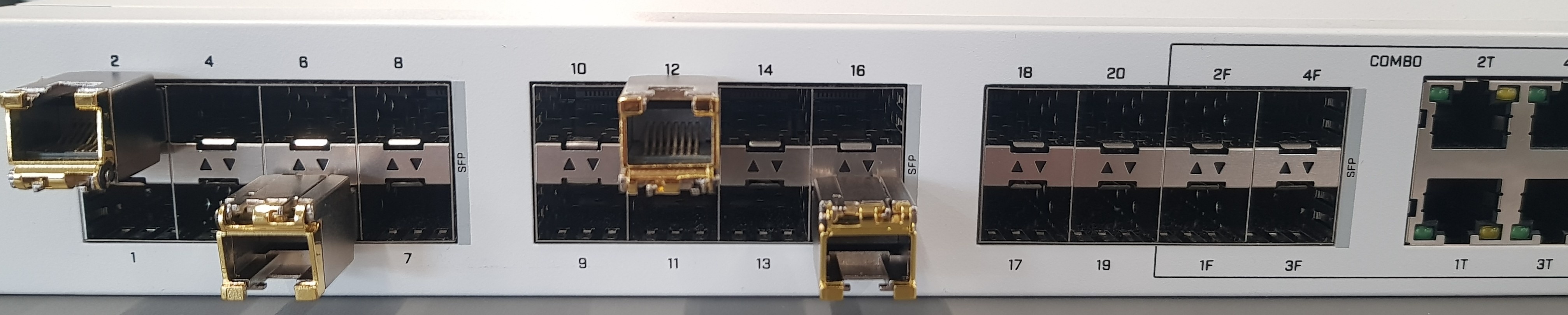

Devices that come with 4 or 8-block SFP+ cages are not exceptions. It is recommended to use one S+RJ10 transceiver per 4xSFP+ cage block and avoid placing them side by side. Keep at least one vertical row empty (without S+RJ10) after plugging the S+RJ10 transceiver.
Recommended S+RJ10 placementWe do not recommend placing transceivers side by side

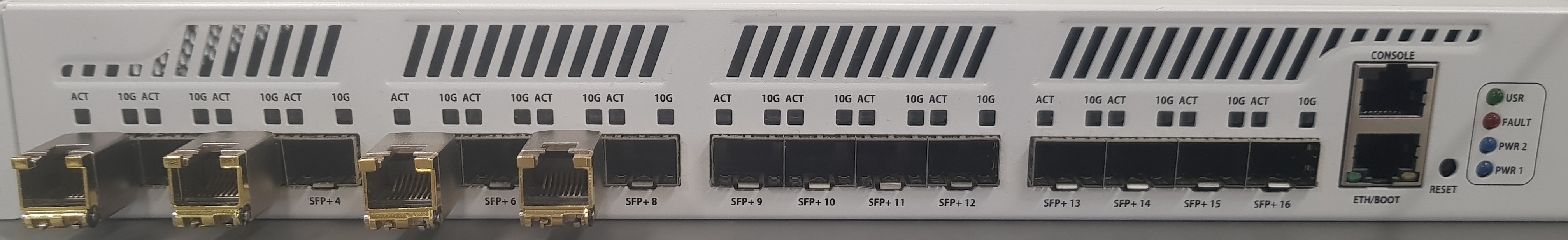

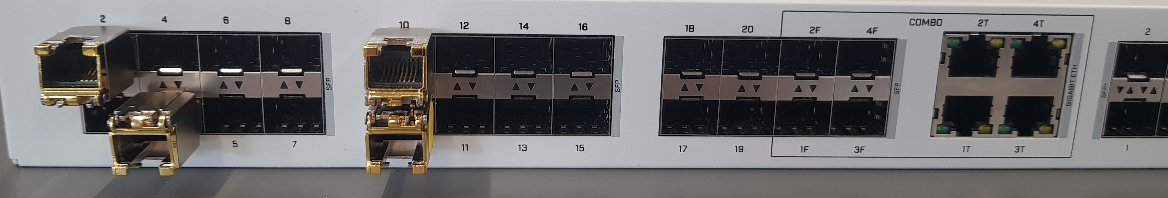

Using the S+RJ10 Side by Side or with passive cooling devices
There might be situations when it is not possible to use the recommended layout of the transceivers. In such cases where two or more S+RJ10 transceivers are plugged in beside one another or modules are used in passive cooling devices, the network administrator has to ensure additional cooling. The airflow around the device should be increased or the overall ambient temperature should be lowered to keep the temperature of the transceivers within the recommended range.
