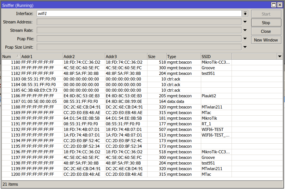

RouterOS embedded sniffer allows you to capture packets based on various protocols.
In the following example, we will configure the sniffer to match packets going through the ether1 interface:
[admin@MikroTik] > /tool/sniffer/start interface=ether1
[admin@MikroTik] > /tool/sniffer/stop
[admin@MikroTik] > /tool/sniffer/save file-name=/flash/test.pcap
