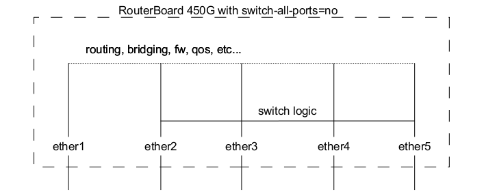

Switch All Ports Feature
Ether1 port on RB450G/RB435G/RB850Gx2 devices has a feature that allows it to be removed/added to the default switch group. This setting is available on the /interface/ethernet/switch menu. By default ether1 port will be included in the switch group.
Switch 4
PropertyDescription
switch-all-ports (no*| yes*; Default: yes)Changes the ether1 switch group only on RB450G/RB435G/RB850Gx2 devices.
  • yes - ether1 is part of the switch and supports switch grouping and all other advanced Atheros8316/Atheros8327 features including extended statistics (/interface/ethernet/print stats).
  • no - ether1 is not part of the switch, effectively making it a stand-alone ethernet port, this way increasing its throughput to other ports in bridged and routed mode, but removing the switching possibility on this port.

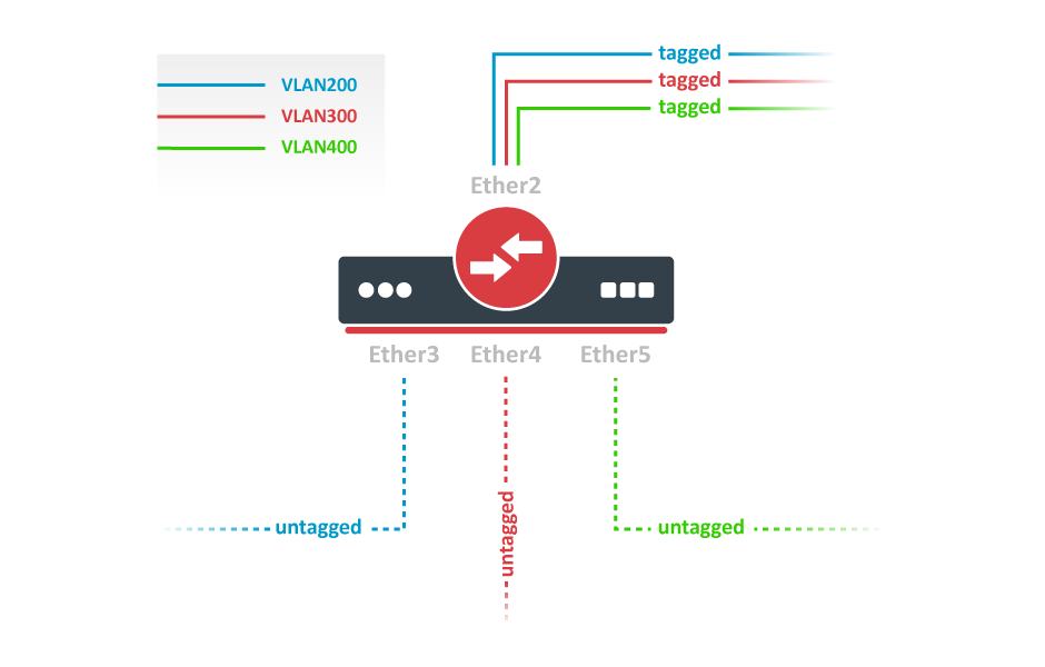

VLAN Table
The VLAN table specifies certain forwarding rules for packets that have a specific 802.1Q tag. Those rules are of higher priority than switch groups configured using the Bridge Hardware Offloading feature. Basically, the table contains entries that map specific VLAN tag IDs to a group of one or more ports. Packets with VLAN tags leave the switch chip through one or more ports that are set in the corresponding table entry. The exact logic that controls how packets with VLAN tags are treated is controlled by a vlan-mode parameter that is changeable per switch port.
VLAN ID based forwarding takes into account the MAC addresses dynamically learned or manually added in the host table. QCA8337 and Atheros8327 switch-chips also support Independent VLAN Learning (IVL) which does the learning based on both - MAC addresses and VLAN IDs, thus allowing the same MAC to be used in multiple VLANs.
Packets without a VLAN tag are treated just as if they had a VLAN tag with portdefault-vlan-id. If vlan-mode=check or vlan=mode=secure is configured, to forward packets without VLAN tags you have to add an entry to the VLAN table with the same VLAN ID according to the default-vlan-id.
PropertyDescription
disabled (no | yes; Default: no)Enables or disables switch VLAN entry.
independent-learning (no*| yes*; Default: yes)Whether to use shared-VLAN-learning (SVL) or independent-VLAN-learning (IVL).
ports (name; Default: none)Interface member list for the respective VLAN. This setting accepts comma-separated values. e.g. ports=ether1,ether2.
switch (name; Default: none)Name of the switch for which the respective VLAN entry is intended.
vlan-id (integer: 0..4095; Default:)The VLAN ID for certain switch port configurations.

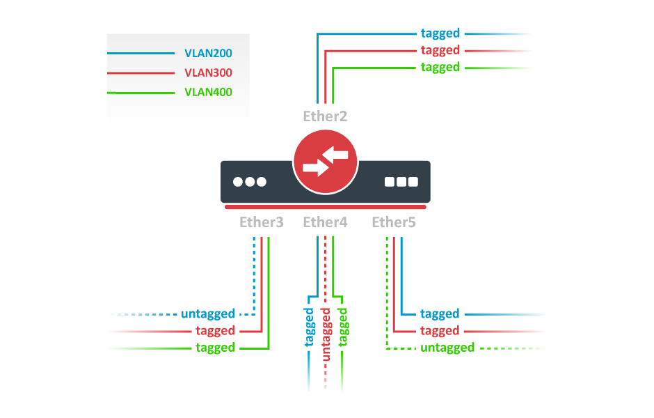

Both vlan-mode and vlan-header along with the VLAN Table can be used to configure VLAN tagging, untagging and filtering. Multiple combinations are possible, each achieving a different result. Below you can find a table of what kind of traffic is going to be sent out through an egress port when certain traffic is received on an ingress port for each VLAN Mode.
NOTES:
  • L - vlan-header is set to leave-as-is
  • S - vlan-header is set to always-strip
  • A - vlan-header is set to add-if-missing
  • U - Untagged traffic is sent out
  • T - Tagged traffic is sent out, a tag is already present on the ingress port
  • TA - Tagged traffic is sent out, a tag was added on the ingress port
  • DI - Traffic is dropped on ingress port because of the mode selected in vlan-mode
  • DE - Traffic is dropped on egress port because the egress port was not found in the VLAN Table
  • VID match - VLAN ID from the VLAN tag for ingress traffic is present in the VLAN Table
  • Port match - Ingress port is present in the VLAN Table for the appropriate VLAN ID
VLAN Mode = disabledEgress port is not present in VLAN TableEgress port is present in VLAN Table
LSALSA
Untagged trafficUUTAUUTA
Tagged traffic; no VID matchTUT
Tagged traffic; VID match; no Port matchTUTTUT
Tagged traffic; VID match; Port matchTUTTUT
VLAN Mode = fallbackEgress port is not present in VLAN TableEgress port is present in VLAN Table
LSALSA
Tagged traffic; VID match; no Port matchDEDEDETUT
Tagged traffic; VID match; Port matchDEDEDETUT
VLAN Mode = checkEgress port is not present in VLAN TableEgress port is present in VLAN Table
LSALSA
Untagged traffic
Tagged traffic; no VID matchDIDIDI
VLAN Mode = secureEgress port is not present in VLAN TableEgress port is present in VLAN Table
LSALSA
Untagged traffic
Tagged traffic; VID match; no Port matchDIDIDIDIDIDI

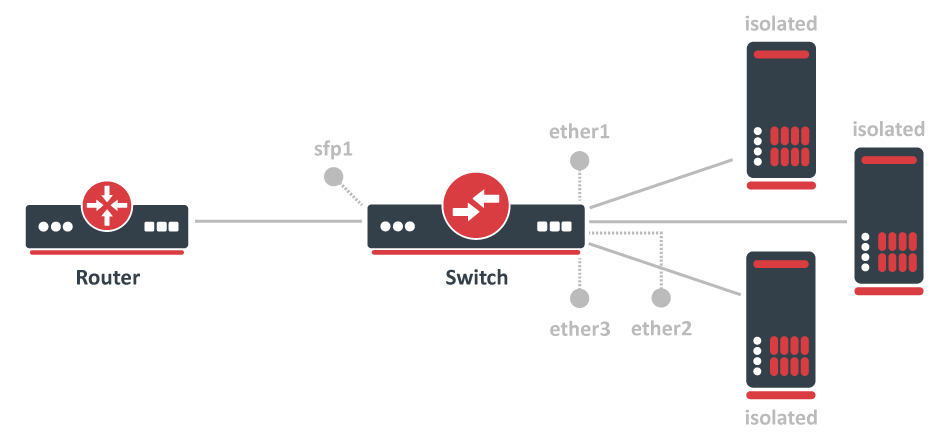

In some scenarios, you might need to forward all traffic to an uplink port while all other ports are isolated from each other. This kind of setup is called Private VLAN configuration. The Switch will forward all Ethernet frames directly to the uplink port allowing the Router to filter unwanted packets and limit access between devices that are behind switch ports.
Port Isolation
To configure switch port isolation, you need to switch all required ports:
/interface/bridge
add name=bridge1
/interface/bridge/port
add interface=sfp1 bridge=bridge1 hw=yes
add interface=ether1 bridge=bridge1 hw=yes
add interface=ether2 bridge=bridge1 hw=yes
add interface=ether3 bridge=bridge1 hw=yes
warning
By default, the bridge interface is configured with protocol-mode set to rstp. For some devices, this can disable hardware offloading because specific switch chips do not support this feature. See the Bridge Hardware Offloading section with supported features.
Override the egress port for each switch port that needs to be isolated (excluding the uplink port):
/interface/ethernet/switch/port-isolation
set ether1 forwarding-override=sfp1
set ether2 forwarding-override=sfp1
set ether3 forwarding-override=sfp1
warning
It is possible to set multiple uplink ports for a single switch chip, this can be done by specifying multiple interfaces and separating them with a comma.

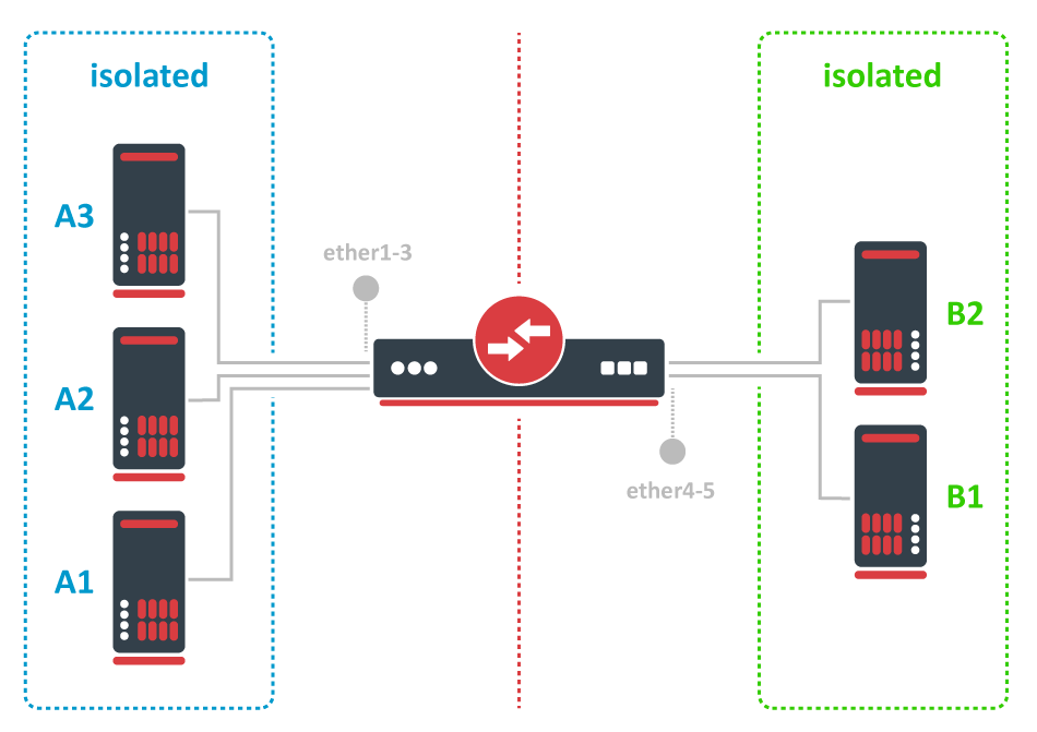

Isolated switch groups
In some scenarios you might need to isolate a group of devices from other groups. This can be done using the switch port isolation feature. This is useful when you have multiple networks but you want to use a single switch. With port isolation you can allow certain switch ports to be able to communicate through only a set of switch ports. In this example, devices on ether1-3 will only be able to communicate with devices that are on ether1-3, while devices on ether4-5 will only be able to communicate with devices on ether4-5 (ether1-3 is not able to communicate with ether4-5).
warning
Port isolation is only available between ports that are members of the same switch.
Port Isolation 2
To configure isolated switch groups you must first switch all ports:
/interface/bridge
add name=bridge
add bridge=bridge1 interface=ether1 hw=yes
add bridge=bridge1 interface=ether2 hw=yes
add bridge=bridge1 interface=ether3 hw=yes
add bridge=bridge1 interface=ether4 hw=yes
add bridge=bridge1 interface=ether5 hw=yes
warning
Then specify in the forwarding-override property all ports that you want to be in the same isolated switch group (except the port on which you are applying the property), for example, to create an isolated switch group for A devices:
set ether1 forwarding-override=ether2,ether3
set ether2 forwarding-override=ether1,ether3
set ether3 forwarding-override=ether1,ether2
To create an isolated switch group for B devices:
set ether4 forwarding-override=ether5
set ether5 forwarding-override=ether4

It is possible to use the built-in switch chip and the CPU at the same time to create a Switch-Router setup, where a device acts as a switch and as a router at the same time. You can find a configuration example in the Switch-Router guide.
caution
When allowing access to the CPU, you are allowing access from a certain port to the actual router/switch. This is not always desirable. Make sure you implement proper firewall filter rules to secure your device when access to the CPU is allowed from a certain VLAN ID and port. Use firewall filter rules to allow access to only certain services.

VLAN Example 1 (Trunk and Access Ports)
RouterBOARDs with Atheros switch chips can be used for 802.1Q Trunking. This feature in RouterOS v6 is supported by QCA8337, Atheros8316, Atheros8327, Atheros8227 and Atheros7240 switch chips. In this example, ether3, ether4, and ether5 interfaces are access ports, while ether2 is a trunk port. VLAN IDs for each access port: ether3 - 200, ether4 - 300, ether5 - 400.
Access Ports
Switch together the required ports:
/interface/bridge
add name=bridge1
warning
Add VLAN table entries to allow frames with specific VLAN IDs between ports:
/interface/ethernet/switch/vlan
add ports=ether2,ether3 switch=switch1 vlan-id=200
add ports=ether2,ether4 switch=switch1 vlan-id=300
add ports=ether2,ether5 switch=switch1 vlan-id=400
Assign vlan-mode and vlan-header mode for each port and also default-vlan-id on ingress for each access port:
set ether2 vlan-mode=secure vlan-header=add-if-missing
set ether3 vlan-mode=secure vlan-header=always-strip default-vlan-id=200
set ether4 vlan-mode=secure vlan-header=always-strip default-vlan-id=300
set ether5 vlan-mode=secure vlan-header=always-strip default-vlan-id=400
  • Setting vlan-mode=secure ensures strict use of the VLAN table.
  • Setting vlan-header=always-strip for access ports removes the VLAN header from the frame when it leaves the switch chip.
  • Setting vlan-header=add-if-missing for trunk port adds VLAN header to untagged frames.
  • default-vlan-id specifies what VLAN ID is added for untagged ingress traffic of the access port.
warning
On QCA8337 and Atheros8327 switch chips, a default vlan-header=leave-as-is property should be used. The switch chip will determine which ports are access ports by using the default-vlan-id property. The default-vlan-id should only be used on access/hybrid ports to specify which VLAN the untagged ingress traffic is assigned to.
VLAN Example 2 (Trunk and Hybrid Ports)
VLAN Hybrid ports can forward both tagged and untagged traffic. This configuration is supported only by some Gigabit switch chips (QCA8337, Atheros8327).
Hybrid Ports
/interface/bridge
add name=bridge1
warning
Add VLAN table entries to allow frames with specific VLAN IDs between ports.
add ports=ether2,ether3,ether4,ether5 switch=switch1 vlan-id=200
add ports=ether2,ether3,ether4,ether5 switch=switch1 vlan-id=300
add ports=ether2,ether3,ether4,ether5 switch=switch1 vlan-id=400
In the switch port menu set vlan-mode on all ports and also default-vlan-id on planned hybrid ports:
set ether2 vlan-mode=secure vlan-header=leave-as-is
set ether3 vlan-mode=secure vlan-header=leave-as-is default-vlan-id=200
set ether4 vlan-mode=secure vlan-header=leave-as-is default-vlan-id=300
set ether5 vlan-mode=secure vlan-header=leave-as-is default-vlan-id=400
  • vlan-mode=secure will ensure strict use of the VLAN table.
  • default-vlan-id will define VLAN for untagged ingress traffic on the port.
  • In QCA8337 and Atheros8327 chips when vlan-mode=secure is used, it ignores switch port vlan-header options. VLAN table entries handle all the egress tagging/untagging and work as vlan-header=leave-as-is on all ports. It means what comes in tagged, goes out tagged as well, only default-vlan-id frames are untagged at the egress port.

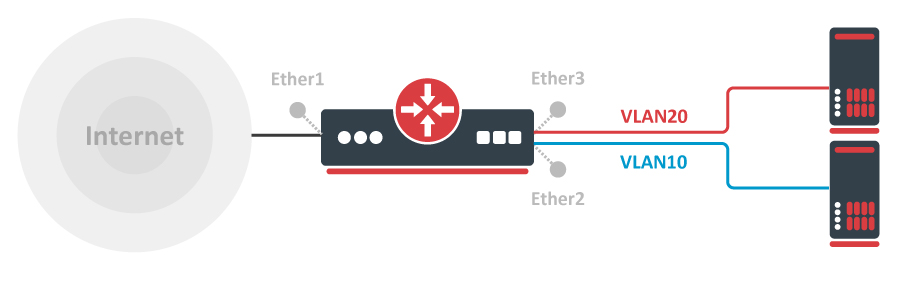

Inter-VLAN routing
Many MikroTik devices come with a built-in switch chip that can be used to greatly improve overall throughput when configured properly. Devices with a switch chip can be used as a router and a switch at the same time. This gives you the possibility to use a single device instead of multiple devices for your network.
Switch Router
For this type of setup to work, you must switch all required ports together
/interface/bridge
add name=bridge1
Create a VLAN interface for each VLAN ID and assign an IP address to it:
/interface/vlan
add interface=bridge1 name=VLAN10 vlan-id=10
add interface=bridge1 name=VLAN20 vlan-id=20
/ip/address
add address=192.168.10.1/24 interface=VLAN10
add address=192.168.20.1/24 interface=VLAN20
Setup a DHCP Server for each VLAN:
/ip/pool
add name=POOL10 ranges=192.168.10.100-192.168.10.200
add name=POOL20 ranges=192.168.20.100-192.168.20.200
/ip/dhcp-server
add address-pool=POOL10 disabled=no interface=VLAN10 name=DHCP10
add address-pool=POOL20 disabled=no interface=VLAN20 name=DHCP20
/ip/dhcp-server/network
add address=192.168.10.0/24 dns-server=8.8.8.8 gateway=192.168.10.1
add address=192.168.20.0/24 dns-server=8.8.8.8 gateway=192.168.20.1
Enable NAT on the device:
/ip/firewall/nat
add action=masquerade chain=srcnat out-interface=ether1
Add each port to the VLAN table and allow these ports to access the CPU to make DHCP and routing work:
add independent-learning=yes ports=ether2,switch1-cpu switch=switch1 vlan-id=10
add independent-learning=yes ports=ether3,switch1-cpu switch=switch1 vlan-id=20
Specify each port to be an access port, and enable secure VLAN mode on each port and on the switch1-cpu port:
set ether2 default-vlan-id=10 vlan-header=always-strip vlan-mode=secure
set ether3 default-vlan-id=20 vlan-header=always-strip vlan-mode=secure
set switch1-cpu vlan-mode=secure
warning
If your device has a switch rule table, then you can limit access between VLANs on a hardware level. As soon as you add an IP address on the VLAN interface, you enable inter-VLAN routing, but this can be limited on a hardware level while preserving DHCP Server and other router-related services. To do so, use these ACL rules. With this type of configuration, you can achieve isolated port groups using VLANs.
/interface/ethernet/switch/rule
add dst-address=192.168.20.0/24 new-dst-ports="" ports=ether2 switch=switch1
add dst-address=192.168.10.0/24 new-dst-ports="" ports=ether3 switch=switch1
