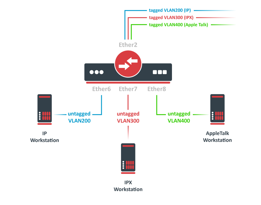

Specify the VLAN ID that the switch must set on untagged (VLAN0) traffic for each access port:
/interface/ethernet/switch/ingress-vlan-translation
add ports=ether6 customer-vid=0 new-customer-vid=200
add ports=ether7 customer-vid=0 new-customer-vid=300
add ports=ether8 customer-vid=0 new-customer-vid=400
When an entry is created under /interface/ethernet/switch/ingress-vlan-translation, the switch chip will add a VLAN tag on ingress frames on the specified port. To remove the VLAN tag on the same port for egress frames, an /interface/ethernet/switch/egress-vlan-tag entry should be created for the same VLAN ID where only tagged ports are specified. If a specific VLAN is forwarded only between access ports, the /interface/ethernet/switch/egress-vlan-tag entry should still be created without any tagged ports. Another option is to create extra entries under the /interface/ethernet/switch/egress-vlan-translation menu to set untagged (VLAN0) traffic.
You must also specify which VLANs should be sent out to the trunk port with a VLAN tag. Use the tagged-ports property to set up a trunk port:
add tagged-ports=ether2 vlan-id=200
add tagged-ports=ether2 vlan-id=300
add tagged-ports=ether2 vlan-id=400
Add entries to the VLAN table to specify VLAN memberships for each port and each VLAN ID:
/interface/ethernet/switch/vlan
add ports=ether2,ether6 vlan-id=200
add ports=ether2,ether7 vlan-id=300
add ports=ether2,ether8 vlan-id=400
After a valid VLAN configuration has been set up, you can enable unknown/invalid VLAN filtering:
set drop-if-invalid-or-src-port-not-member-of-vlan-on-ports=ether2,ether6,ether7,ether8
It is possible to use the built-in switch chip and the CPU at the same time to create a Switch-Router setup, where a device acts as a switch and as a router simultaneously.
Example 2 (Trunk and Hybrid Ports)
Switch together the required ports:
/interface/bridge
add name=bridge1
/interface/bridge/port
add bridge=bridge1 interface=ether2 hw=yes
add bridge=bridge1 interface=ether6 hw=yes
add bridge=bridge1 interface=ether7 hw=yes
add bridge=bridge1 interface=ether8 hw=yes
By specifying ports as tagged-ports, the switch will always send out packets as tagged packets with the corresponding VLAN ID. Add appropriate entries according to the diagram above:
add tagged-ports=ether2,ether7,ether8 vlan-id=200
add tagged-ports=ether2,ether6,ether8 vlan-id=300
add tagged-ports=ether2,ether6,ether7 vlan-id=400
add ports=ether2,ether6,ether7,ether8 vlan-id=200 learn=yes
add ports=ether2,ether6,ether7,ether8 vlan-id=300 learn=yes
add ports=ether2,ether6,ether7,ether8 vlan-id=400 learn=yes

Set VLAN for IP and ARP protocols:
/interface/ethernet/switch/protocol-based-vlan
add port=ether2 protocol= set-customer-vid-for=all new-customer-vid=0
add port=ether6 protocol= set-customer-vid-for=all new-customer-vid=200
Set VLAN for IPX protocol:
add port=ether2 protocol=ipx set-customer-vid-for=all new-customer-vid=0
add port=ether7 protocol=ipx set-customer-vid-for=all new-customer-vid=300
Set VLAN for AppleTalk AARP and AppleTalk DDP protocols:
add port=ether2 protocol=0x80F3 set-customer-vid-for=all new-customer-vid=0
add port=ether8 protocol=0x80F3 set-customer-vid-for=all new-customer-vid=400
add port=ether2 protocol=0x809B set-customer-vid-for=all new-customer-vid=0
add port=ether8 protocol=0x809B set-customer-vid-for=all new-customer-vid=400

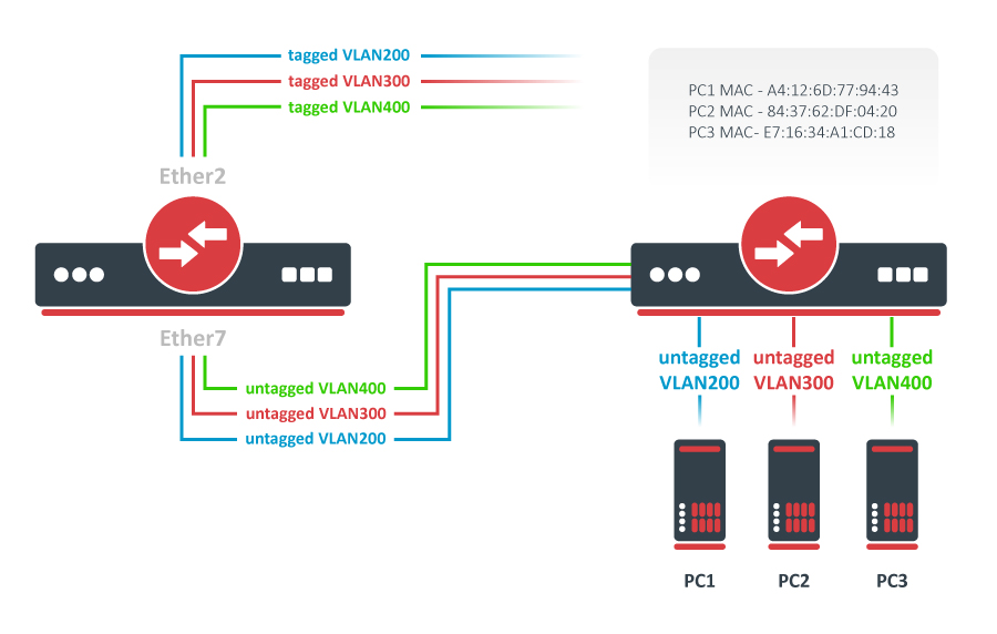

MAC Based VLAN
Internally, all MAC addresses in MAC-based VLANs are hashed. Certain MAC addresses can have the same hash, which will prevent a MAC address from being loaded into the switch chip if the hash matches with a hash from a MAC address that has been already loaded, for this reason, it is recommended to use Port-based VLANs in combination with MAC-based VLANs. This is a hardware limitation.
/interface/bridge
add name=bridge1
Enable MAC-based VLAN translation on an access port:
/interface/ethernet/switch/port
set ether7 allow-fdb-based-vlan-translate=yes
Add MAC-to-VLAN mapping entries in the MAC-based VLAN table:
/interface/ethernet/switch/mac-based-vlan
add src-mac=A4:12:6D:77:94:43 new-customer-vid=200
add src-mac=84:37:62:DF:04:20 new-customer-vid=300
add src-mac=E7:16:34:A1:CD:18 new-customer-vid=400
Add VLAN200, VLAN300, and VLAN400 tagging on the ether2 port to create it as a VLAN trunk port:
Additionally, add entries to the VLAN table, specify VLAN membership for each port, and enable unknown/invalid VLAN filtering, see an example below - Unknown/Invalid VLAN filtering. This is required for network setups where more interfaces are added to the bridge, as it allows defining VLAN boundaries.

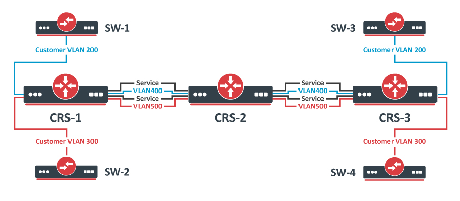

VLAN Tunneling (Q-in-Q)
This example covers a typical VLAN tunneling use case where service provider devices add another VLAN tag for independent forwarding while allowing customers to use their own VLANs.
This example contains only the Service VLAN tagging part. It is recommended to additionally set Unknown/Invalid VLAN filtering configuration on ports.
CRS-1: The first switch on the edge of the service provider network has to properly identify traffic from the customer VLAN ID on port and assign a new service VLAN ID with ingress VLAN translation rules. VLAN trunk port configuration for service provider VLAN tags is in the same egress-vlan-tag table. The main difference from basic Port-Based VLAN configuration is that the CRS switch-chip has to be set to do forwarding according to service (outer) VLAN ID instead of customer (inner) VLAN ID.
/interface/bridge
add name=bridge1
add bridge=bridge1 interface=ether1 hw=yes
add bridge=bridge1 interface=ether9 hw=yes
add customer-vid=200 new-service-vid=400 ports=ether1
add customer-vid=300 new-service-vid=500 ports=ether2
add tagged-ports=ether9 vlan-id=400
add tagged-ports=ether9 vlan-id=500
set bridge-type=service-vid-used-as-lookup-vid
CRS-2: The second switch in the service provider network requires only switched ports to do forwarding according to the service (outer) VLAN ID instead of the customer (inner) VLAN ID.
/interface/bridge
add name=bridge1
add bridge=bridge1 interface=ether10 hw=yes
CRS-3: The third switch has a similar configuration to CRS-1:
- Ports in a switch group using a bridge.
- Ingress VLAN translation rules to define new service VLAN assignments on ports.
- tagged-ports for service provider VLAN trunks.
- CRS switch-chip set to use service VLAN ID in switching lookup.
/interface/bridge
add name=bridge1
add bridge=bridge1 interface=ether3 hw=yes
add bridge=bridge1 interface=ether4 hw=yes
add customer-vid=200 new-service-vid=400 ports=ether3
add customer-vid=300 new-service-vid=500 ports=ether4
add tagged-ports=ether10 vlan-id=400
add tagged-ports=ether10 vlan-id=500

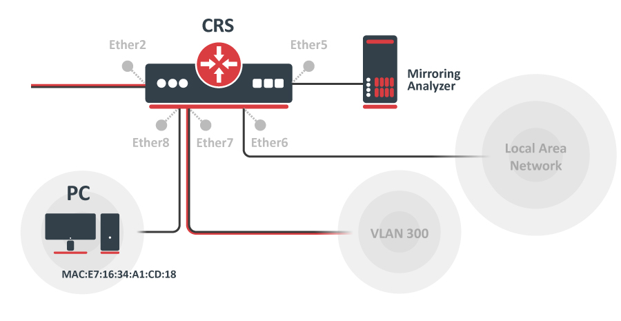

Mirroring
The Cloud Router Switches support three types of mirroring. Port-based mirroring can be applied to any switch-chip ports, VLAN-based mirroring works for all specified VLANs regardless of switch-chip ports, and MAC-based mirroring copies traffic sent or received from a specific device reachable from the port configured in the Unicast Forwarding Database.
Port-Based Mirroring
The first configuration sets the ether5 port as a mirror0 analyzer port for both ingress and egress mirroring. Mirrored traffic will be sent to this port. Port-based ingress and egress mirroring are enabled from the ether6 port.
set ingress-mirror0=ether5 egress-mirror0=ether5
set ether6 ingress-mirror-to=mirror0 egress-mirror-to=mirror0
VLAN Based Mirroring
The second example requires ports to be switched in a group. Mirroring configuration sets the ether5 port as a mirror0 analyzer port and sets the mirror0 port to be used when mirroring from VLAN occurs. VLAN table entry enables mirroring only for VLAN 300 traffic between ether2 and ether7 ports.
/interface/bridge
add name=bridge1
set ingress-mirror0=ether5 vlan-uses=mirror0
add ports=ether2,ether7 vlan-id=300 learn=yes ingress-mirror=yes
MAC Based Mirroring
The third configuration also requires ports to be switched as a group. Mirroring configuration sets the ether5 port as a mirror0 analyzer port and sets the mirror0 port to be used when mirroring from the Unicast Forwarding database occurs. The entry from the Unicast Forwarding database enables mirroring for packets with source or destination MAC address E7:16:34:A1:CD:18 from ether8 port.
/interface/bridge
add name=bridge1
set ingress-mirror0=ether5 fdb-uses=mirror0
/interface/ethernet/switch/unicast-fdb
add port=ether8 mirror=yes svl=yes mac-address=E7:16:34:A1:CD:18

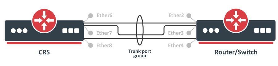

Trunking
Trunking in the Cloud Router Switches provides static link aggregation groups with hardware automatic failover and load balancing. The IEEE802.3ad and IEEE802.1ax compatible Link Aggregation Control Protocol is not supported yet. Up to 8 Trunk groups are supported with up to 8 Trunk member ports per Trunk group.
Configuration requires a group of switched ports and an entry in the Trunk table:
/interface/bridge
add name=bridge1 protocol-mode=none
/interface/ethernet/switch/trunk
add name=trunk1 member-ports=ether6,ether7,ether8
This example also shows proper bonding configuration in RouterOS on the other end:
/interface/bonding
add name=bonding1 slaves=ether2,ether3,ether4 mode=balance-xor transmit-hash-policy=layer-2-and-3
Bridge (R)STP is not aware of the underlying switch trunking configuration and some trunk ports can move to a discarding or blocking state. When trunking member ports are connected to other bridges, you should either disable the (R)STP or filter out any BPDU between trunked devices (e.g. with ACL rules).

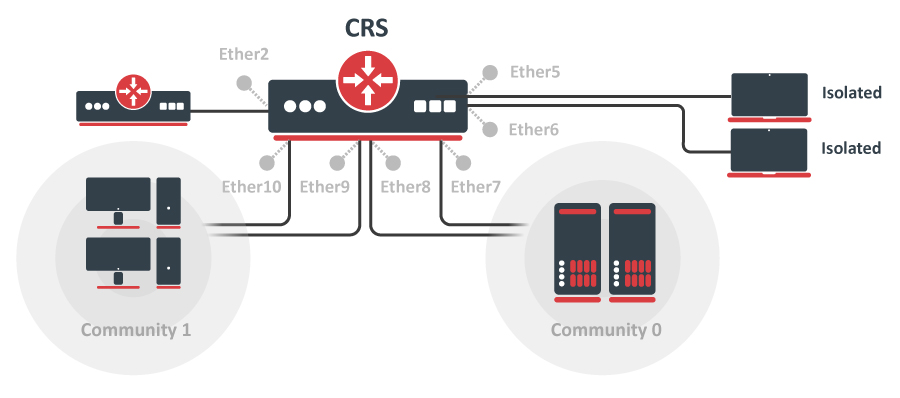

Port Level Isolation
Port-level isolation is often used for Private VLAN, where:
- One or multiple uplink ports are shared among all users for accessing the gateway or router.
- Port group Isolated Ports is for guest users. Communication is through the uplink ports only.
- Port group Community 0 is for department A. Communication is allowed between the group members and through uplink ports.
- Port group Community X is for department X. Communication is allowed between the group members and through uplink ports.
The Cloud Router Switches use port-level isolation profiles for Private VLAN implementation:
- Uplink ports – port-level isolation profile 0
- Isolated ports – port-level isolation profile 1
- Community 0 ports - port-level isolation profile 2
- Community X (X <= 30) ports - port-level isolation profile X
This example requires a group of switched ports. Assume that all ports used in this example are in one switch group.
/interface/bridge
add name=bridge1
The first part of port isolation configuration is setting the Uplink port – set a port profile to 0 for ether2:
set ether2 isolation-leakage-profile-override=0
Then continue with setting isolation profile 1 on all isolated ports and adding the communication port for port isolation profile 1:
set ether5 isolation-leakage-profile-override=1
set ether6 isolation-leakage-profile-override=1
/interface/ethernet/switch/port-isolation
add port-profile=1 ports=ether2 type=dst
Configuration to set Community 2 and Community 3 ports is similar:
set ether7 isolation-leakage-profile-override=2
set ether8 isolation-leakage-profile-override=2
add port-profile=2 ports=ether2,ether7,ether8 type=dst
set ether9 isolation-leakage-profile-override=3
set ether10 isolation-leakage-profile-override=3
add port-profile=3 ports=ether2,ether9,ether10 type=dst

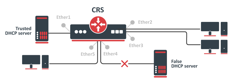

Protocol Level Isolation
Protocol level isolation on CRS switches can be used to enhance network security. For example, restricting DHCP traffic between the users (ether2, ether3, ether4, ether5) and allowing it only to trusted DHCP server ports (ether1) can prevent security risks like DHCP spoofing attacks. The following example shows how to configure it on CRS.
/interface/bridge
add name=bridge1
add bridge=bridge1 interface=ether5 hw=yes
Set the same Community port profile for all DHCP client ports. Community port profile numbers are from 2 to 30.
set ether2 isolation-leakage-profile-override=2
set ether3 isolation-leakage-profile-override=2
set ether4 isolation-leakage-profile-override=2
set ether5 isolation-leakage-profile-override=2
And configure port isolation/leakage profile for selected Community (2) to allow DHCP traffic destined only to the port where the trusted DHCP server is located. Registration status and traffic-type properties have to be set empty to apply restrictions only for DHCP protocol.
add port-profile=2 protocol-type=dhcpv4 type=dst forwarding-type=bridged ports=ether1 registration-status="" traffic-type=""
