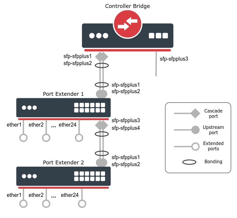

| Bonding for cascade and upstream ports | + |

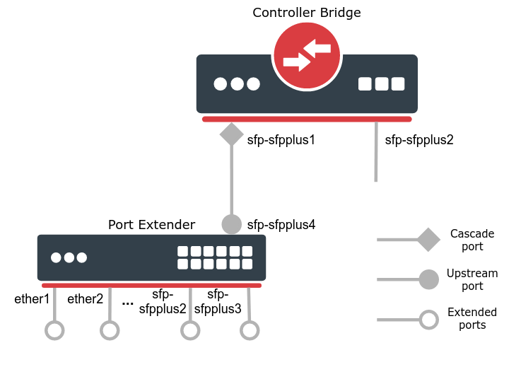

In this example, we will create a Controlling Bridge (e.g. a CRS317-1G-16S+ switch) that will connect to a single Port Extender (e.g. a CRS326-24G-2S+ switch) through an SFP+1 interface.
First, configure a bridge with enabled VLAN filtering on a CB device:
/interface/bridge
add name=bridge1 vlan-filtering=yes
On the same device, configure a port that is connected to the PE device and will act as a cascade port:
/interface/bridge/port-controller
set bridge=bridge1 cascade-ports=sfp-sfpplus1 switch=switch1
Last, on a PE device, simply configure a control port, which will be selected as an upstream port:
/interface/bridge/port-extender
set control-ports=sfp-sfpplus1 switch=switch1
Once PE and CB devices are connected, all interfaces that are on the same switch group (except for control ports) will be extended and can be further configured on a CB device. An automatic bridge port configuration will be applied on the CB device which adds all extended ports in a single bridge. This configuration can be modified afterward.
In order to exclude a port from being extended (e.g. for out-of-band management purposes), additionally, configure the excluded-ports property.
Make sure not to include the cascade-ports and control-ports in any routing or bridging configurations. These ports are recommended only for CB and PE usage.

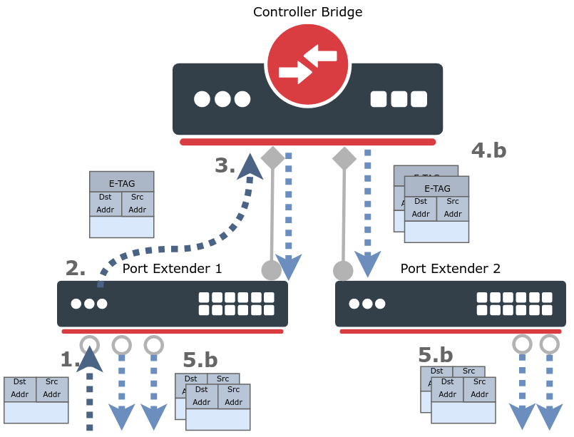

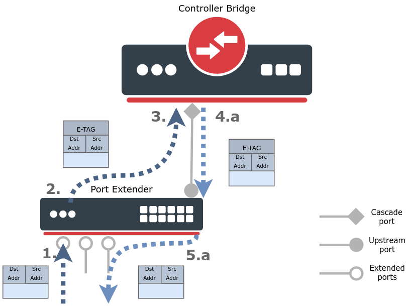

To better understand the underlying principles of Controlling Bridge and Port Extender, a packet walkthrough is provided below:
- An L2 packet is received on the extended port.
- The Port Extender encapsulates the packet with an E-TAG header (EtherType 0x893F) and forwards it through an upstream port, towards the Controller Bridge. An E-TAG packet contains information regarding the PE source port ID. The PE device does not make any local switching decisions.
- The Controller Bridge receives the E-TAG packet and knows exactly which extended interface received it. The CB then internally decapsulates the packet and processes it through a regular switching decision (host learning, destination address lookup, VLAN filtering, etc.).
- Once a switching decision is made, the CB will again encapsulate the original packet with an E-TAG and send it through a cascade port, towards Port Extender.
- For a single destination packet (unicast), the CB will include the PE destination port ID in the E-TAG and send it through a correct cascade port.
- For a multi-destination packet (broadcast, multicast or unknown-unicast), the CB will include a target group mark and source port ID in the E-TAG and send a single packet replica per cascade port.
- Once a PE device receives an E-TAG packet on the upstream port, PE decapsulates it and sends the original L2 packet through the extended port.
- For a single destination packet (unicast), the PE will send the packet only to the correct extended port.
- For a multi-destination packet (broadcast, multicast or unknown-unicast), the PE will send a single packet replica per extended port (except for the source port where the packet was received).

| cascade-ports (interfaces; Default: none) | Interfaces that will act as cascade ports. A bonding interface with 802.3ad or balance-xor mode is also supported. |

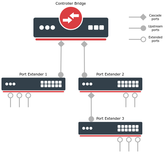

After CB and PE devices are configured and connected, each PE device will be automatically visible on the device menu. Use print and monitor commands to see more details.
[admin@Controller] > /interface/bridge/port-controller/device/print
Flags: I - inactive
0 name="pe1" pe-mac=64:D1:54:EB:AE:BC descr="MikroTik RouterOS 6.48beta35 (testing) CRS328-24P-4S+" control-ports=pe1-sfpplus1,pe1-sfpplus2
1 name="pe2" pe-mac=64:D1:54:C7:3A:58 descr="MikroTik RouterOS 6.48beta35 (testing) CRS326-24G-2S+" control-ports=pe2-sfpplus1
[admin@Controller] > /interface/bridge/port-controller/device/monitor pe2
status: active
connected-via-ports: sfp-sfpplus1==pe1-sfpplus1,pe1-sfpplus2==pe2-sfpplus1
connected-via-devs: controller,pe1

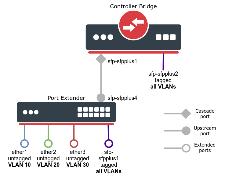

In this example, a CRS317-1G-16S+ device is used as a Controller Bridge and a CRS328-24P-4S+ as a Port Extender; see the connection scheme below.
First, configure the CB device. This can be done by adding a bridge interface with enabled VLAN filtering. Additionally, add any local interfaces to the same bridge, which allows forwarding traffic between any local interfaces and extended interfaces. In this example, an sfp-sfpplus2 interface is added.
/interface/bridge
add bridge=bridge1 interface=sfp-sfpplus2
To enable CB, specify the bridge, switch and at least one cascade port. Make sure that cascade ports are not included in the bridge or routing configurations. These ports are recommended only for CB and PE usage.
To enable PE, configure control ports and switch. Additionally, configure one or multiple interfaces that should not be extended with the excluded-ports property (e.g. for out-of-band management purposes). In this example, all switch ports will be extended.
set control-ports=sfp-sfpplus4 switch=switch1

Now the CRS317-1G-16S+ device has extended its ports using the CRS328-24P-4S+ device and packet forwarding can be done between all bridged ports.
Trunk and Access ports
In this example, untagged (access) and tagged (trunk) port configuration will be created on the Controller Bridge device. See the network diagram below.
First, configure the CB and PE devices. The configuration is identical to the previous example. Use this configuration for the CB device.
/interface/bridge
Use this configuration for the PE device.
After extended ports are successfully created and added to the bridge on the CB device, we can start configuring VLAN-related properties. First, configure access ports to their respective VLAN ID using a pvid property. Use a print command in the /interface/bridge/port menu to find out the exact interface name.
set [find interface=pe1-ether1] pvid=10
set [find interface=pe1-ether2] pvid=20
set [find interface=pe1-ether3] pvid=30
Then add bridge VLAN entries and specify tagged, untagged ports. Note that there are two tagged ports - local port named sfp-sfpplus2 and extended port named pe1-sfpplus1.
/interface/bridge/vlan
add bridge=bridge1 tagged=pe1-sfpplus1,sfp-sfpplus2 untagged=pe1-ether1 vlan-ids=10
add bridge=bridge1 tagged=pe1-sfpplus1,sfp-sfpplus2 untagged=pe1-ether2 vlan-ids=20
add bridge=bridge1 tagged=pe1-sfpplus1,sfp-sfpplus2 untagged=pe1-ether3 vlan-ids=30
At this point VLANs are configured and devices should be able to communicate through the ports. However, it is recommended to go even a step further and apply some additional filtering options. Enable port ingress-filtering on local bridge ports and use frame filtering based on the packet type with the frame-types setting.
set [find interface=pe1-ether1] frame-types=admit-only-untagged-and-priority-tagged
set [find interface=pe1-ether2] frame-types=admit-only-untagged-and-priority-tagged
set [find interface=pe1-ether3] frame-types=admit-only-untagged-and-priority-tagged
set [find interface=pe1-sfpplus1] frame-types=admit-only--tagged
set [find interface=sfp-sfpplus2] frame-types=admit-only--tagged ingress-filtering=yes

Cascading multiple Port Extenders and using bonding interface
In this example, two PE devices (CRS328-24P-4S+ and CRS326-24G-2S+) will be added to the CB (CRS317-1G-16S+). To increase throughput for upstream and cascade ports, bonding interfaces will be created. See the network diagram below.
The CB and PE configuration is similar to the first example, the main difference is the bonding interface usage. First, configure the CB device - create a bonding interface for the cascade port, create a bridge and add any needed local bridge ports, lastly, enable the CB. Use the following commands:
/interface/bonding
add mode=802.3ad name=bond1 slaves=sfp-sfpplus1,sfp-sfpplus2
/interface/bridge
add bridge=bridge1 interface=sfp-sfpplus3
set bridge=bridge1 cascade-ports=bond1 switch=switch1
Then configure the Port Extender 1 device. This device needs two bonding interfaces - the first one will be used as an upstream port and the second one will be a cascade port for the Port Extender 2 device. Additionally, configure one or multiple interfaces that should not be extended with the excluded-ports property (e.g. for out-of-band management purposes). In this example, all switch ports will be extended.
/interface/bonding
add mode=802.3ad name=bond2 slaves=sfp-sfpplus3,sfp-sfpplus4
set control-ports=bond1,bond2 switch=switch1
Last, configure the Port Extender 2 device - create a bonding interface and enable PE. Additionally, configure one or multiple excluded-ports if necessary. In this example, all switch ports will be extended.
/interface/bonding
set control-ports=bond1 switch=switch1
Now the CRS317-1G-16S+ device has extended its ports with additional 48 Gigabit Ethernet ports and packet forwarding can be achieved between all bridged ports.
Use the monitor command in the device menu to see the PE device connection path. Also, use the print command in the port menu to see which PE interfaces are used as upstream and cascade ports.
[admin@Controller_Bridge] > /interface/bridge/port-controller/device/monitor [find]
status: active active
connected-via-ports: bond1==pe1-cntrl-bond1 bond1==pe1-cntrl-bond1
pe1-cntrl-bond2==pe2-cntrl-bond1
connected-via-devs: controller controller
pe1
[admin@Controller_Bridge] > /interface/bridge/port-controller/port/print where running or upstream-
Flags: I - inactive, X - disabled, R - running, U - upstream-, C - cascade-
# NAME DEVICE
0 R pe1-ether2 pe1
1 R pe1-ether3 pe1
2 R pe1-ether4 pe1
3 U pe1-sfpplus1 pe1
4 U pe1-sfpplus2 pe1
5 RC pe1-sfpplus3 pe1
6 RC pe1-sfpplus4 pe1
7 R pe2-ether1 pe2
8 R pe2-ether2 pe2
9 R pe2-ether3 pe2
10 R pe2-ether4 pe2
11 U pe2-sfpplus1 pe2
12 U pe2-sfpplus2 pe2
