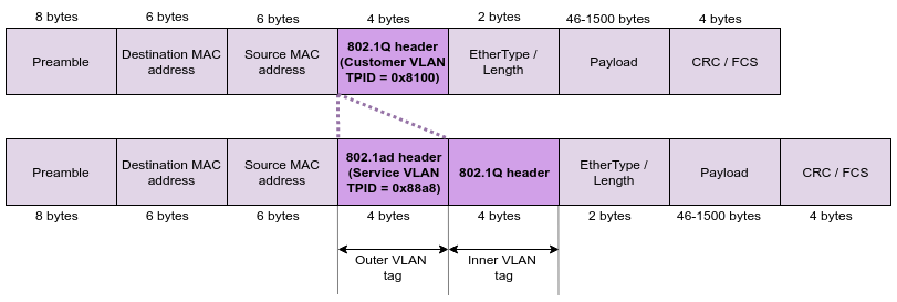

Service VLAN 802.1adA packet example before and after 802.1ad VLAN encapsulation
warning
All principles that apply to the regular trunk/access port setup using IEEE 802.1Q also apply to VLAN tunneling setups. Make sure you are limiting VLANs and packet type properly using the bridge VLAN table and ingress filtering.
