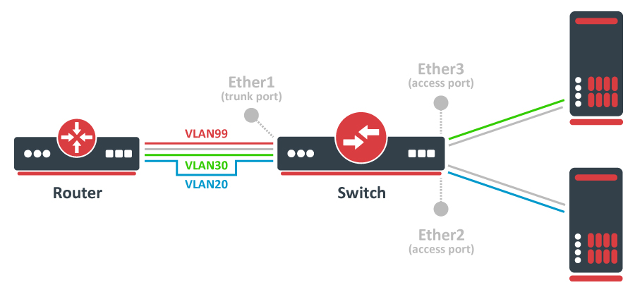

Many MikroTik devices come with built-in switch chips that support hardware-level VLAN switching. This enables wire-speed performance when using VLANs, provided the appropriate configuration method is employed. Since the configuration method varies across different models, this guide focuses on setting up a basic trunk/access port with a management port from the trunk port using different devices with the right configuration to achieve the best performance and to fully utilize the available hardware components.

/interface/bridge
add name=bridge1 frame-types=admit-only--tagged
/interface/bridge/port
add bridge=bridge1 interface=ether1 frame-types=admit-only--tagged
add bridge=bridge1 interface=ether2 pvid=20 frame-types=admit-only-untagged-and-priority-tagged
add bridge=bridge1 interface=ether3 pvid=30 frame-types=admit-only-untagged-and-priority-tagged
/interface/bridge/vlan
add bridge=bridge1 tagged=ether1 vlan-ids=20
add bridge=bridge1 tagged=ether1 vlan-ids=30
add bridge=bridge1 tagged=ether1,bridge1 vlan-ids=99
/interface/vlan
add interface=bridge1 vlan-id=99 name=MGMT
/ip/address
add address=192.168.99.1/24 interface=MGMT
/interface/bridge
set bridge1 vlan-filtering=yes
