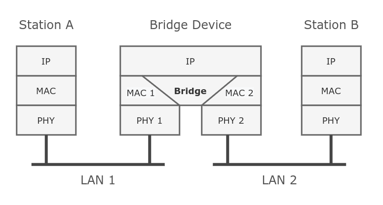

Bridge diagram
Ethernet-like networks (Ethernet, Ethernet over IP, IEEE 802.11 in ap-bridge or bridge mode, WDS, VLAN) can be connected together using MAC bridges. The bridge feature allows the interconnection of hosts connected to separate LANs (using EoIP, geographically distributed networks can be bridged as well if any kind of IP network interconnection exists between them) as if they were attached to a single LAN. As bridges are transparent, they do not appear in the traceroute list, and no utility can make a distinction between a host working in one LAN and a host working in another LAN if these LANs are bridged. However, depending on the way the LANs are interconnected, latency and data rate between hosts may vary.
Network loops may emerge (intentionally or not) in complex topologies. Without any special treatment, loops would prevent the network from functioning normally, as they would lead to avalanche-like packet multiplication. Each bridge runs an algorithm that calculates how the loop can be prevented. (R/M)STP allows bridges to communicate with each other, so they can negotiate a loop-free topology. All other alternative connections that would otherwise form loop are put on standby, so that should the main connection fail, another connection could take its place. This algorithm exchanges configuration messages (BPDUs - Bridge Protocol Data Unit) periodically, so that all bridges are updated with the newest information about changes in the network topology. (R/M)STP selects a root bridge, which is responsible for network reconfiguration, such as blocking and opening ports on other bridges. The root bridge is the bridge with the lowest bridge ID.

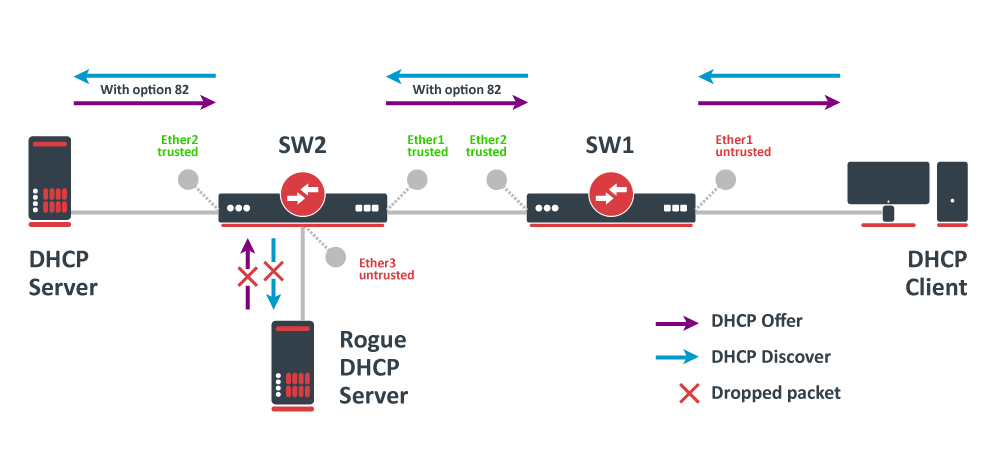

add-dhcp-option82 (yes | no; Default: no)Important: Starting from RouterOS version 7.23, this setting has been removed. Custom Remote ID and Circuit ID values can now be configured using predefined variables (such as BRIDGEMAC, HOSTNAME, INTERFACE, VID). See the dhcp-agent-circuit-id and dhcp-agent-remote-id properties below for details. If this setting was enabled in earlier versions (7.22 or earlier), upgrading will automatically update the configuration to the new format.
Whether to add DHCP Option 82 information (Agent Remote ID and Agent Circuit ID) to DHCP packets. Can be used together with an Option 82 capable DHCP server to assign IP addresses and implement policies. This property only has an effect when dhcp-snooping is set to yes.
In RouterOS versions 7.22 or earlier, the values are predefined and cannot be modified:
  • For Agent Remote ID, RouterOS uses the bridge interface MAC address, formatted as "xx:xx:xx:xx:xx:xx" (lowercase, colon-separated).
  • For Agent Circuit ID, RouterOS uses the interface name and VLAN ID separated by a colon (interface:vlan-id) where the DHCP client is connected. The VLAN ID is included only if vlan-filtering is enabled on the bridge.
For example (vlan-filtering=yes):
Agent Remote ID - cc:2d:e0:01:6a:43 Agent Circuit ID - ether2:10

dhcp-snooping (yes | no; Default: no)Enables or disables DHCP Snooping on the bridge.
Caution: Enabling the DHCP snooping feature will turn off bridge fast-path, which in turn affects the ability to fasttrack connections going over that bridge.

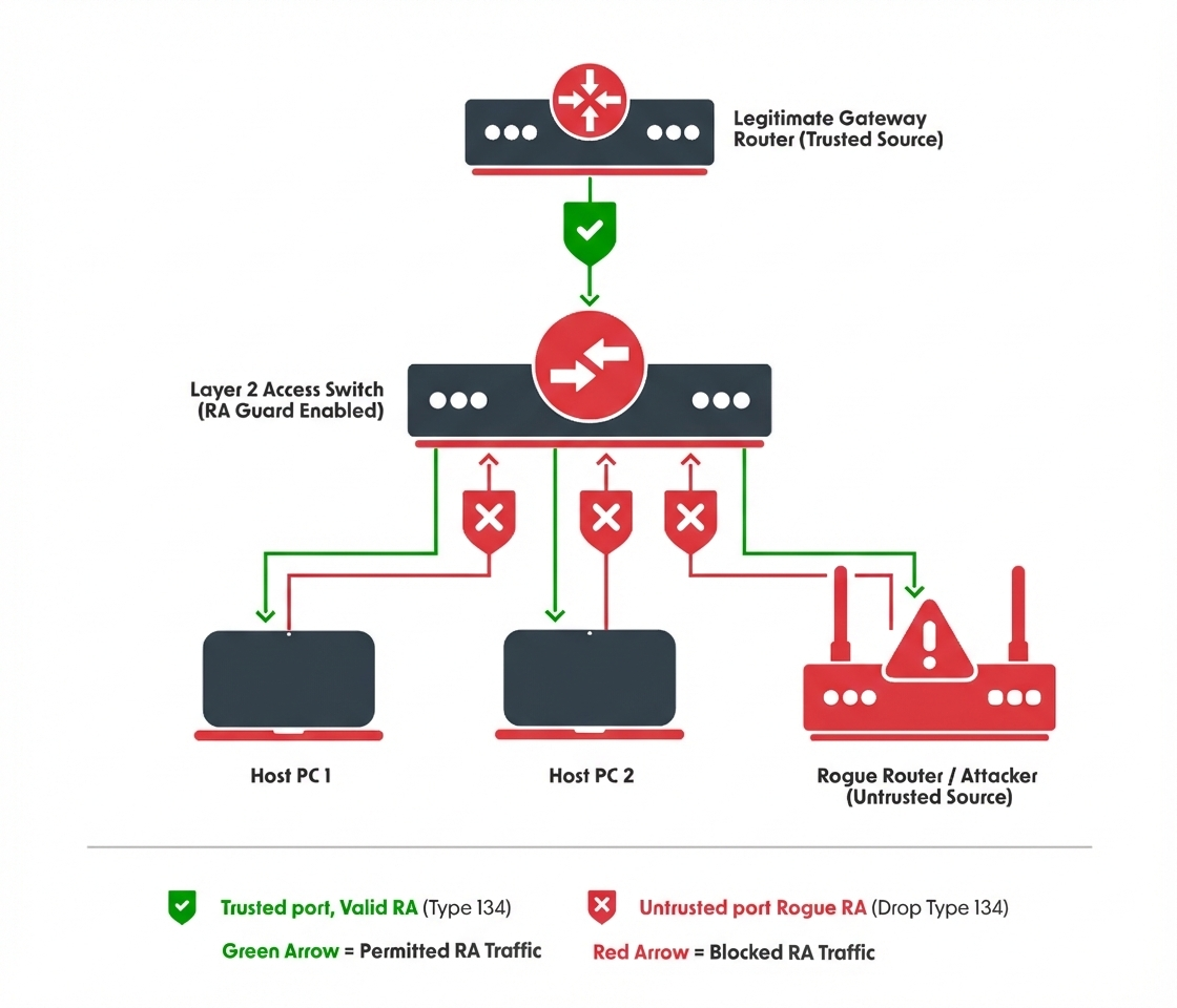

ra-guard (yes | no; Default: no)RA guard - a security feature that validates incoming Router Advertisements against a list of authorized, trusted ports.

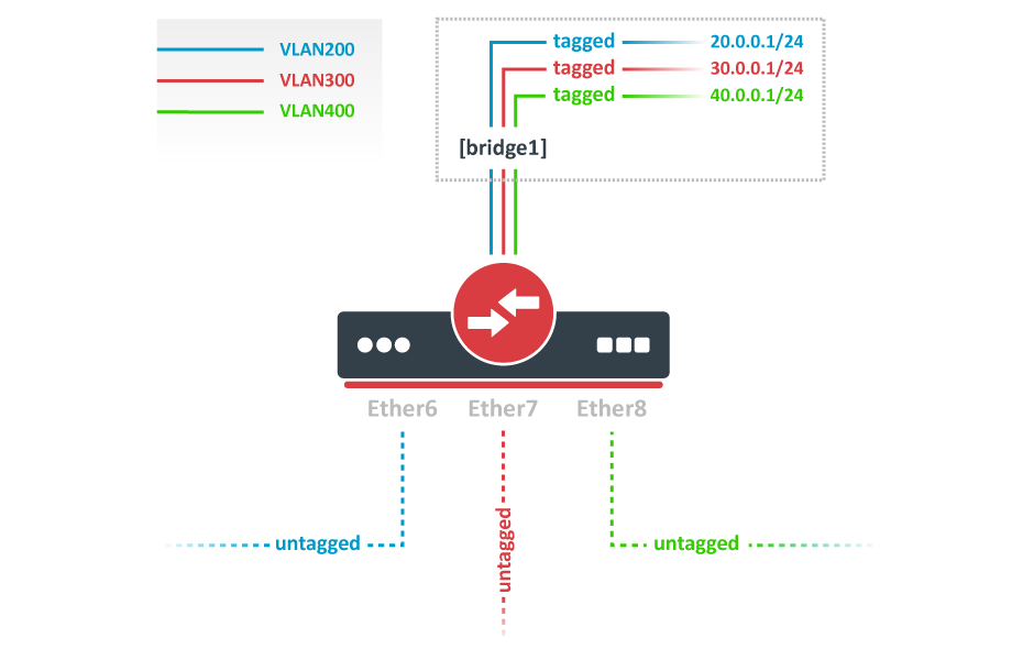

vlan-filtering (yes | no; Default: no)Globally enables or disables VLAN functionality for the bridge.

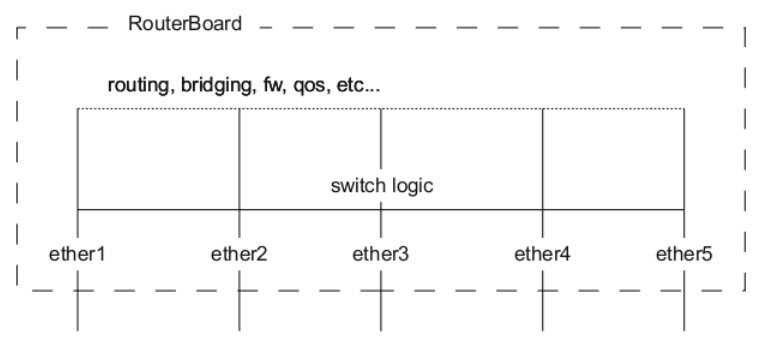

Bridge Hardware Offloading
It is possible to switch multiple ports together if a device has a built-in switch chip. While a bridge is a software feature that will consume CPU's resources, the bridge hardware offloading feature will allow you to use the built-in switch chip to forward packets. This allows you to achieve higher throughput if configured correctly.
In previous versions (prior to RouterOS v6.41) you had to use the master-port property to switch multiple ports together, but in RouterOS v6.41 this property is replaced with the bridge hardware offloading feature, which allows you to switch ports and use some of the bridge features, for example, Spanning Tree Protocol.
warning
When upgrading from previous versions (before RouterOS v6.41), the old master-port configuration is automatically converted to the new Bridge Hardware Offloading configuration. When downgrading from newer versions (RouterOS v6.41 and newer) to older versions (before RouterOS v6.41), the configuration is not converted back, a bridge without hardware offloading will exist instead, in such a case you need to reconfigure your device to use the old master-port configuration.
Below is a list of devices and features that support hardware offloading (+) or disable hardware offloading (-):
RouterBoard/[Switch Chip] ModelFeatures in Switch menuSTP/RSTPMSTPVLAN FilteringIGMP SnoopingDHCP SnoopingDHCPv6 SnoopingRA GuardBonding 1, 2MLAGHorizon 1
MikroTik devices with Marvell Prestera switch+++++++++ 3+-
[88E6393X, 88E6191X, 88E6190]++++ 6+ 5+ 5--+ 4--
[MT7621, MT7531, EN7523]++++ 6-------
[RTL8367]++++ 6-------
CRS1xx/CRS2xx series++--+ 7+ 8-----
[QCA8337]++---+ 7-----
[Atheros8327]++---+ 7-----
[Atheros8316]++---+ 7-----
[Atheros8227]++---------
[Atheros7240]++---------
[IPQ-PPE]+ 9----------
[ICPlus175D]+----------
Footnotes:
  1. The HW offloading will be disabled only for the specific bridge port, not the entire bridge.
  2. Only 802.3ad (LACP), balance-xor (static LAG) and active-backup bonding modes are hardware offloaded. Other bonding modes do not support HW offloading.
  3. MikroTik devices with Marvell Prestera switch will always use Layer2+Layer3+Layer4 for a transmit hash policy. Changing the transmit hash policy manually while HW offloading is used will have no effect.
  4. The 88E6393X, 88E6191X, 88E6190 switch chips are limited to Layer2 transmit hash. Changing the transmit hash policy manually while HW offloading is used will have no effect.
  5. The 88E6393X, 88E6191X, 88E6190 switch chips do not support QinQ configurations. They are limited to parsing only the first VLAN tag, any feature that requires reading data after the VLAN tag, such as dhcp-snooping or igmp-snooping, will not function properly in QinQ setups. As a result, double-tagged DHCP or IGMP packets may be forwarded to incorrect switch ports and may lead to inaccurate MDB entries, causing multicast traffic to be flooded incorrectly.
  6. The switch does not support ether-type 0x88a8 or 0x9100 (only 0x8100 is supported) and has no tag-stacking support. Using these features will disable HW offload.
  7. The feature will not work properly in VLAN switching setups.
  8. The feature will not work properly in VLAN switching setups. It is possible to correctly snoop DHCP packets only for a single VLAN, but this requires that these DHCP messages get tagged with the correct VLAN tag using an ACL rule, for example, /interface/ethernet/switch/acl/add dst-l3-port=67-68 ip-protocol=udp mac-protocol=ip new-customer-vid=10 src-ports=switch1-cpu. DHCP Option 82 will not contain any information regarding VLAN-ID.
  9. Currently, HW offloaded bridge support for the IPQ-PPE switch chip is still a work in progress. We recommend using the default non-HW offloaded bridge (enabled RSTP).
warning
When upgrading from older versions (before RouterOS v6.41), only the master-port configuration is converted. For each master-port a bridge will be created. VLAN configuration is not converted and should not be changed. Check the Basic VLAN switching guide to be sure how VLAN switching should be configured for your device.
Bridge Hardware Offloading should be considered as port switching, but with more possible features. By enabling hardware offloading you are allowing a built-in switch chip to process packets using its switching logic. The diagram below illustrates that switching occurs before any software related action.
HWoffloading_diagram
A packet that is received by one of the ports always passes through the switch logic first. Switch logic decides which ports the packet should be going to (most commonly this decision is made based on the destination MAC address of a packet, but there might be other criteria that might be involved based on the packet and the configuration). In most cases the packet will not be visible to RouterOS (only statistics will show that a packet has passed through). This is because the packet was already processed by the switch chip and never reached the CPU.
Though it is possible in certain situations to allow a packet to be processed by the CPU, this is usually called packet forwarding to the switch CPU port (or the bridge interface in bridge VLAN filtering scenario). This allows the CPU to process the packet and lets the CPU forward the packet. Passing the packet to the CPU port will give you the opportunity to route packets to different networks, perform traffic control and other software-related packet processing actions. To allow a packet to be processed by the CPU, you need to make certain configuration changes depending on your needs and on the device you are using (most commonly passing packets to the CPU is required for VLAN filtering setups). Check the manual page for your specific device:
danger
Certain bridge and Ethernet port properties are directly related to switch chip settings. Changing such properties can trigger a switch chip reset, temporarily disabling all Ethernet ports that are on the switch chip for the settings to take effect. This must be taken into account whenever changing properties in production environments. Such properties include DHCP Snooping, IGMP Snooping, VLAN filtering, L2MTU, Flow Control, and others. The exact settings that can trigger a switch chip reset depend on the device's model.
warning
The CRS1xx/2xx series switches support multiple hardware offloaded bridges per switch chip. All other devices support only one hardware offloaded bridge per switch chip. Use the hw=yes/no parameter to select which bridge will use hardware offloading.

[admin@MikroTik] /interface/bridge/port/print
Flags: X - disabled, I - inactive, D - dynamic, H - hw-offload
# INTERFACE BRIDGE HW PVID PRIORITY PATH-COST INTERNAL-PATH-COST HORIZON
0 H ether2 bridge1 yes 1 0x80 10 10 none
1 H ether3 bridge1 yes 1 0x80 10 10 none
2 H ether4 bridge1 yes 1 0x80 10 10 none
3 H ether5 bridge1 yes 1 0x80 10 10 none

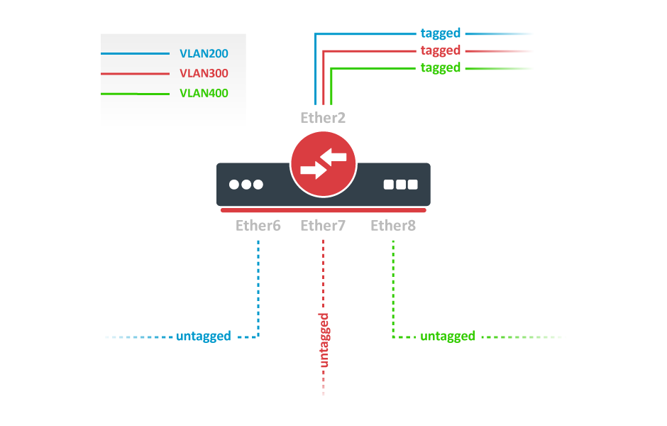

VLAN Example: Trunk and Access Ports
This section demonstrates how to configure a basic VLAN setup with one trunk port and multiple access ports. The trunk port (ether2) carries tagged VLAN traffic between switches or to a router, while access ports (ether6, ether7, ether8) connect to end devices and use untagged VLAN traffic.
access_ports
Step 1: Create the Bridge Interface
Create a bridge interface with vlan-filtering disabled. This is important because enabling VLAN filtering immediately restricts traffic, which could lock you out of the device before the configuration is complete. For detailed information on managing access to the device during VLAN configuration, refer to the Management access configuration section.
/interface/bridge
add name=bridge1 vlan-filtering=no
Step 2: Add Bridge Ports and Configure PVID
Add the physical interfaces to the bridge and configure the Port VLAN ID (pvid) for access ports. The pvid determines which VLAN untagged traffic is assigned to when entering the bridge. The frame-types setting controls what kind of traffic each port accepts: tagged only, untagged only, or both.
add bridge=bridge1 interface=ether2 frame-types=admit-only-vlan-tagged
add bridge=bridge1 interface=ether6 pvid=200 frame-types=admit-only-untagged-and-priority-tagged
add bridge=bridge1 interface=ether7 pvid=300 frame-types=admit-only-untagged-and-priority-tagged
add bridge=bridge1 interface=ether8 pvid=400 frame-types=admit-only-untagged-and-priority-tagged
Step 3: Create Bridge VLAN Table Entries
Create the bridge VLAN table entries. The trunk port (ether2) must be configured as a tagged member, meaning it will send and receive frames with VLAN tags. Access ports are automatically added as untagged members based on their pvid setting, so you only need to specify the tagged port in each VLAN entry.
/interface/bridge/vlan
add bridge=bridge1 tagged=ether2 vlan-ids=200
add bridge=bridge1 tagged=ether2 vlan-ids=300
add bridge=bridge1 tagged=ether2 vlan-ids=400
Step 4: Enable VLAN Filtering
Once all VLAN settings are configured, enable VLAN filtering on the bridge to activate the VLAN functionality.
/interface/bridge/set bridge1 vlan-filtering=yes
Step 5: (Optional) Reject Untagged Traffic
As an optional security measure, you can set the bridge to reject untagged traffic by changing the frame-type. This prevents the default VLAN 1 (pvid=1) from being used and ensures only properly tagged traffic is accepted.
/interface/bridge/set bridge1 frame-types=admit-only-vlan-tagged

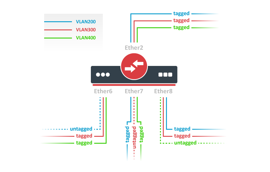

VLAN Example - Trunk and Hybrid Ports
hybrid_ports
Create a bridge with disabled vlan-filtering to avoid losing access to the router before VLANs are completely configured. If you need management access to the bridge, see the Management access configuration section.
/interface/bridge
Add bridge ports and specify pvid on hybrid VLAN ports to assign untagged traffic to the intended VLAN. Use the frame-types setting to accept only tagged packets on ether2.
Add Bridge VLAN entries and specify tagged ports in them. In this example, egress VLAN tagging is done on ether6, ether7, ether8 ports too, making them into hybrid ports. Bridge ports with frame-types set to admit-all will be automatically added as untagged ports for the pvid VLAN.
add bridge=bridge1 tagged=ether2,ether7,ether8 vlan-ids=200
add bridge=bridge1 tagged=ether2,ether6,ether8 vlan-ids=300
add bridge=bridge1 tagged=ether2,ether6,ether7 vlan-ids=400
In the end, when VLAN configuration is complete, enable Bridge VLAN Filtering.
An Optional step is to set frame-types=admit-only-vlan-tagged on the bridge interface in order to disable the default untagged VLAN 1 (pvid=1).

VLAN Example - InterVLAN Routing by Bridge
vlan_routing
/interface/bridge
Add bridge ports and specify pvid for VLAN access ports to assign their untagged traffic to the intended VLAN. Use the frame-types setting to accept only untagged packets.
Add Bridge VLAN entries and specify tagged ports in them. In this example bridge1 interface is the VLAN trunk that will send traffic further to do InterVLAN routing. Bridge ports with frame-types set to admit-only-untagged-and-priority-tagged will be automatically added as untagged ports for the pvid VLAN.
add bridge=bridge1 tagged=bridge1 vlan-ids=200
add bridge=bridge1 tagged=bridge1 vlan-ids=300
add bridge=bridge1 tagged=bridge1 vlan-ids=400
Configure VLAN interfaces on the bridge1 to allow handling of tagged VLAN traffic at the routing level and set IP addresses to ensure routing between VLANs as planned.
/interface/vlan
add interface=bridge1 name=VLAN200 vlan-id=200
add interface=bridge1 name=VLAN300 vlan-id=300
add interface=bridge1 name=VLAN400 vlan-id=400
/ip/address
add address=20.0.0.1/24 interface=VLAN200
add address=30.0.0.1/24 interface=VLAN300
add address=40.0.0.1/24 interface=VLAN400
In the end, when VLAN configuration is complete, enable Bridge VLAN Filtering:
An optional step is to set frame-types=admit-only-vlan-tagged on the bridge interface in order to disable the default untagged VLAN 1 (pvid=1).

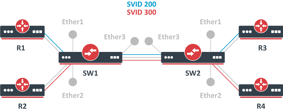

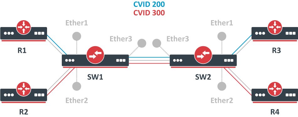

VLAN Tunneling (QinQ)
Since RouterOS v6.43 the RouterOS bridge is IEEE 802.1ad compliant and it is possible to filter VLAN IDs based on Service VLAN ID (0x88a8) rather than Customer VLAN ID (0x8100). The same principles can be applied as with IEEE 802.1Q VLAN filtering (the same setup examples can be used). Below is a topology for a common Provider bridge:
Provider_bridge
In this example, R1, R2, R3, and R4 might be sending any VLAN tagged traffic by 802.1Q (CVID), but SW1 and SW2 need to isolate traffic between routers in a way that R1 is able to communicate only with R3, and R2 is only able to communicate with R4. To do so, you can tag all ingress traffic with an SVID and only allow these VLANs on certain ports. Start by enabling the service tag 0x88a8, introduced by 802.1ad, on the bridge. Use these commands on SW1 and SW2:
/interface/bridge
add name=bridge1 vlan-filtering=no ether-type=0x88a8
In this setup, ether1 and ether2 are going to be access ports (untagged), use the pvid parameter to tag all ingress traffic on each port, use these commands on SW1 and SW2:
add interface=ether1 bridge=bridge1 pvid=200
add interface=ether2 bridge=bridge1 pvid=300
add interface=ether3 bridge=bridge1
Specify tagged and untagged ports in the bridge VLAN table. Use these commands on SW1 and SW2:
add bridge=bridge1 tagged=ether3 untagged=ether1 vlan-ids=200
add bridge=bridge1 tagged=ether3 untagged=ether2 vlan-ids=300
When the bridge VLAN table is configured, you can enable bridge VLAN filtering. Use these commands on SW1 and SW2:

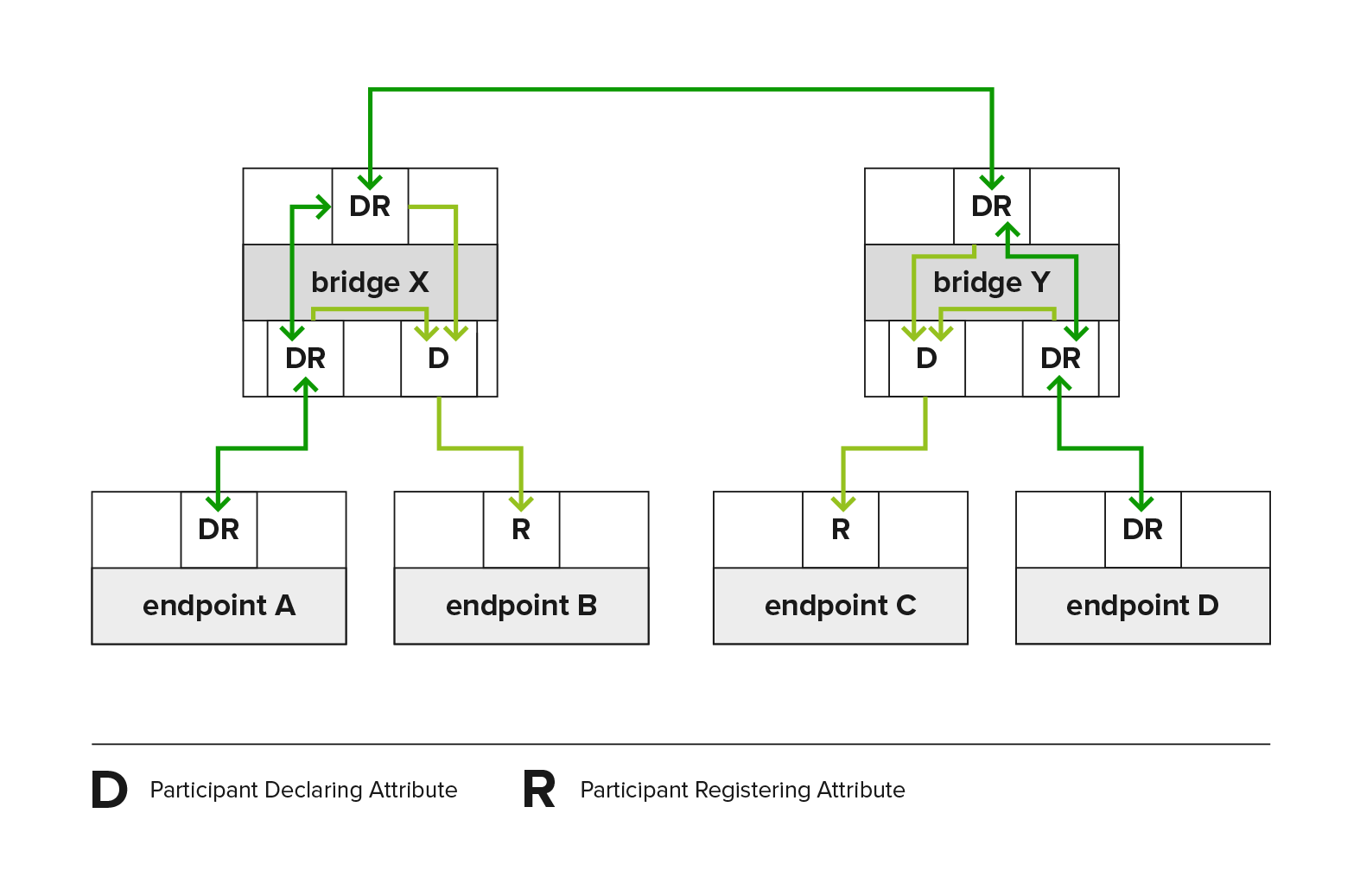

MVRP
Multiple VLAN Registration Protocol (MVRP) is a protocol based on Multiple Registration Protocol (MRP) which allows registering attributes (VLAN IDs in the case of MVRP) with other members of a Bridged LAN.
An MRP application can make or withdraw declarations of attributes which result in registration or leaving of those attributes with other MRP participants.
Here's how it works.
MRP consists of two parts:
  • Applicant - responsible for sending declarations (or leaves). Its behavior can be configured on a per-port basis using the setting called mvrp-applicant-state, and per-VLAN using the mvrp-forbidden setting.
  • Registrar - responsible for registering incoming declarations. Its configuration can be set per-port using the mvrp-registrar-state setting, and per-VLAN using the mvrp-forbidden setting.
Registration Propagation: Incoming registration on a bridge port dynamically makes that specific port a tagged VLAN member. Additionally, the attributes associated with this registration are spread to all active (forwarding) bridge ports as a declaration.
Declaration Operation: In case of MVRP, the configured VLANs get declared on each port, but they will only get configured as members of those VLANs when a declaration is received from the LAN (Registrar will register the VLAN). From the perspective of an end-station, a single declaration will be registered on each upstream port across the entire LAN. When another end-station declares the same attribute, a path of registrations will be made between the two (or more) end stations, see the picture below.
MVRP helps to dynamically propagate VLAN information throughout the bridged network and configure VLANs only on the needed ports. This makes the network efficient by avoiding unnecessary traffic flooding.
As noted before, MVRP is only active on ports that are forwarding. In the case of MSTP, declarations and registrations are made only if the port is forwarding in the MSTI in which the VLAN is mapped.
The point-to-point ports speed up the process of registration (or leaving). Manually configuring point-to-point=yes can be advantageous for non-Ethernet interfaces.

DHCP Snooping and DHCP Option 82
DHCP Snooping and DHCP Option 82 are supported by bridge. The DHCP Snooping is a Layer2 security feature that prevents unauthorized DHCP servers from providing malicious information to users. In RouterOS, you can specify which bridge ports are trusted (where a known DHCP server resides and DHCP messages should be forwarded) and which are untrusted (usually used for access ports, received DHCP server messages will be dropped). The DHCP Option 82 is additional information (Agent Circuit ID and Agent Remote ID) provided by DHCP Snooping enabled devices that allows identifying the device itself and DHCP clients.
Dhcp_snooping
In this example, SW1 and SW2 are DHCP Snooping and Option 82-enabled devices. First, we need to create a bridge, assign interfaces and mark trusted ports. Use these commands on SW1:
/interface/bridge
add name=bridge
add bridge=bridge interface=ether1
add bridge=bridge interface=ether2 trusted=yes
For SW2, the configuration will be similar, but we also need to mark ether1 as trusted, because this interface is going to receive DHCP messages with Option 82 already added. You need to mark all ports as trusted if they are going to receive DHCP messages with added Option 82, otherwise these messages will be dropped. Also, we add ether3 to the same bridge and leave this port untrusted, imagining there is an unauthorized (rogue) DHCP server. Use these commands on SW2:
/interface/bridge
add name=bridge
add bridge=bridge interface=ether1 trusted=yes
add bridge=bridge interface=ether3
Then we need to enable DHCP Snooping and configure Option 82. Starting from RouterOS version 7.23, it is possible to configure custom Remote ID and Circuit ID values using predefined variables (such as BRIDGEMAC, HOSTNAME, INTERFACE, VID). See the dhcp-agent-circuit-id, dhcp-agent-remote-id properties for more details. In case your DHCP server does not support DHCP Option 82 or you do not implement any Option 82-related policies, this step is not mandatory. In this configuration example, we are using these commands on SW1 and SW2:
/interface/bridge
set [find where name="bridge"] dhcp-snooping=yes dhcp-agent-circuit-id="interface: \$(INTERFACE), vlan: \$(VID)" dhcp-agent-remote-id="ip: 192.168.88.1, identity: \$(HOSTNAME), mac: \$(BRIDGEMAC)"
Now both devices will analyze what DHCP messages are received on bridge ports. The SW1 is responsible for adding and removing the DHCP Option 82. The SW2 will limit rogue DHCP servers from receiving any discovery messages and drop malicious DHCP server messages from ether3.
warning
Currently, MikroTik devices with Marvell Prestera switch and 88E6393X, 88E6191X, 88E6190 switch chips fully support hardware offloaded DHCP Snooping and Option 82. For CRS1xx and CRS2xx series switches, it is possible to use DHCP Snooping along with VLAN switching, but then you need to make sure that DHCP packets are sent out with the correct VLAN tag using egress ACL rules. Other devices are capable of using DHCP Snooping and Option 82 features along with hardware offloading, but you must make sure that there is no VLAN-related configuration applied to the device, otherwise, DHCP Snooping and Option 82 might not work properly. See the Bridge Hardware Offloading section with supported features.
info
Starting from RouterOS v7.17, DHCP snooping is supported with hardware offloading on bonding interfaces.

RA Guard
The RA guard feature is intended for discarding IPv6 packets containing router advertisement (RA) messages arriving on bridge ports specified by the user as untrusted ones, thereby allowing one to prevent potential rogue RA message-based attacks or accidental network misconfiguration. When enabled, it is possible to set each bridge port either as trusted or untrusted (by default all the bridge ports are set as RA untrusted).
Here are the network scheme and core principle behind IPv6 RA Guard (Router Advertisement Guard).
RAguard
<br/>#Layer 2 Access Switch - enabling RA guard on the main bridge<br/>/interface/bridge <br/>add name=bridge<br/>/interface/bridge<br/>set [find where name="bridge"] ra-guard=yes<br/><br/>/interface/bridge/port<br/>add bridge=bridge interface=etherUplink Trusted RA=yes <br/>add bridge=bridge interface=etherX<br/>add bridge=bridge interface=etherY<br/>add bridge=bridge interface=etherZ<br/>
The Problem: Why is this needed?
In IPv6, devices use ICMPv6 to auto-configure themselves.
Router Advertisements (Type 134): Routers broadcast these messages to tell hosts: "I am the gateway, and here is your network prefix."
The Threat: If a user accidentally connects a consumer router (like a home Wi-Fi router) or a malicious actor launches a tool (like Rogue RA) on an access port, that device will start broadcasting RAs.
The Result: Other hosts on the network will auto-configure their IPv6 addresses based on the rogue device and set the rogue device as their default gateway. This causes a Man-in-the-Middle attack or a complete denial of service.
Here is the network scheme and the core principle behind IPv6 RA Guard (Router Advertisement Guard).
The Core Principle: "Trust vs. Untrust"
The fundamental principle of IPv6 RA Guard is logically identical to DHCP Snooping in IPv4. It creates a security boundary within the Layer 2 switch infrastructure by categorizing switch ports into two roles:
  • Trusted Ports: Ports connected to legitimate, authorized IPv6 routers. These ports are allowed to send Router Advertisement (RA) packets.
  • Untrusted Ports: Ports connected to end-user hosts. These ports are blocked from sending RA packets.
Packet parsing process
For ports not configured as RA Trusted, the RA Guard parser traverses the extension header chain until it encounters a non-extension header. The parsing process and subsequent actions are governed by the following rules:
Transport Layer Termination: If the parser encounters a valid transport layer header—such as TCP, UDP, ESP, RSVP, or an encapsulated IPv4/IPv6 header—parsing terminates and the packet is forwarded (subject to standard bridge checks).
  • Drop Conditions - The packet is discarded if:
  1. It fails to contain a transport layer header.
  2. The final extension header in the chain does not specify NO_NEXT_HEADER (59) in its "Next Header" field.
  3. If the ICMP message type is found to be 134, the packet is dropped.
  • Fragmentation Handling: These parsing rules apply exclusively to the first fragment of fragmented IPv6 packets. Subsequent fragments are forwarded regardless of their content, as they do not contain the protocol headers necessary for RA identification.
