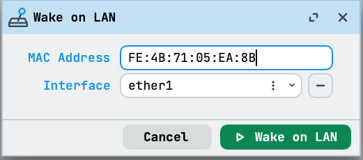

Send a wake packet in WinBox​
Open Tools > WoL:
  1. Enter the target device's MAC Address. The screenshot uses the address from the command example.
  2. In Interface, select the interface through which the computer is reachable, for example bridge in the default configuration. The screenshot shows ether1.
WinBox Wake on LAN dialog with target MAC Address and outgoing Interface
Select Wake on LAN to send the packet, or Cancel to close the dialog without sending it. The target device must have Wake on LAN enabled in its own hardware and operating system.
