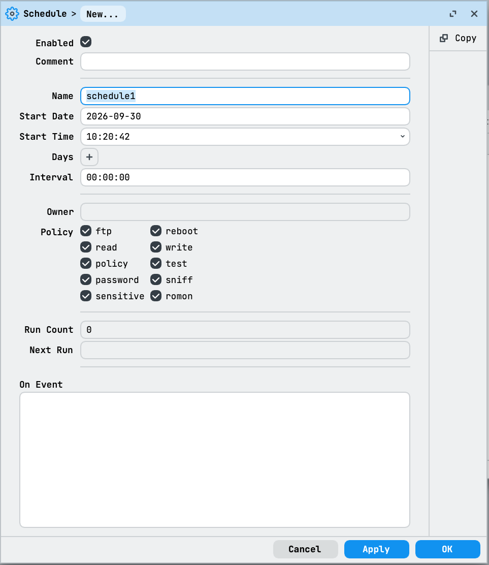

After you create the nightly-backup script, configure its schedule in WinBox under System > Scheduler > New:
  1. Set Name to nightly-backup, choose the Start Date, set Start Time to 03:00:00, and set Interval to 1d for a daily run. Leave Days unset to allow every day.
  2. Review Policy and select the permissions the task requires. The screenshot shows the new-entry defaults; use the Permissions section to choose the appropriate permissions for your script.
  3. Enter nightly-backup in On Event, leave Enabled selected, and select OK. On Event can also hold commands directly.
WinBox new Scheduler entry with schedule fields, Policy permissions, and On Event commands
After saving, check Next Run in the Scheduler list and use Run Count to see whether the entry has run. The screenshot shows a new entry before the example values are entered.
When start-date is not given, the entry starts on the day it is added. next-run shows when it runs next, and run-count counts the runs since the last startup:
