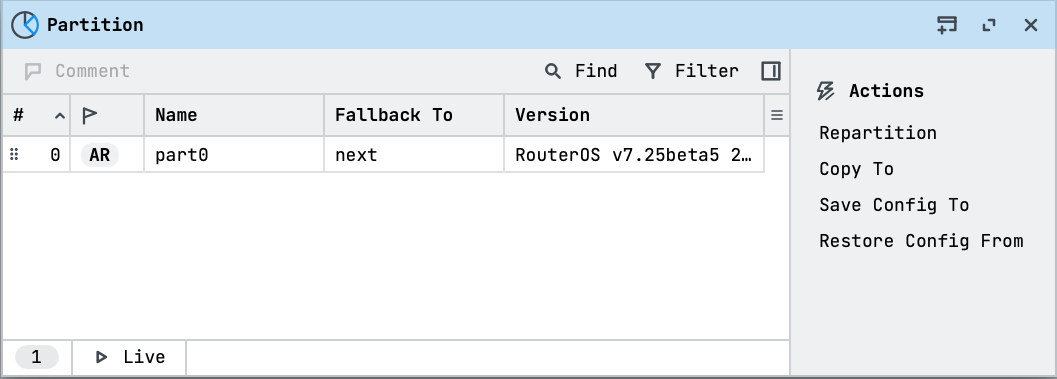

Inspect partitions in WinBox​
Open Partition in the left menu:
  1. Check the partition name, Fallback To, and installed RouterOS version in the list. The A flag identifies the active boot partition, and R identifies the running partition. The screenshot shows one partition, part0, with both flags.
  2. The right panel contains Repartition, Copy To, Save Config To, and Restore Config From. These actions change storage or configuration; use the command descriptions to select the operation you intend to perform.
WinBox Partition overview with partition details and available actions
Viewing the list does not repartition the router. Repartition reformats storage and reboots the device, and Copy To replaces the contents of its destination. Check hardware support and device mode before planning a partition change.
