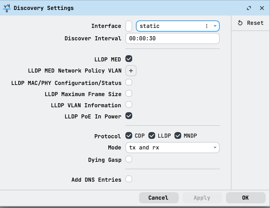

Open IP > Neighbors to see discovered devices and the interfaces through which they were found. Select the LLDP tab for LLDP-only entries. To configure discovery, select Discovery Settings in the right panel:
  1. Select the interface list in Interface. This corresponds to discover-interface-list; choose a list containing the interfaces that should participate in discovery.
  2. Select the required Protocol checkboxes and review Mode, which controls whether discovery transmits, receives, or does both. Select OK to save the settings.
WinBox Discovery Settings dialog with interface list, protocol, and mode controls
The screenshot shows an existing configuration. Choose the interface list for your network rather than copying its selection.
