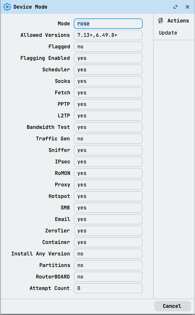

Check device mode in WinBox
Open System > Device Mode to inspect the restrictions:
- Mode and Allowed Versions identify the configured mode and permitted RouterOS versions.
- The per-tool fields show which operations are allowed. For example, check Scheduler, Fetch, or Email when one of those tools reports a device-mode restriction.
The screenshot shows this router's existing rose configuration; it is not a factory default for every device. The overview is read-only. The Update action starts a mode-change procedure, which requires physical confirmation and reboots the device as described in the next section.
