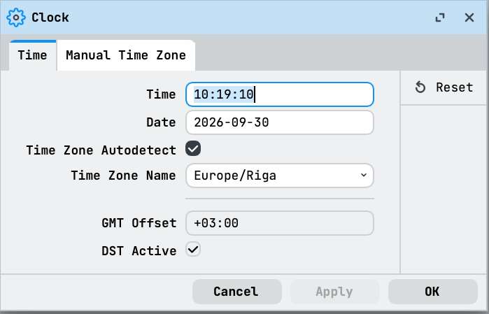

In WinBox, open System > Clock and use the Time tab:
  1. Clear Time Zone Autodetect, then choose Time Zone Name, for example Europe/Riga. Select OK to save the selection. Leave autodetection selected if you want the cloud service to choose the zone instead.
  2. Check the read-only GMT Offset and DST Active fields to see the offset and daylight saving state in effect.
WinBox Clock Time tab with time zone and clock status settings
The Time and Date fields are for manual clock changes; use the NTP client for ongoing synchronization.
