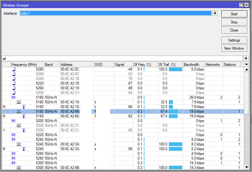

This tool monitors surrounding frequency usage, and displays which devices occupy each frequency. It's available both in console and in WinBox. Snooper will use frequencies from scan-list.
Sub-menu: /interface/wireless/snooper
Settings​
