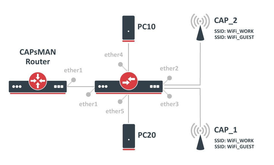

Using Local Forwarding Mode​
In Local Forwarding Mode, the CAPsMAN router is distributing the configuration across all CAPs that are being provisioned by the CAPsMAN router. In Local Forwarding Mode, traffic is not required to be sent to the CAPsMAN router, but rather it can be sent to a different router without involving the CAPsMAN router when forwarding traffic. This mode allows you to tag traffic with a certain VLAN ID before it is sent to your network from your wireless client, which adds the possibility to use a switch to limit certain VLAN IDs to certain ports. In Local Forwarding Mode, traffic is not encapsulated with a special CAPsMAN header, which can only be removed by a CAPsMAN router.

Switch​
In this example, we are going to be using Bridge VLAN Filtering to filter unknown VLANs and to assign other devices to the same networks. Some devices are capable of offloading this to the built-in switch chip, check the Basic VLAN switching guide to see how to configure it on different types of devices.

info
In this example, untagged traffic is going to be used to communicate between CAPs and CAPsMAN Router. By default, if PVID is not changed, untagged traffic is going to be forwarded between ports that have the same PVID value set (including the default PVID).
CAPs​
  • Create a bridge and assign a port to it, which is connected to the CAPsMAN Router:
/interface/bridge
add name=bridge1
/interface/bridge/port
  • Enable CAP mode on the AP, and make sure you specify to use the newly created bridge:
/interface/wireless/cap
set bridge=bridge1 discovery-interfaces=bridge1 enabled=yes interfaces=wlan1
  • After CAPs are successfully connected to the CAPsMAN Router, the wlan1 (SSID WiFi_WORK) and a newly created virtual wlan5 (SSID WiFi_GUEST) interfaces get dynamically added as bridge ports. The VLAN is assigned for a wireless interface and as a result, all data coming from wireless gets tagged and only data with this tag will be sent out over wireless. Bridge vlan-filtering can be disabled if additional VLAN managing and controlling is not needed. The associated VLAN can be seen with the port VLAN ID (PVID) property:
[admin@CAP_1] /interface/bridge/port/pr
Flags: X - disabled, I - inactive, D - dynamic, H - hw-offload
# INTERFACE BRIDGE HW PVID PRIORITY PATH-COST INTERNAL-PATH-COST HORIZON
0 H ether1 bridge1 yes 1 0x80 10 10 none
1 D wlan1 bridge1 10 0x80 10 10 none
2 D wlan5 bridge1 20 0x80 10 10 none
That is it! Connect Wireless clients to your APs and check connectivity.

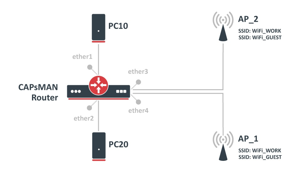

Using CAPsMAN Forwarding Mode​
In CAPsMAN Forwarding Mode all traffic that is coming from a CAP is encapsulated with a special CAPsMAN header, which can only be removed by a CAPsMAN router. This means that a switch will not be able to distinguish the VLAN ID set by the CAP since the VLAN tag is also going to be encapsulated. This mode limits the possibility to divert traffic in Layer2 networks, but gives you the possibility to forward traffic from each CAP over Layer3 networks for a distant CAPsMAN router to process the traffic. This mode is useful when you want to control multiple CAPs in remote locations, but want to use a central gateway.
CAPsMAN router​
  • Set up Bridge VLAN filtering to limit interfaces to appropriate VLANs:
/interface/bridge
add name=bridge1 vlan-filtering=yes
add bridge=bridge1 interface=ether1 pvid=10
add bridge=bridge1 interface=ether2 pvid=20
/interface/bridge/vlan
add bridge=bridge1 tagged=bridge1 untagged=ether1 vlan-ids=10
add bridge=bridge1 tagged=bridge1 untagged=ether2 vlan-ids=20
info
CAPsMAN will attach CAP interfaces to the bridge and will automatically add appropriate entries to the bridge VLAN table.

CAPs​
  • Enable CAP mode on each AP, specify which interface is connected to the CAPsMAN router:
set discovery-interfaces=ether1 enabled=yes interfaces=wlan1
  • After CAPs are successfully connected to the CAPsMAN Router, two CAP interfaces will be dynamically created on the CAPsMAN Router. Both of these interfaces will get dynamically added as bridge ports on the same CAPsMAN Router due to explicitly selecting the bridge interface with datapath.bridge=bridge1 and using the default CAPsMAN Forwarding Mode datapath.local-forwarding=no. Because of using a bridge with vlan-filtering enabled, both CAP interfaces will also show up in a bridge VLAN table:
[admin@CAPsMAN_Router] /interface/bridge/port/print
0 ether1 bridge1 yes 10 0x80 10 10 none
1 ether2 bridge1 yes 20 0x80 10 10 none
2 D cap16 bridge1 10 0x80 10 10 none
3 D cap17 bridge1 20 0x80 10 10 none
[admin@CAPsMAN_Router] /interface/bridge/vlan/print
Flags: X - disabled, D - dynamic
# BRIDGE VLAN-IDS CURRENT-TAGGED CURRENT-UNTAGGED
0 D bridge1 1 bridge1
1 bridge1 10 cap16 ether1
2 bridge1 20 cap17 ether2
