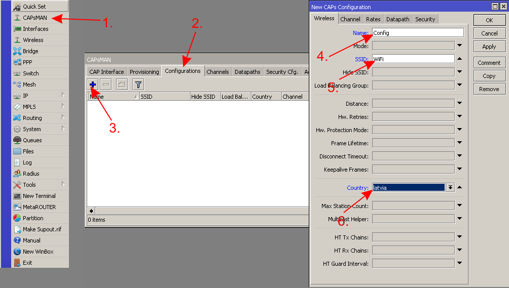

The CAPsMAN setup consists of defining configuration templates, which will then be pushed to the controllable AP devices (CAPs). Assuming your main router is already connected to the internet and works fine, you can proceed as follows.
On the central device, which will be your CAPsMAN server, create a new "Configuration" template with only the basic settings (network name, country, the local LAN bridge interface, the wireless password):
Add a new configuration profile:

Configuration profiles permit pre-defined 'top level' master settings to be applied to CAP radios being provisioned.
Configuration Profiles are configured in the /caps-man/configuration menu:

country (name of the country | no_country_set; Default: no_country_set)Limits available bands, frequencies and maximum transmit power for each frequency. Also specifies default value of scan-list. Value no_country_set is an FCC-compliant set of channels.

name (string; Default: )Descriptive name for the Configuration Profile

ssid (string (0..32 chars); Default: )SSID (service set identifier) is a name broadcast in the beacons that identifies wireless network.
